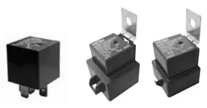

896 Song Chuan
Features
ϭMini ISO high power automotive relay 30A/50A. ϭHigh temperature endurance up to 125 degree C. ϭOptional SPNC, SPNO, SPDT, DPNO contact configurations. ϭOptional to be equipped with protection diode or resistor. ϭBoth available PCB terminal and quick connect terminal versions. ϭAvailable for plain cover type, skirted cover flanged cover, and weather proof versions. ϭTinned terminal is available on request. ϭComply with RoHS-Directive 2002/95/EC, and ELV- Directive 2000/53/EC.
Type List
Terminal
style
Contact
form
Enclosure style
Dust cover
Flux tight
Sealed type washable
Socket terminal
1A (SPNO)
896-1AH-D
896-1AH-C
896-1AH-S
896H-1AH-D
896H-1AH-C
896H-1AH-S
1C (SPDT)
896-1CH-D
896-1CH-C
896-1CH-S
896H-1CH-D
896H-1CH-C
896H-1CH-S
2A(DPNO)
896-2AH-D
896-2AH-C
896-2AH-S
896H-2AH-D
896H-2AH-C
896H-2AH-S
PCB terminal
1A (SPNO)
896P-1AH-D
896P-1AH-C
896P-1AH-S
896HP-1AH-D
896HP-1AH-C
896HP-1AH-S
1C (SPDT)
896P-1CH-D
896P-1CH-C
896P-1CH-S
896HP-1CH-D
896HP-1CH-C
896HP-1CH-S
2A(DPNO)
896P-2AH-D
896P-2AH-C
896P-2AH-S
896HP-2AH-D
896HP-2AH-C
896HP-2AH-S
