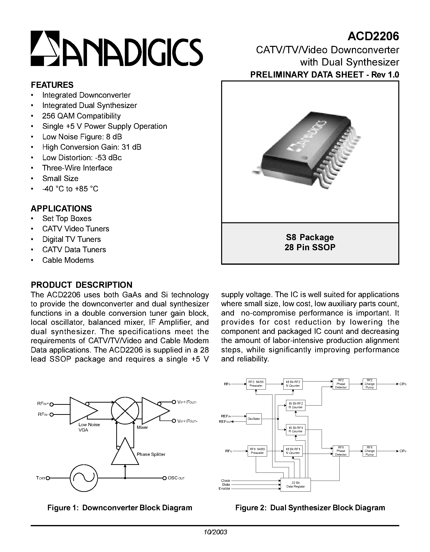

CATV/TV/Video Downconverter with Dual Synthesizer
FEATURES
В• В• В• В• В• В• В• В• В• В•
ACD2206
PRELIMINARY DATA SHEET - Rev 1.0
Integrated Downconverter Integrated Dual Synthesizer 256 QAM Compatibility Single +5 V Power Supply Operation Low Noise Figure: 8 dB High Conversion Gain: 31 dB Low Distortion: -53 dBc Three-Wire Interface Small Size -40 В°C to +85 В°C
APPLICATIONS
В• В• В• В• В•
Set Top Boxes CATV Video Tuners Digital TV Tuners CATV Data Tuners Cable Modems
S8 Package 28 Pin SSOP
PRODUCT DESCRIPTION
The ACD2206 uses both GaAs and Si technology to provide the downconverter and dual synthesizer functions in a double conversion tuner gain block, local oscillator, balanced mixer, IF Amplifier, and dual synthesizer. The specifications meet the requirements of CATV/TV/Video and Cable Modem Data applications. The ACD2206 is supplied in a 28 lead SSOP package and requires a single +5 V
supply voltage. The IC is well suited for applications where small size, low cost, low auxiliary parts count, and no-compromise performance is important. It provides for cost reduction by lowering the component and packaged IC count and decreasing the amount of labor-intensive production alignment steps, while significantly improving performance and reliability.
RFD
RF2: 64/65 Prescaler 18 Bit RF2 N Counter RF2 Phase Detector RF2 Charge Pump
CPD
RFIN+ RFINLow Noise VGA
VIF+IFOUTREFIN REFOUT
15 Bit RF2 R Counter
VIF+IFOUT+ Mixer
Oscillator 15 Bit RF1 R Counter
Phase Splitter
RFU
RF1: 64/65 Prescaler
18 Bit RF1 N Counter
RF1 Phase Detector
RF1 Charge Pump
CPU
TCKT
OSC OUT
Clock Data Enable
22 Bit Data Registar
Figure 1: Downconverter Block Diagram
10/2003
Figure 2: Dual Synthesizer Block Diagram

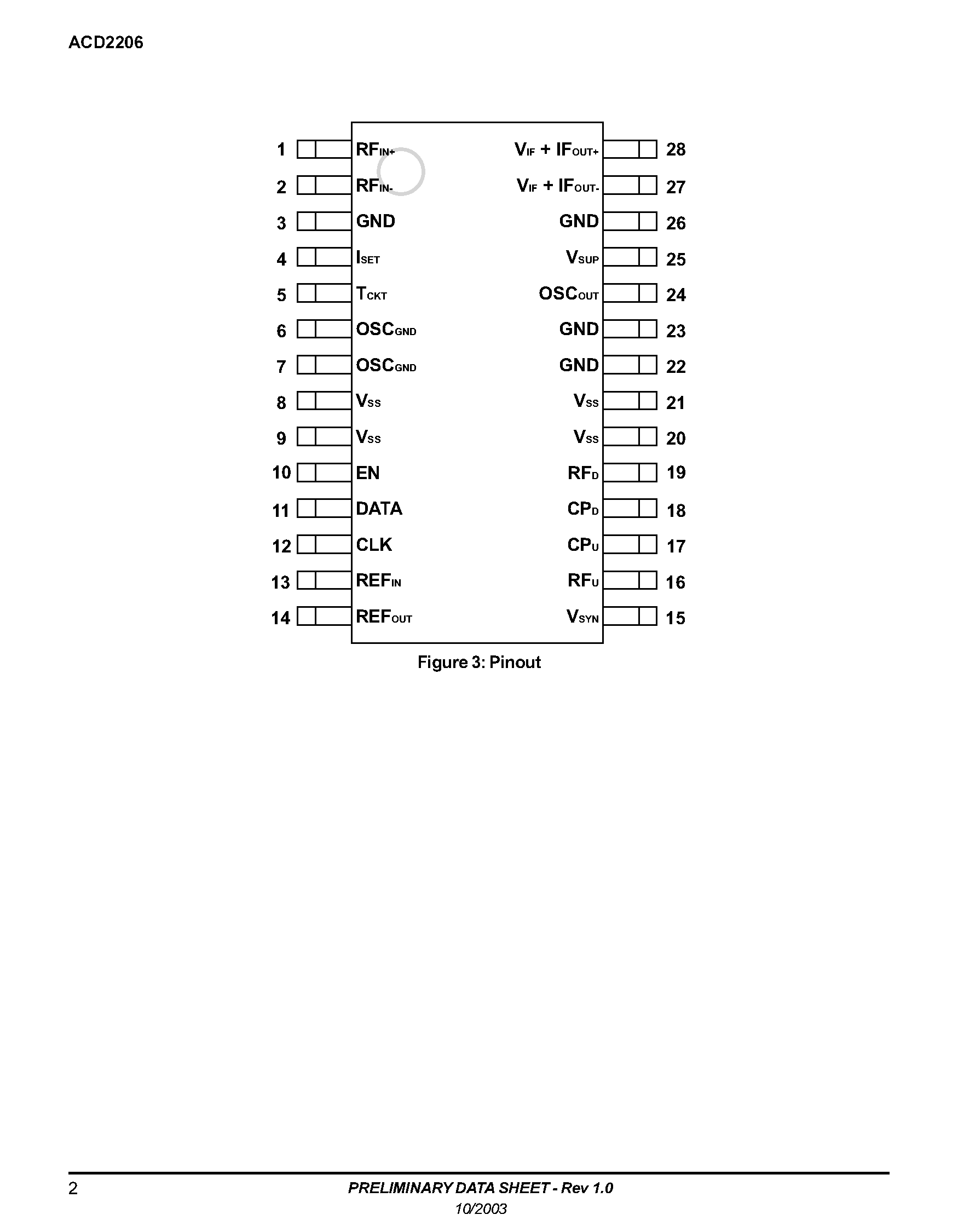

1 2 3 4 5 6 7 8 9 10 11 12 13 14
RFIN+ RFINGND ISET TCKT OSCGND OSCGND VSS VSS EN DATA CLK REFIN REFOUT
VIF + IFOUT+ VIF + IFOUTGND VSUP OSCOUT GND GND VSS VSS RFD CPD CPU RFU VSYN
Figure 3: Pinout
28 27 26 25 24 23 22 21 20 19 18 17 16 15
2
PRELIMINARY DATA SHEET - Rev 1.0 10/2003
ACD2206 Table 1: Pin
P IN
1
N AM E
RFIN+
D E S C R IP T ION
Downconverter Di fferenti al RFInput Downconverter Di fferenti al RFInput Downconverter Ground (Must be connected) Downconverter Gi lbert Cell Current Source Resi stor Osci llator Input Port (Tank ci rcui t connecti on) Osci llator Tank Ci rcui t Ground (Not to be connected to any other ci rcui t ground) Same as Pi n 6 Synthesi zer Ground (Requi red) Synthesi zer Ground (Requi red) 3-Wi re Interface Enable 3-Wi re Interface Data 3-Wi re Interface Clock Crystal Reference Input Crystal Reference Output
P IN
28
N AM E
VIF+IFOUT+
D E S C R IP T ION
Di fferenti al IF Ampli fi er Output, Inducti vely coupled to +VDD Di fferenti al IF Ampli fi er Output, Inducti vely coupled to +VDD Downconverter Ground (Must be connected) Downconverter Supply (+VDD) Osci llator Output (Connected to Synthesi zer RF Input) Downconverter Ground (Must be connected) Downconverter Ground (Must be connected) Synthesi zer Ground (Requi red) Synthesi zer Ground (Requi red) Synthesi zer Downconverter RFInput Synthesi zer Downconverter Charge Pump Output Synthesi zer Upconverter Charge Pump Output Synthesi zer Upconverter RFInput Synthesi zer Supply (+VDD)
2 3 4
RFINGND ISET
27 26 25
VIF+IFOUT GND VSUP
5
TCKT
24
OSCOUT
6
OSCGND
23
GND
OSCGND V SS V SS EN DATA CLK REFIN REFOUT
GND V SS V SS RFD CPD CPU RFU VSYN
