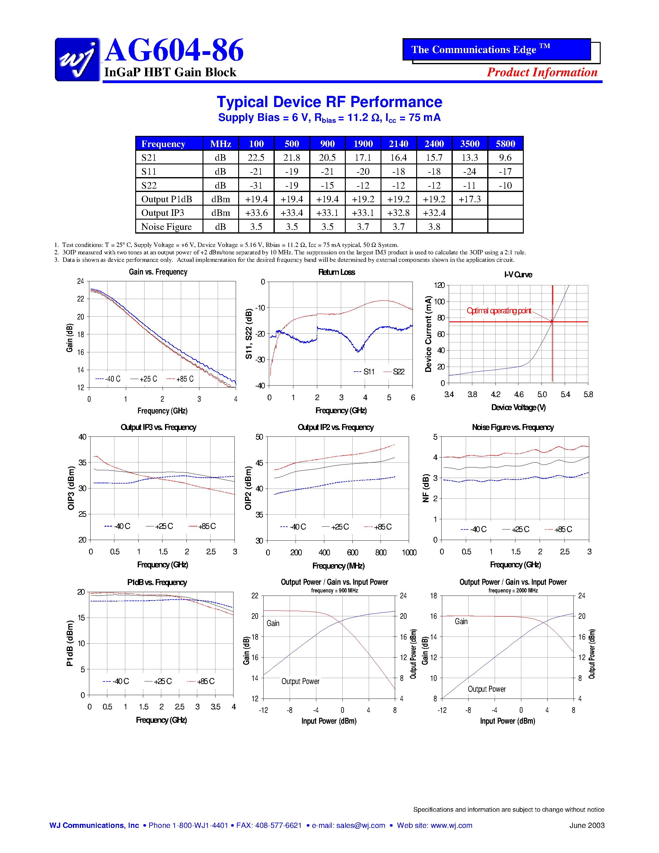

AG602-86PCB-InGaP HBT Gain Block
Producer:ETC
Description:InGaP HBT Gain Block
