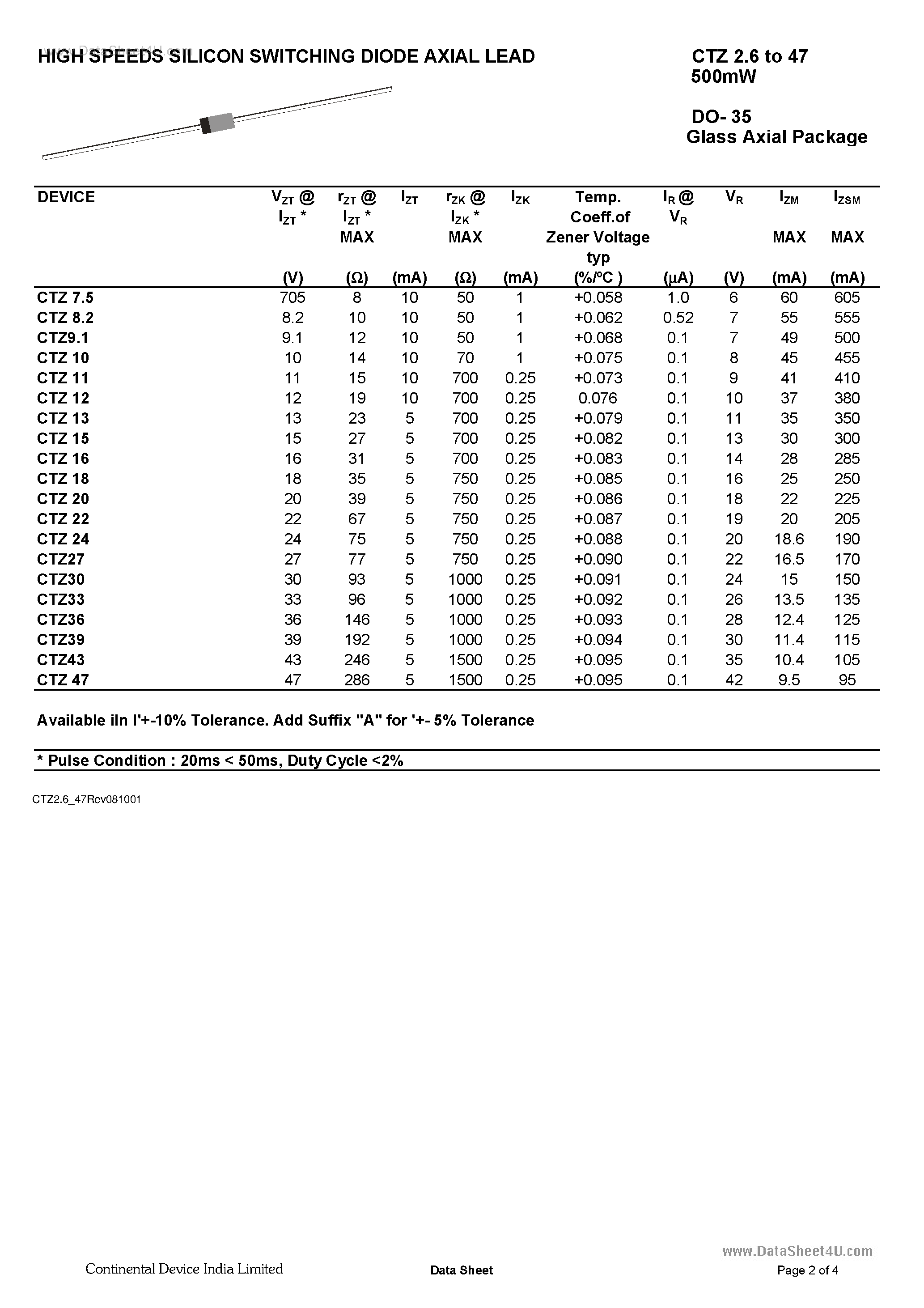

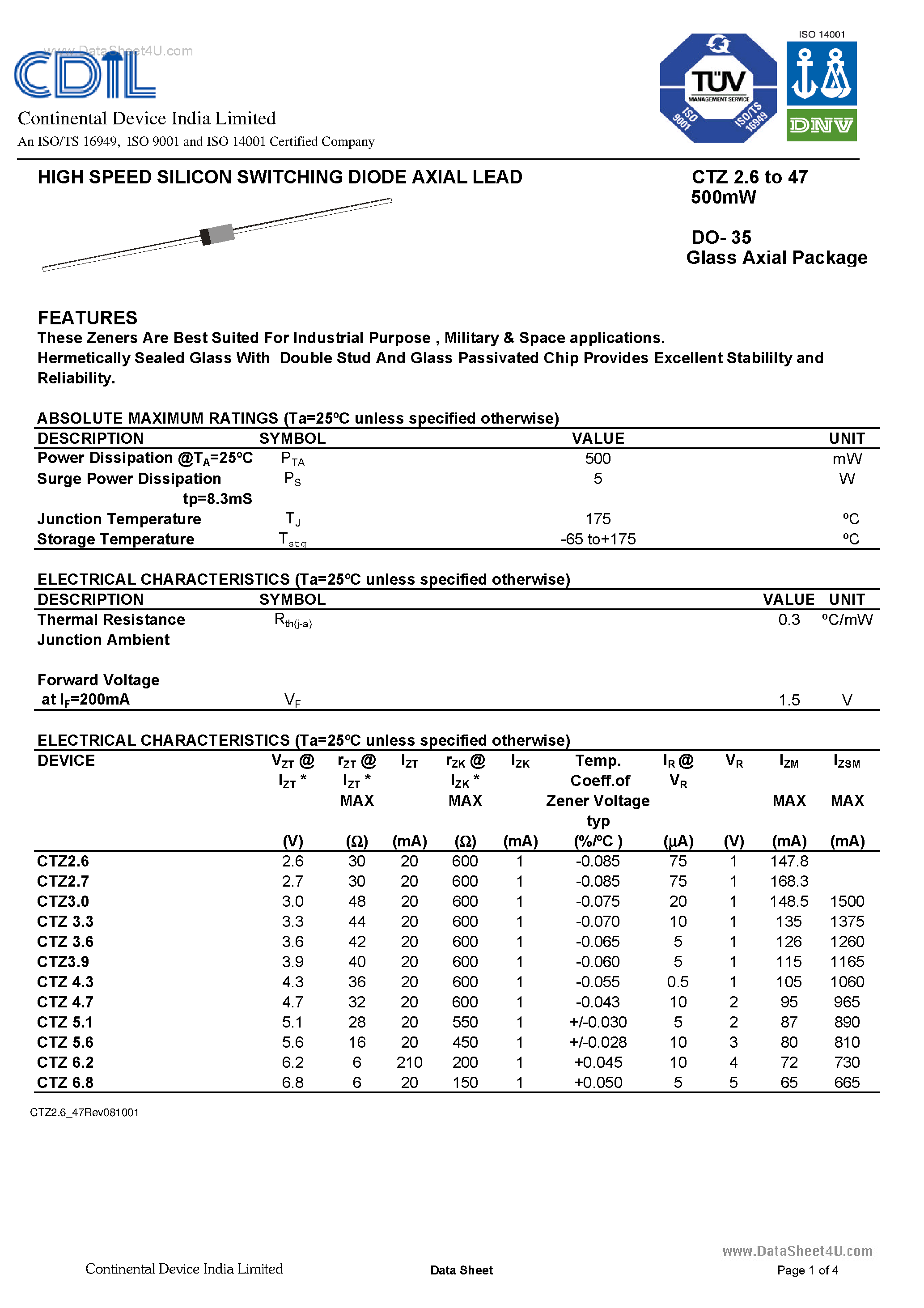

CTZ15-(CTZ2.6 - CTZ47) HIGH SPEED SILICON SWITCHING DIODE AXIAL LEAD
Producer:CDIL
Description:(CTZ2.6 - CTZ47) HIGH SPEED SILICON SWITCHING DIODE AXIAL LEAD
