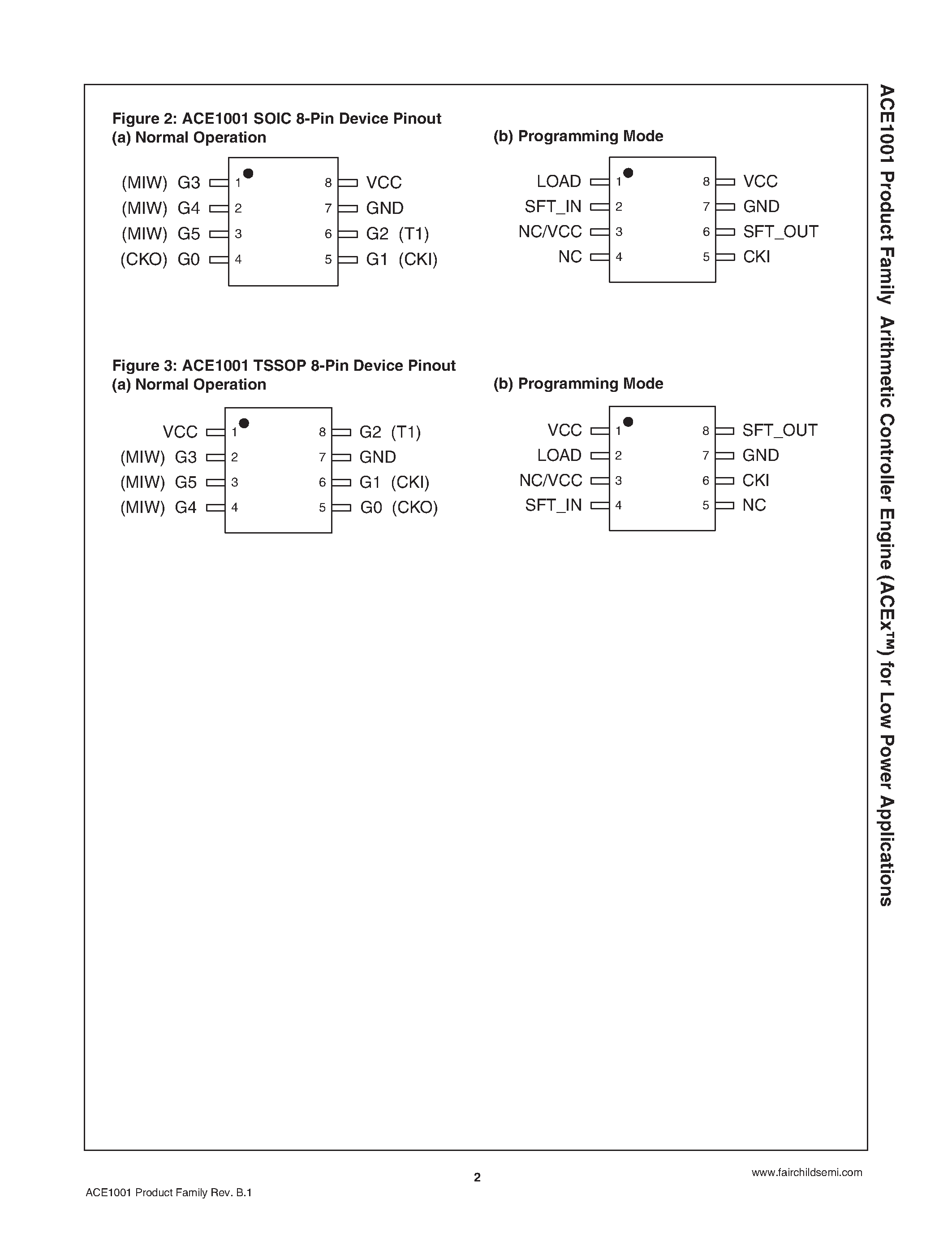

Figure 2: ACE1001 SOIC 8-Pin Device Pinout (a) Normal Operation
(b) Programming Mode
(MIW) G3 (MIW) G4 (MIW) G5 (CKO) G0
1 2 3 4
8 7 6 5
VCC GND G2 (T1) G1 (CKI)
LOAD SFT_IN NC/VCC NC
1 2 3 4
8 7 6 5
VCC GND SFT_OUT CKI
Figure 3: ACE1001 TSSOP 8-Pin Device Pinout (a) Normal Operation
VCC (MIW) G3 (MIW) G5 (MIW) G4
1 2 3 4
8 7 6 5
G2 (T1) GND G1 (CKI) G0 (CKO)
VCC LOAD NC/VCC SFT_IN
1 2 3 4
8 7 6 5
SFT_OUT GND CKI NC
