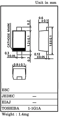

TOSHIBA DIODE SILICON EPITAXIAL PLANAR TYPE
015AZ2.0-015AZ12
CONSTANT VOLTAGE REGULATION APPLICATIONS
• Small Package
• Nominal voltage tolerance about +2.5%
(2.0V-12V)
MAXIMUM RATINGS (Та = 25°C)
CHARACTERISTIC
SYMBOL
RATING
UNIT
Power Dissipation
p*
200
mW
Junction Temperature
Tj
125
°C
Storage Temperature Range
Tstg
-55-125
°C
* Mounted on a glass epoxy circuit board of 20 X 20mm, Pad dimension of 4X4mm.
Toshiba 015AZ2.0-015AZ12
