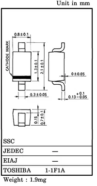

OSHIBA DIODE SILICON EPITAXIAL PLANAR TYPE
015Z2.0-015Z12
CONSTANT VOLTAGE REGULATION APPLICATIONS
• Small Package
• Nominal voltage tolerance about +2.5%
(2.0V-12V)
