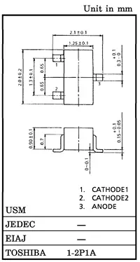

TOSHIBA DIODES FOR PROTECTING AGAINST ESD EPITAXIAL PLANAR TYPE
01 BZA8.2
• Because two devices are mounted on an ultra compact package, it is possible to allow reducing the number of the parts and the mounting cost.
MAXIMUM RATINGS (Ta = 25°C)
CHARACTERISTIC
SYMBOL
RATING
UNIT
Power Dissipation
P
100
mW
Junction Temperature
T j
125
°C
Storage Temperature Range
Tstg
-55-125
°C
