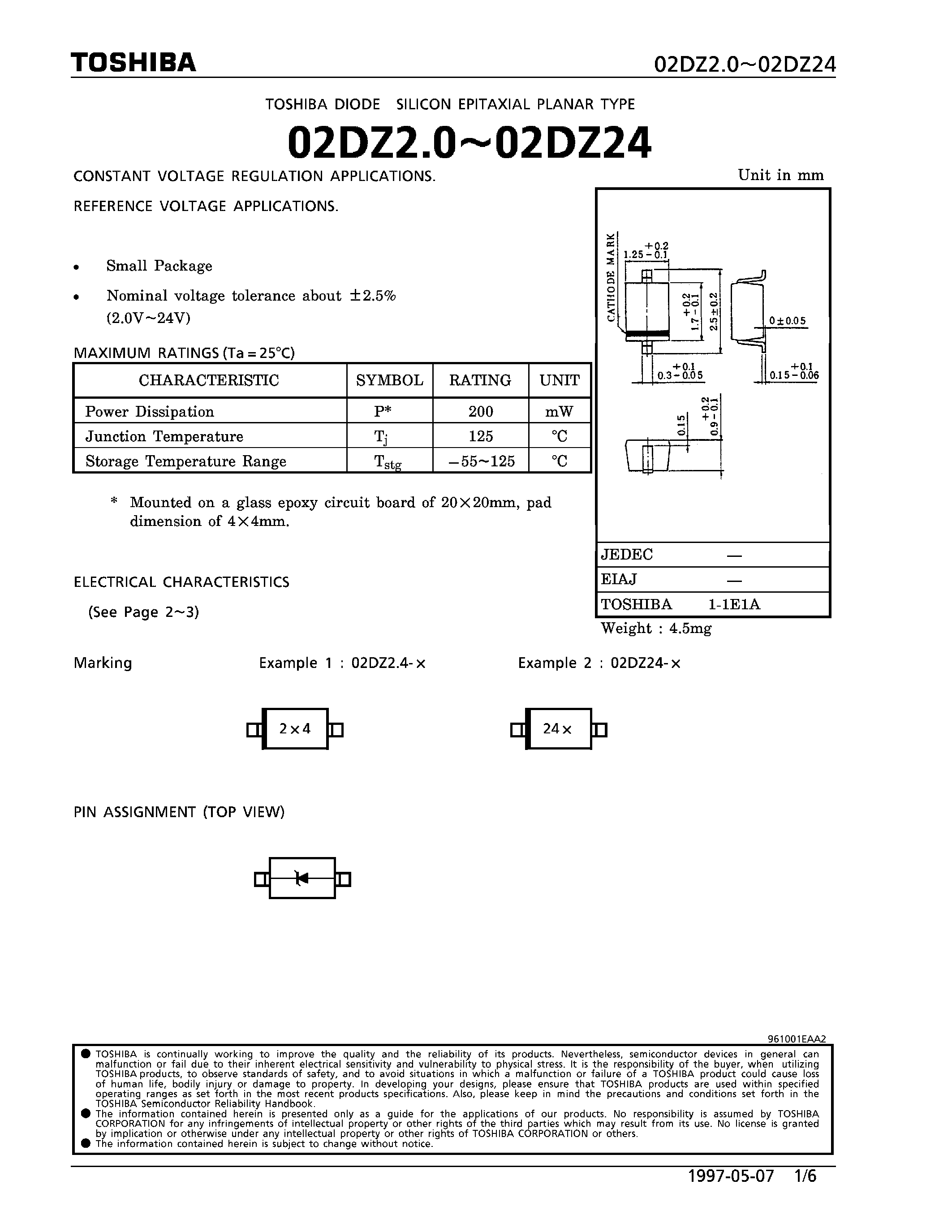

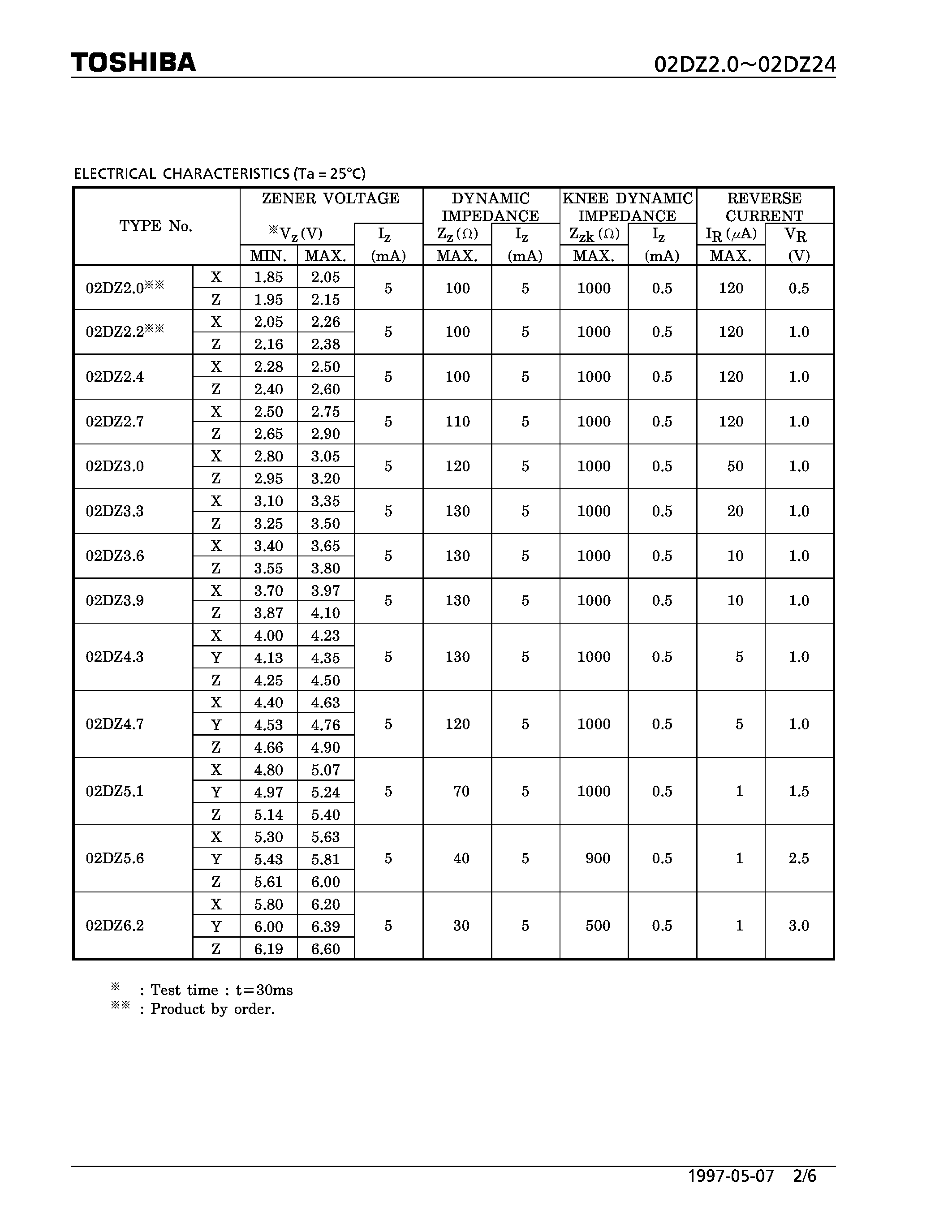

TOSHIBA DIODE SILICON EPITAXIAL PLANAR TYPE
02DZ2.0-02DZ24
CONSTANT VOLTAGE REGULATION APPLICATIONS. REFERENCE VOLTAGE APPLICATIONS.
• Small Package
• Nominal voltage tolerance about ±2.5% (2.0V-24V)
MAXIMUM RATINGS (Та = 25°C)
CHARACTERISTIC
SYMBOL
RATING
UNIT
Power Dissipation
p*
200
mW
Junction Temperature
Tj
125
°C
Storage Temperature Range
Tstg
-55-125
°C
* Mounted on a glass epoxy circuit board of 20 X 20mm, pad dimension of 4X4mm.
