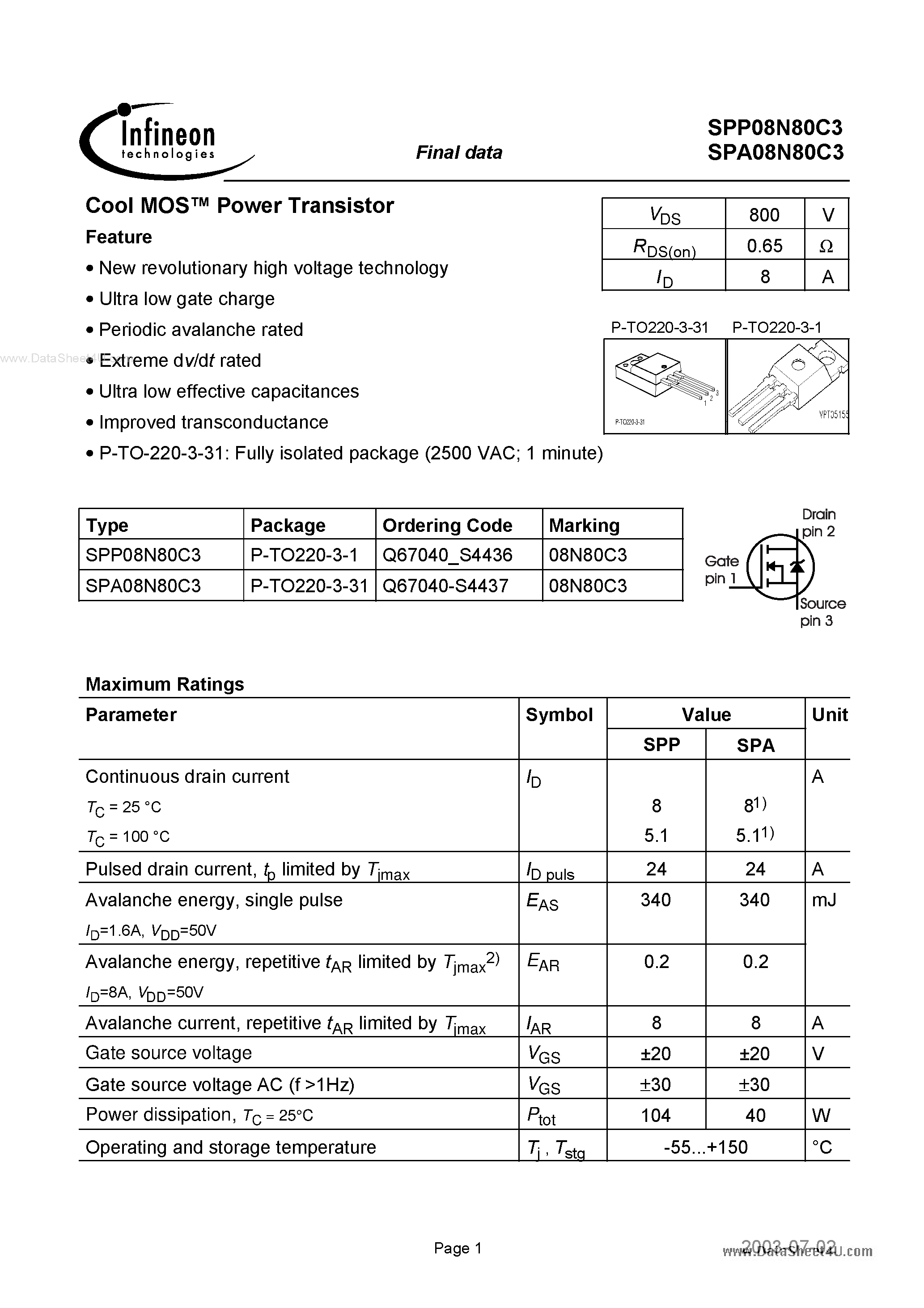

Cool MOS™ Power Transistor
Feature
□ New revolutionary high voltage technology
□ Ultra low gate charge
□ Periodic avalanche rated
□ Extreme dv/dt rated
□ Ultra low effective capacitances
□ Improved transconductance

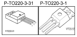

□ P-TO-220-3-31: Fully isolated package (2500 VAC; 1 minute)
VDS
800
V
RDS(on)
0.65
Ω
ID
8
A
P-TO220-3-31 P-TO220-3-1
Type
Package
Ordering Code
Marking
SPP08N80C3
P-TO220-3-1
Q67040_S4436
08N80C3
SPA08N80C3
P-TO220-3-31
Q67040-S4437
08N80C3
