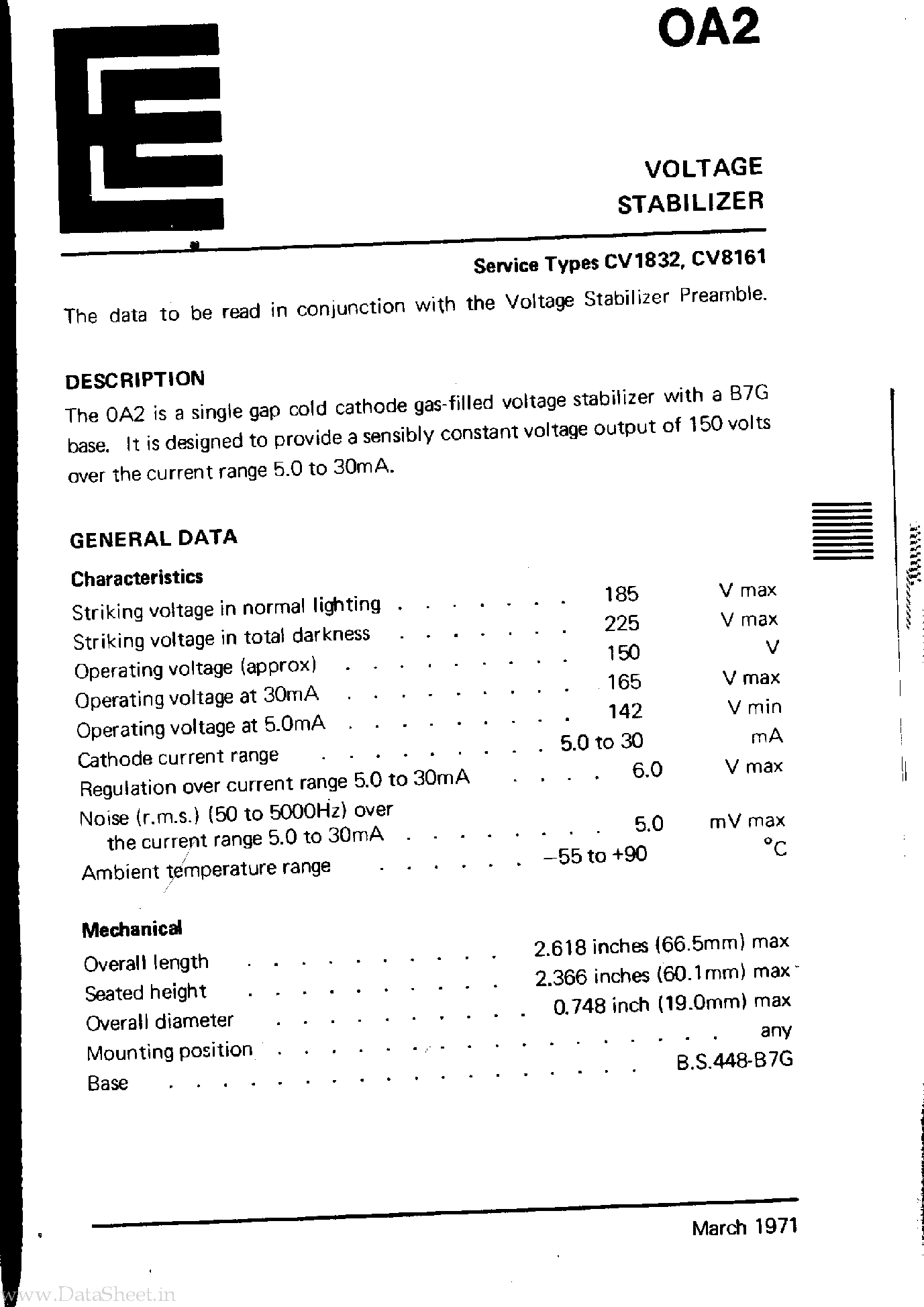

Service Types CV1832, CV8161
The data to be read in conjunction with the Voltage Stabilizer Preamble.
Description
The 0A2 is a single gap cold cathode gas-tilled    voltage stabilizer    with    a B7G base. It is designed to provide a sensiblv    constant voltage output    of    150 volts over the current range 5.0 to 30mA.
GENERAL DATA
Characteristics
Striking voltage in normal lighting....... 185     V    max
Striking voltage in total darkness....... 225     V    max
Operating voltage (approx)......... 150  V mgx
Operating voltage at 30mA......... 165  V min
Operating voltage at 5.0mA........142  V min
Cathode current range .......... 5.0 to 30    mA
Regulation over current range 5.0 to 30mA.....6.0  V max
Noise (r.m.s.) (50 to 5000Hz) over  the current range 5.0 to 30mA    5 mV max
Ambient temperature range ......  -55 to +90    °C

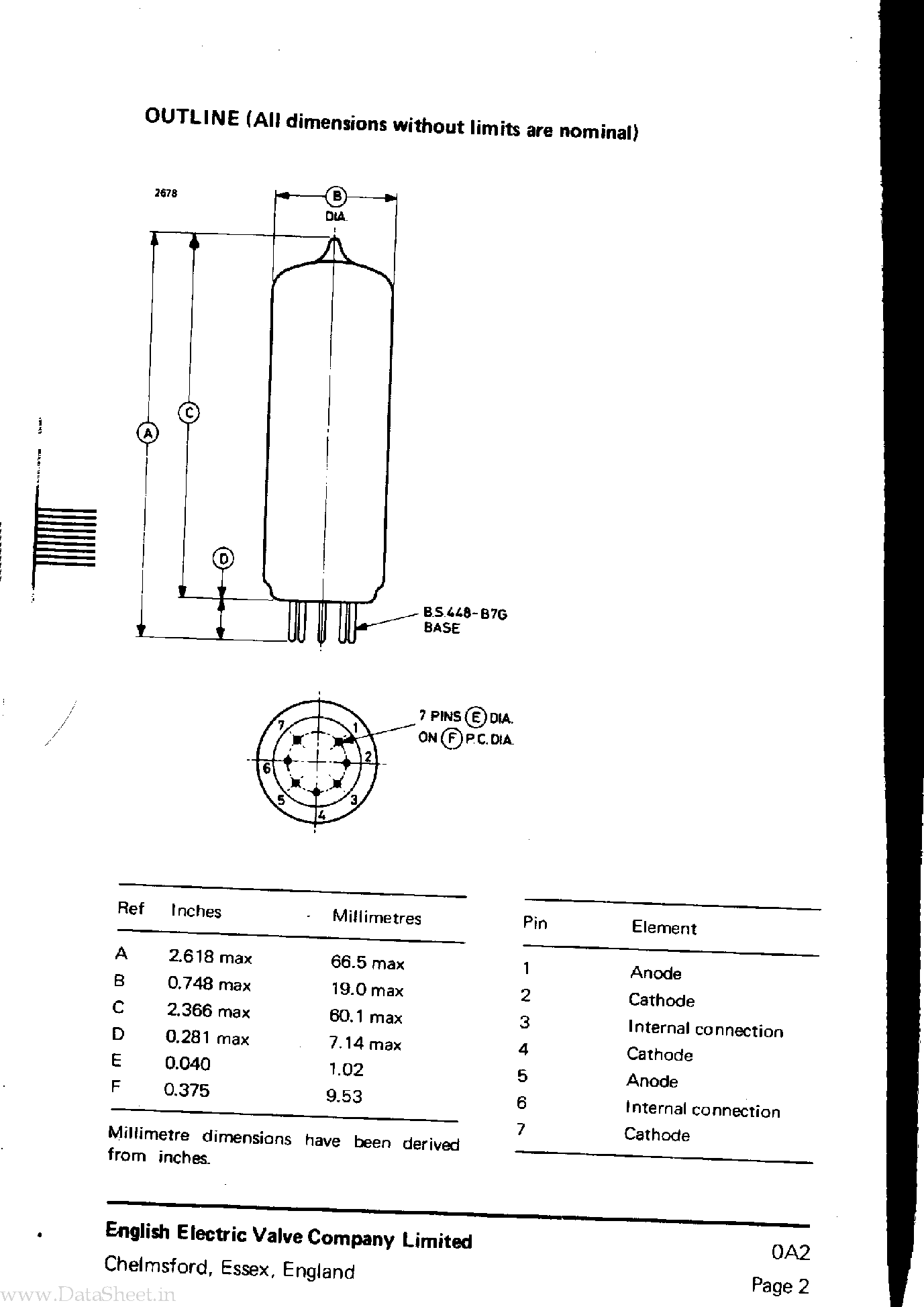

Overall length .    .    2.618    inches (66.5 mm)    max
Seated height........   2.366    inches (60.1 mm)    max
 Overall diameter ....... 0.748   inches   (19.0 mm)    max
Mounting position.......... any
Base...... B.S.448-B7G
