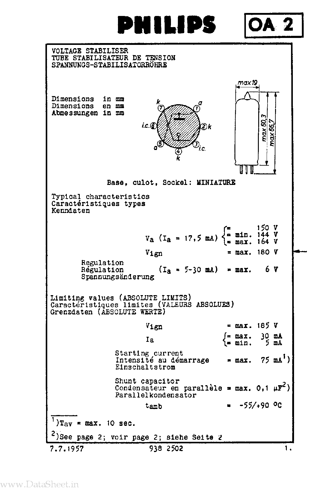

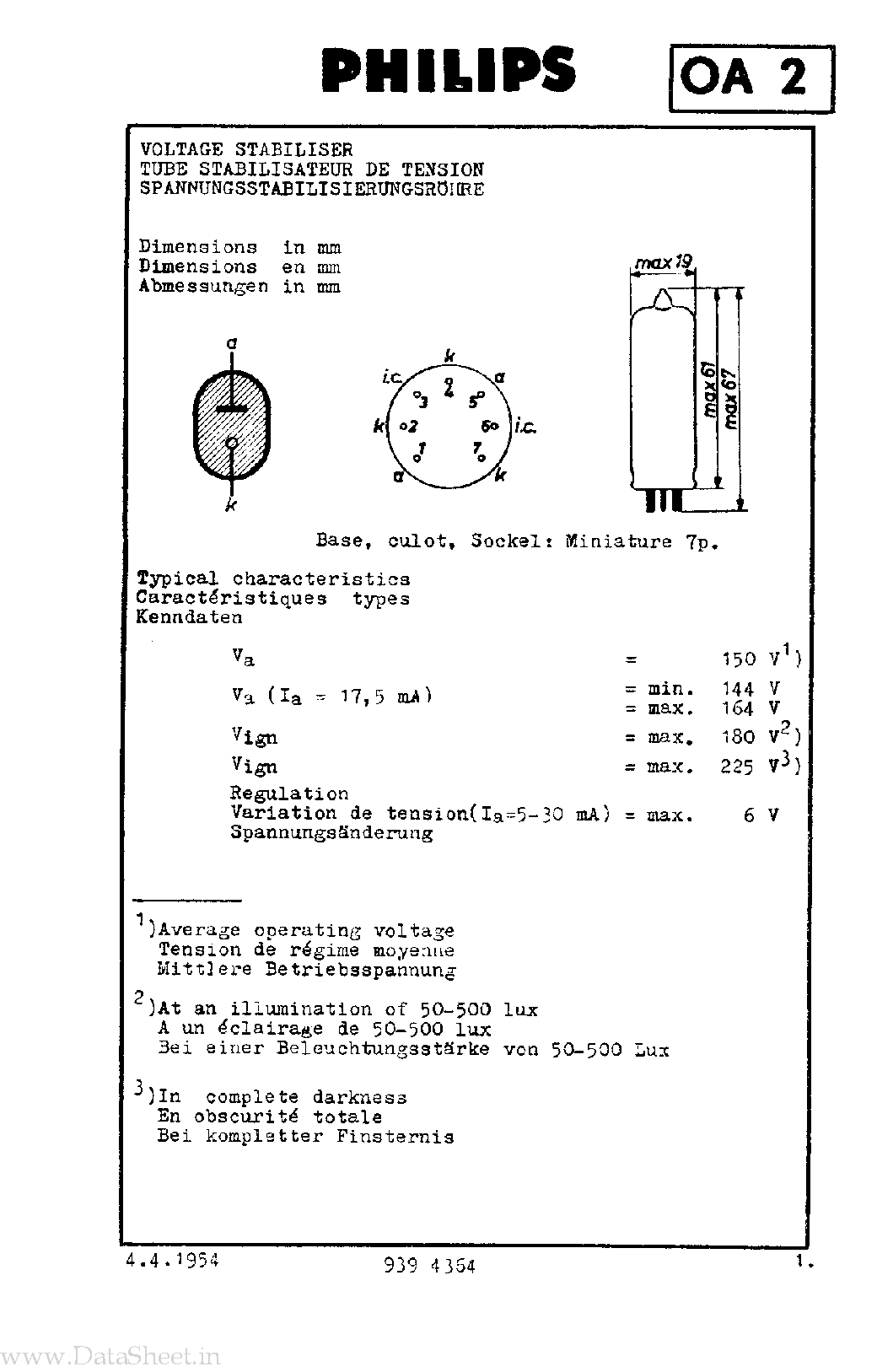

Philips 0A2
Base, culot, Sockel: Miniature 7p.
Typical characteristics
Caracteristiques types
Kenndaten
Va    =    150    V1)
Va (la = 17,5 mA)    =    min.      144 V
                             =    max.    164    V
Vign    =    max.    180    V2)
Vign    =    max.    225    V3)
Regulation
Variation de tension(Ia=5-30 mA) = max. 6 V
Spannungsanderung
1) Average operating voltage Tension de regime moyenue Mitt]ere Betriebsspannung
2) At an illumination of 50-500 lux A un ^clairage de 50-500 lux Bei einer BeleuchtungsstSrke von 50-500 Lux
3) In complete darkness En obscurite totale Bei kompletter Finsternis
