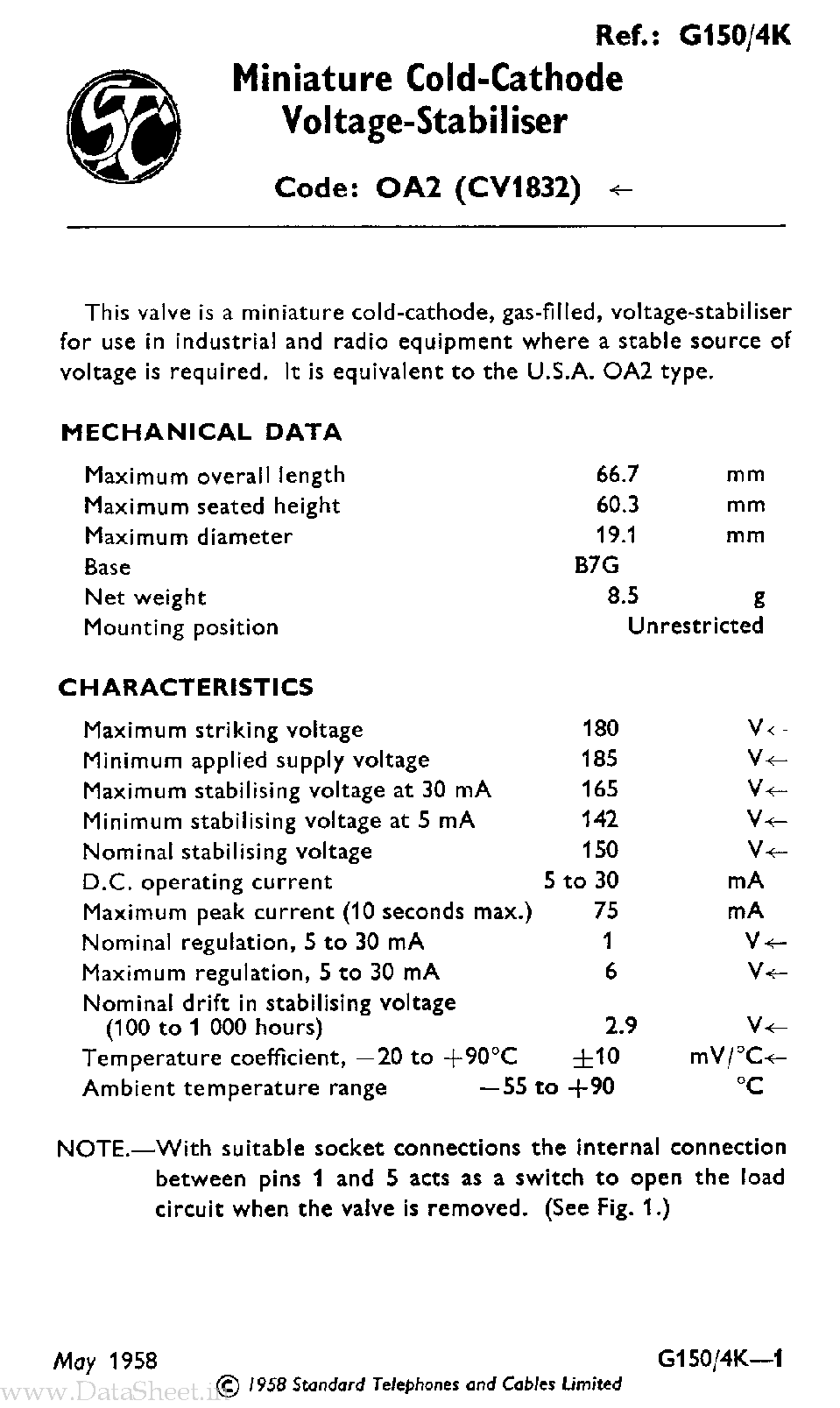

This valve is a miniature cold-cathode, gas-filled, voltage-stabiliser for use in industrial and radio equipment where a stable source of voltage is required. It is equivalent to the U.S.A. OA2 type.
MECHANICAL DATA
Maximum overall length    66.7    mm
Maximum seated height    60.3    mm
Maximum diameter    19.1    mm
Base    B7G
Net weight    8.5    g
Mounting position    Unrestricted
CHARACTERISTICS
Maximum striking voltage    180    V<-
Minimum applied supply voltage    185    V<-
Maximum stabilising voltage at 30 mA    165    V<-
Minimum stabilising voltage at 5 mA    142    V<-
Nominal stabilising voltage    150    V<-
D.C. operating current    5    to    30    mA
Maximum peak current (10 seconds max.) 75    mA
Nominal regulation, 5 to 30 mA    1    V<-
Maximum regulation, 5 to 30 mA    6    V<-
Nominal drift in stabilising voltage (100 to 1 000 hours)    2.9    V<-
Tem peratu re coefficient,—20 to +90°C    ±10    mV/°C<-
Ambient temperature range    —55    to    +90    °C
