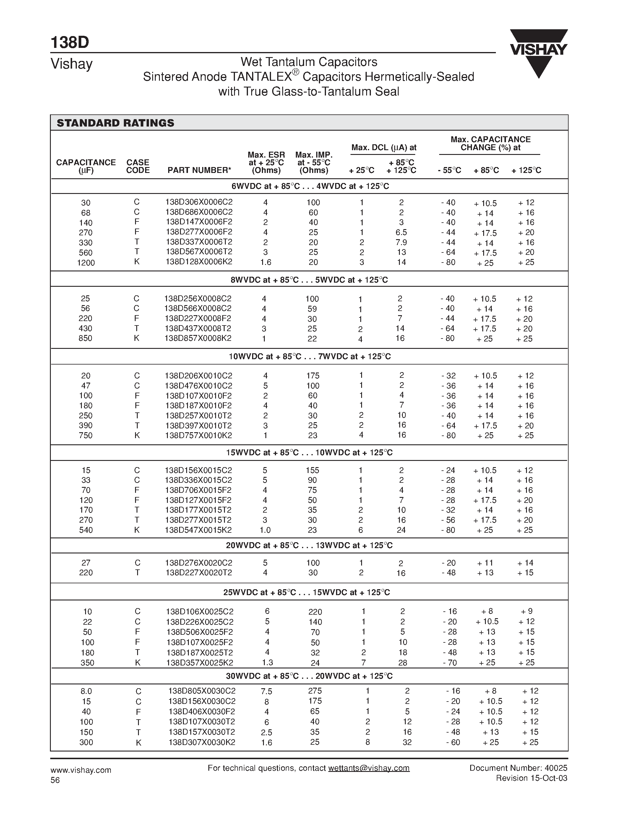

138D106X0025C2-Wet Tantalum Capacitors Sintered Anode TANTALEX Capacitors Hermetically-Sealed with True Glass-to-Tantalum Seal
Producer:Vishay Siliconix
Description:Wet Tantalum Capacitors Sintered Anode TANTALEX Capacitors Hermetically-Sealed with True Glass-to-Tantalum Seal
Others with the same file: 138D106X0025C2
Datasheet 138D106X0025C2 - Wet Tantalum Capacitors Sintered Anode TANTALEX Capacitors Hermetically-Sealed with True Glass-to-Tantalum Seal page 1
Datasheet 138D106X0025C2 - Wet Tantalum Capacitors Sintered Anode TANTALEX Capacitors Hermetically-Sealed with True Glass-to-Tantalum Seal page 2
