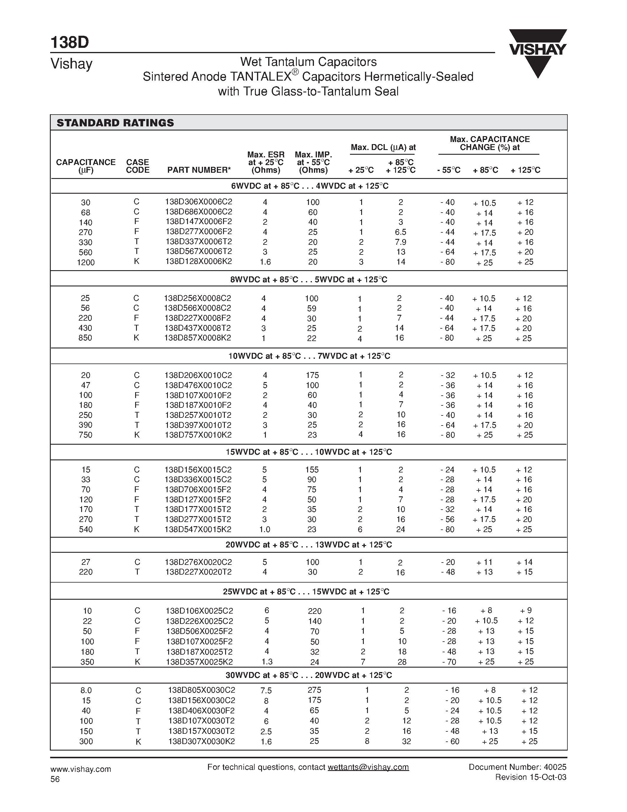

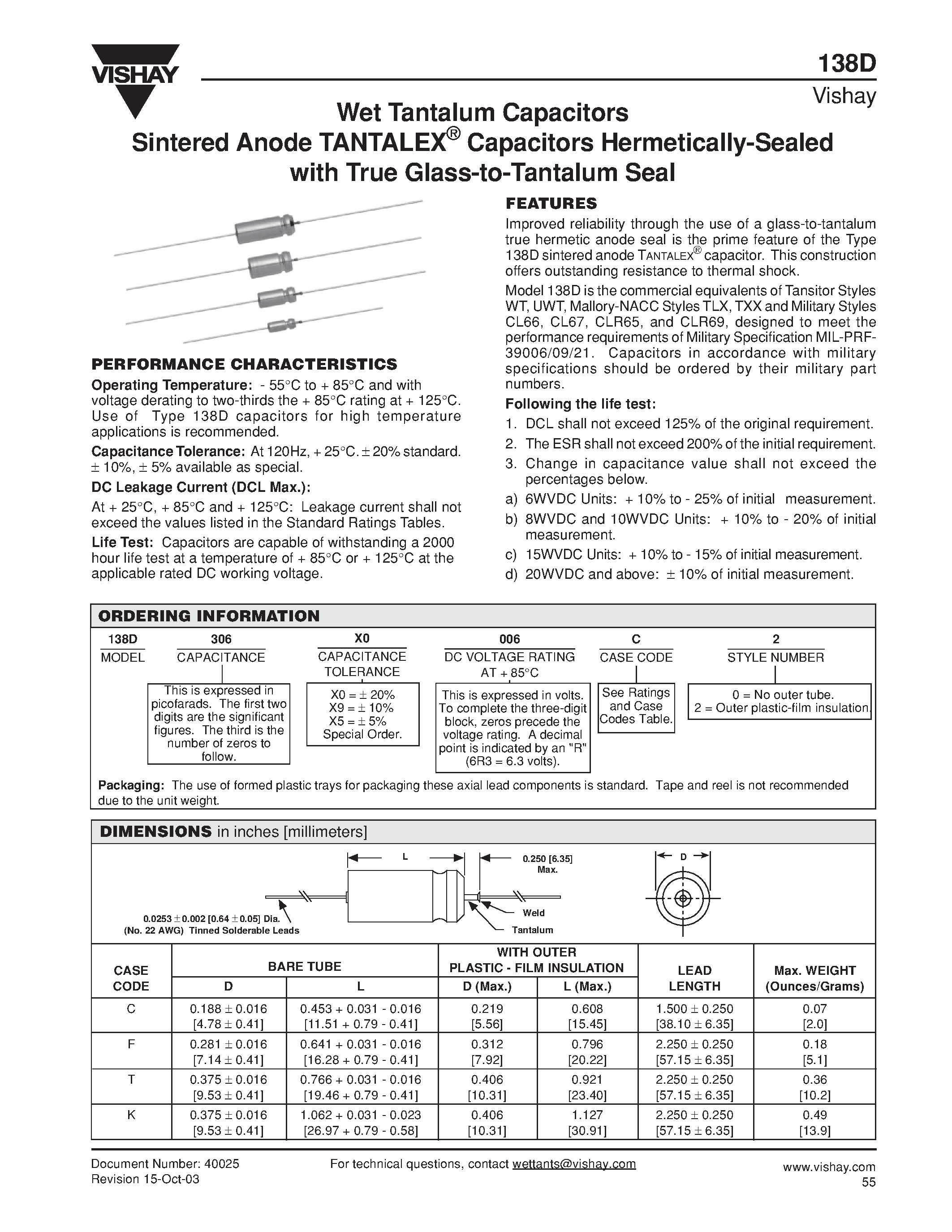

138D107X0010F2-Wet Tantalum Capacitors Sintered Anode TANTALEX Capacitors Hermetically-Sealed with True Glass-to-Tantalum Seal
Producer:Vishay Siliconix
Description:Wet Tantalum Capacitors Sintered Anode TANTALEX Capacitors Hermetically-Sealed with True Glass-to-Tantalum Seal
