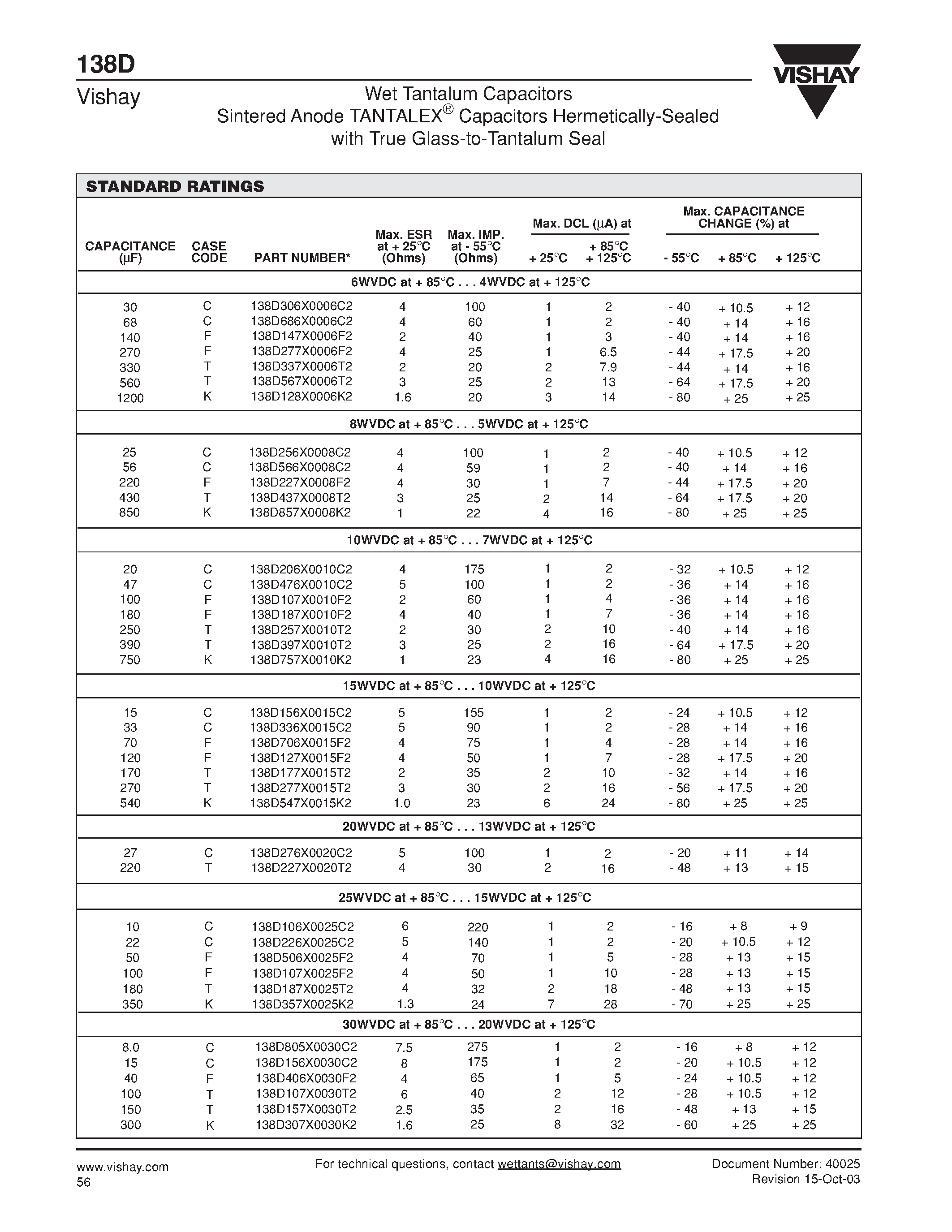

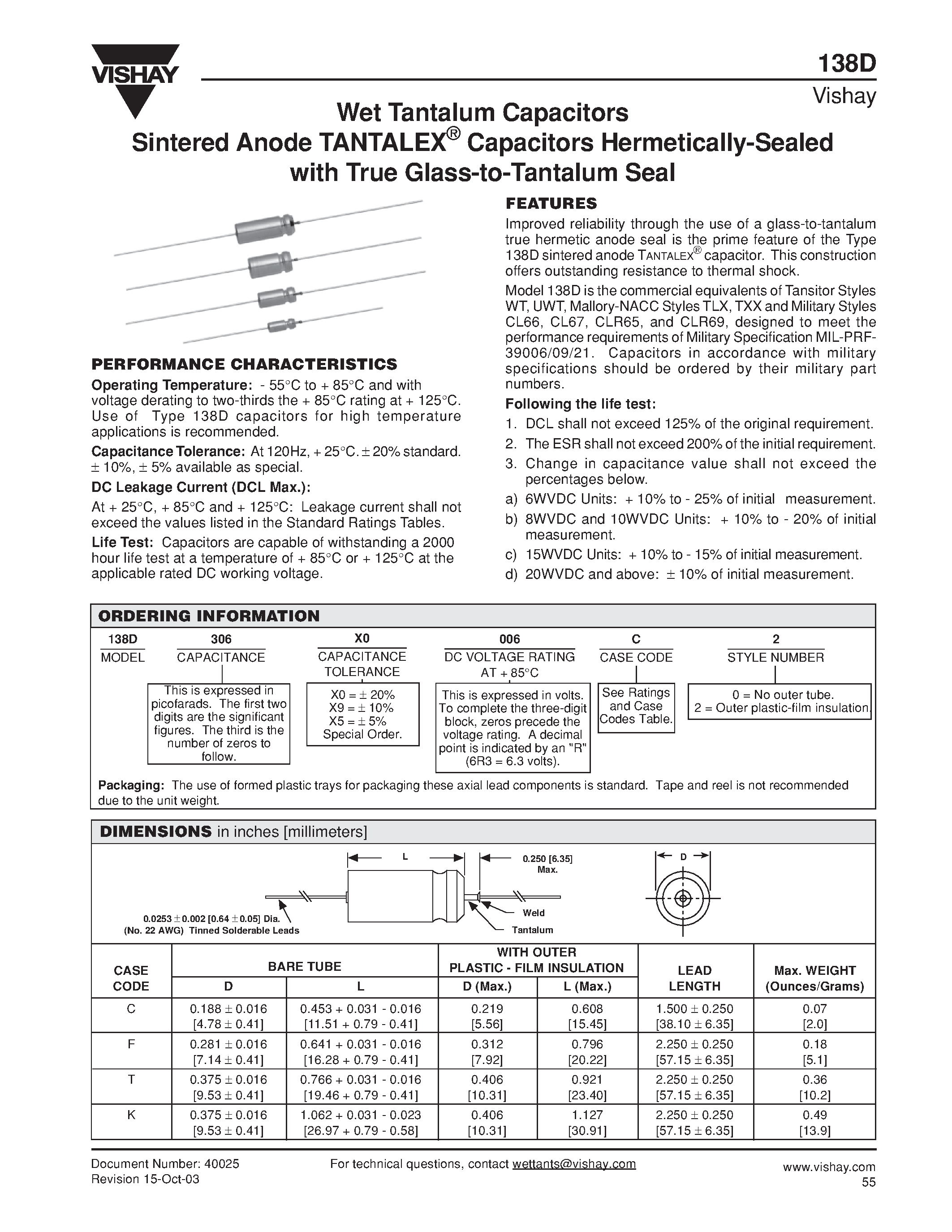

138D128X0006K2-Wet Tantalum Capacitors Sintered Anode TANTALEX Capacitors Hermetically-Sealed with True Glass-to-Tantalum Seal
Producer:Vishay Siliconix
Description:Wet Tantalum Capacitors Sintered Anode TANTALEX Capacitors Hermetically-Sealed with True Glass-to-Tantalum Seal
Others with the same file: 138D128X0006K2
Datasheet 138D128X0006K2 - Wet Tantalum Capacitors Sintered Anode TANTALEX Capacitors Hermetically-Sealed with True Glass-to-Tantalum Seal page 1
