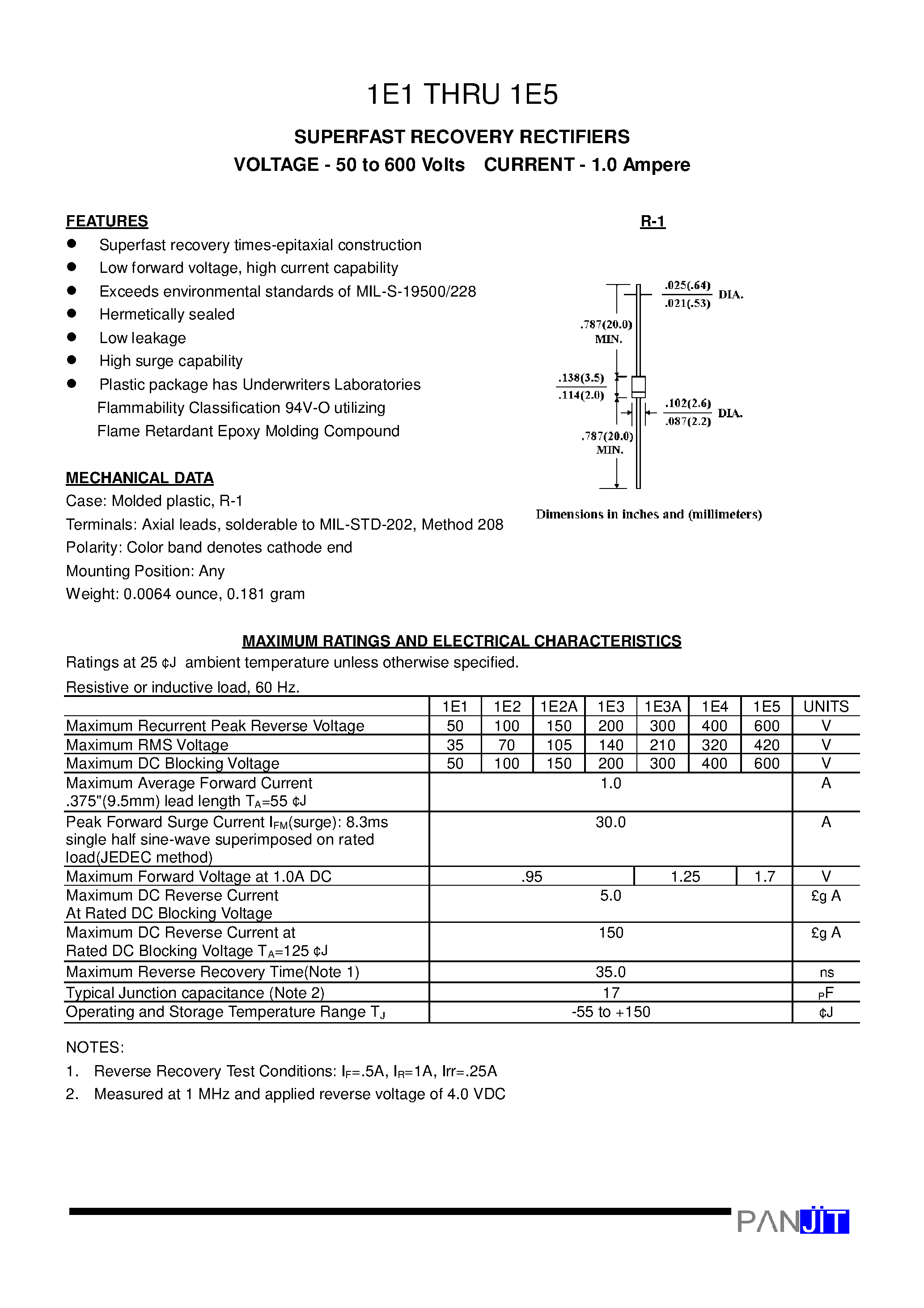

1E2A-SUPERFAST RECOVERY RECTIFIERS(VOLTAGE - 50 to 600 Volts CURRENT - 1.0 Ampere)
Producer:Pan Jit International Inc.
Description:SUPERFAST RECOVERY RECTIFIERS(VOLTAGE - 50 to 600 Volts CURRENT - 1.0 Ampere)
