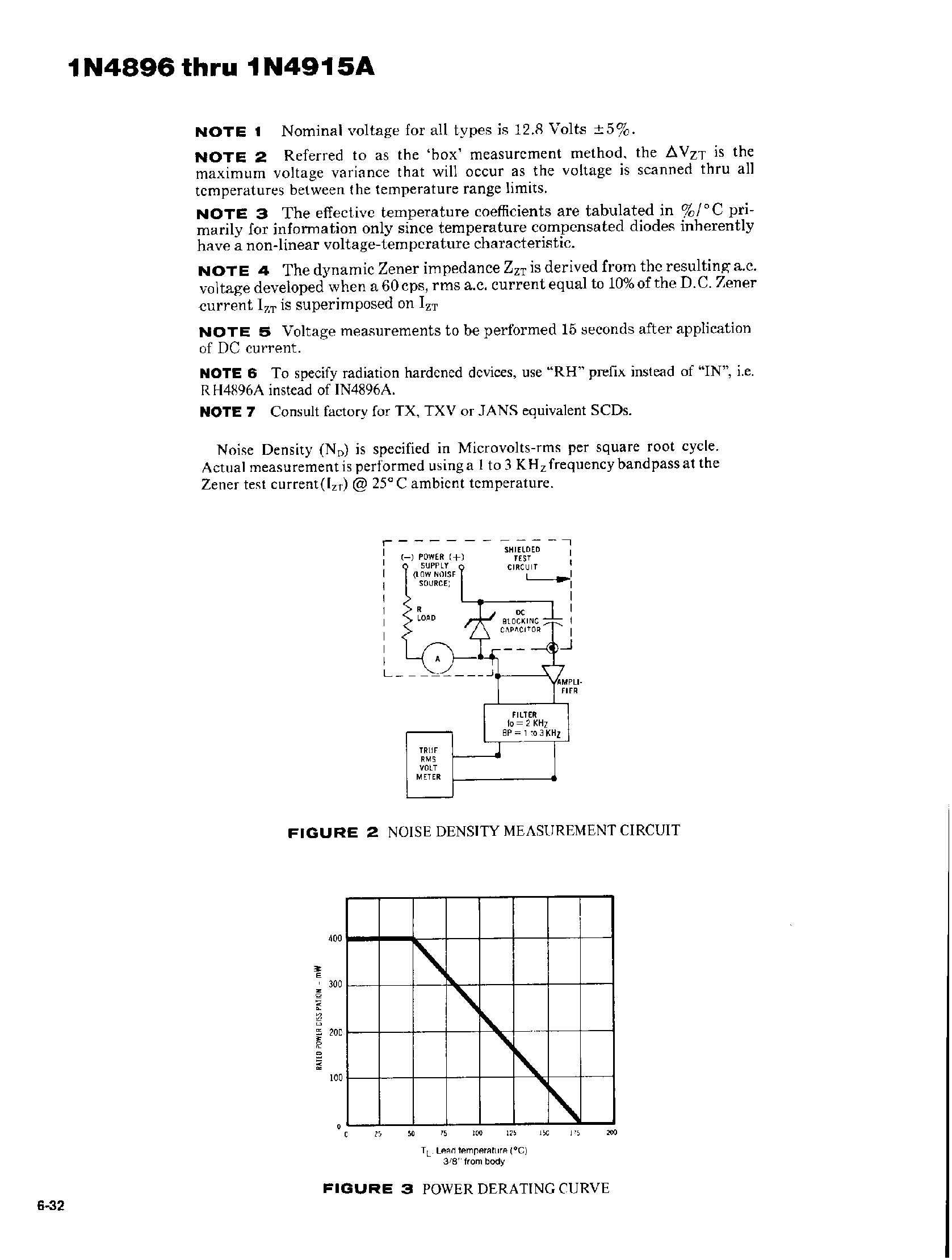

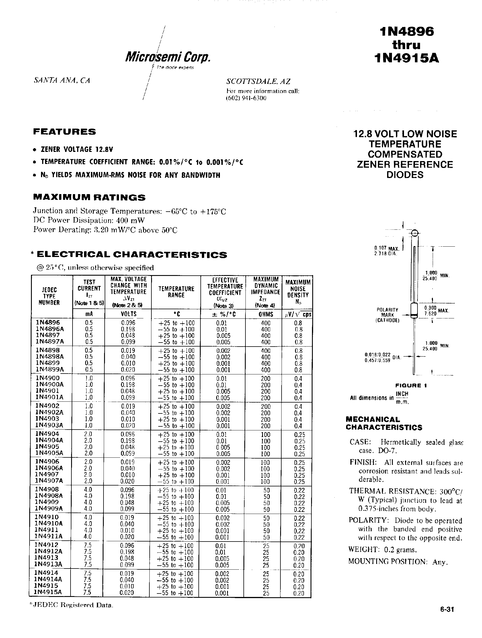

Datasheet 1N4896A - 12.8 VOLT LOW NOISE TEMPERATURE COMPENSATED ZENER REFERENCE DIODES page 1

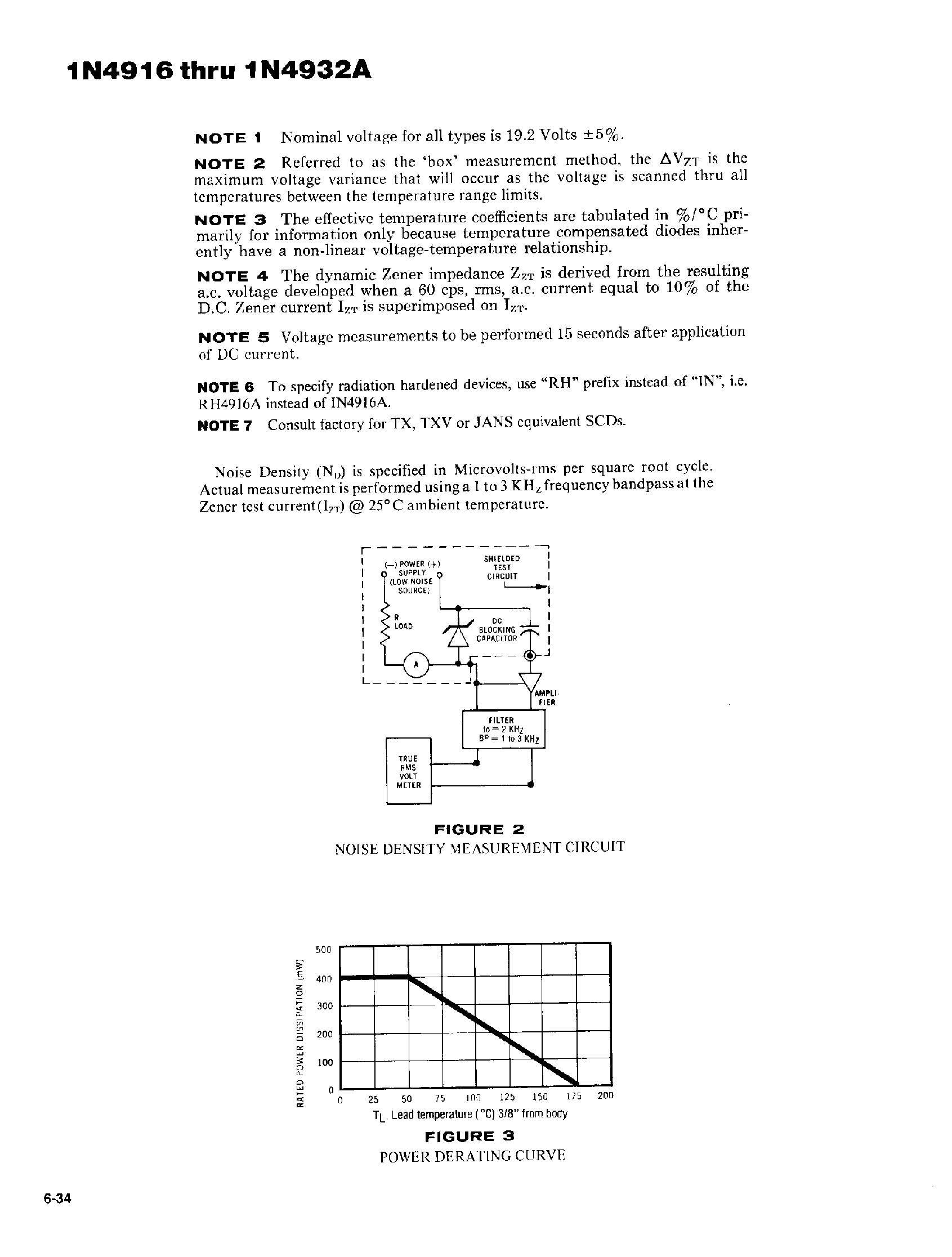

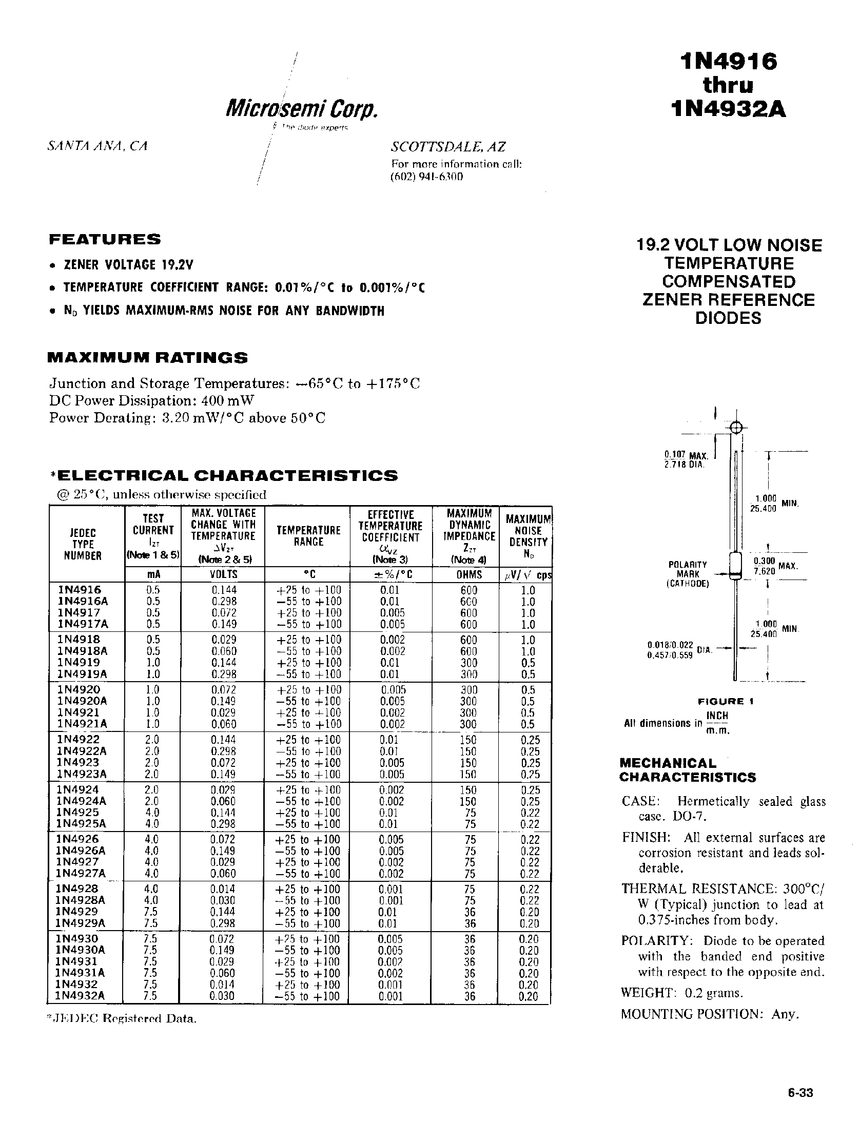

Datasheet 1N4896A - 12.8 VOLT LOW NOISE TEMPERATURE COMPENSATED ZENER REFERENCE DIODES page 2
