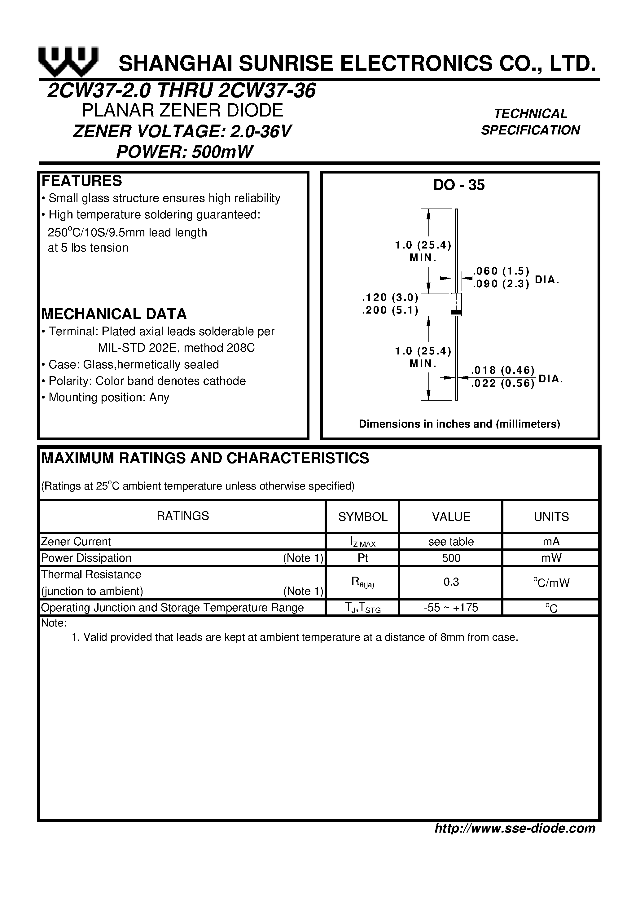

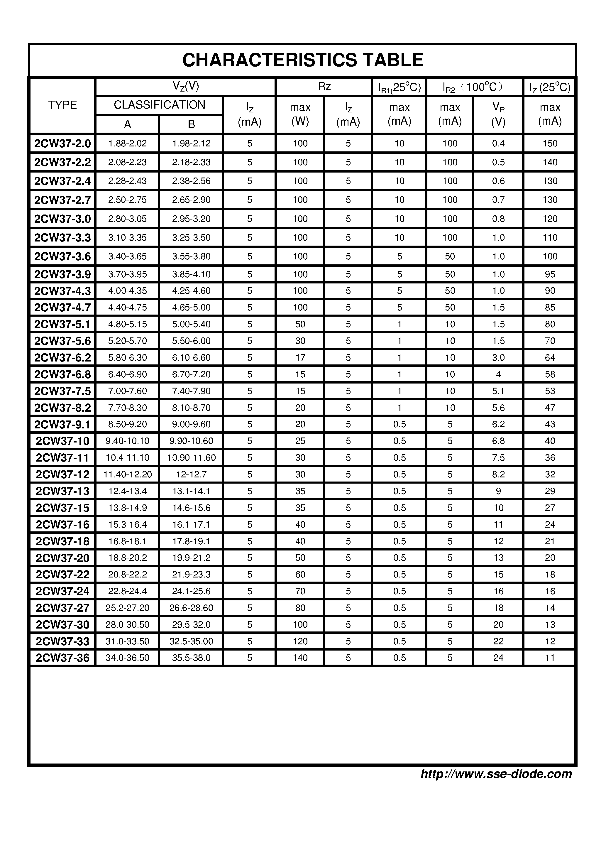

2CW37-2.0-PLANAR ZENER DIODE
Producer:Shanghai Sunrise Electronics
Description:PLANAR ZENER DIODE
Others with the same file: 2CW37-2.0
Datasheet 2CW37-2.0 - PLANAR ZENER DIODE page 1
Datasheet 2CW37-2.0 - PLANAR ZENER DIODE page 2
