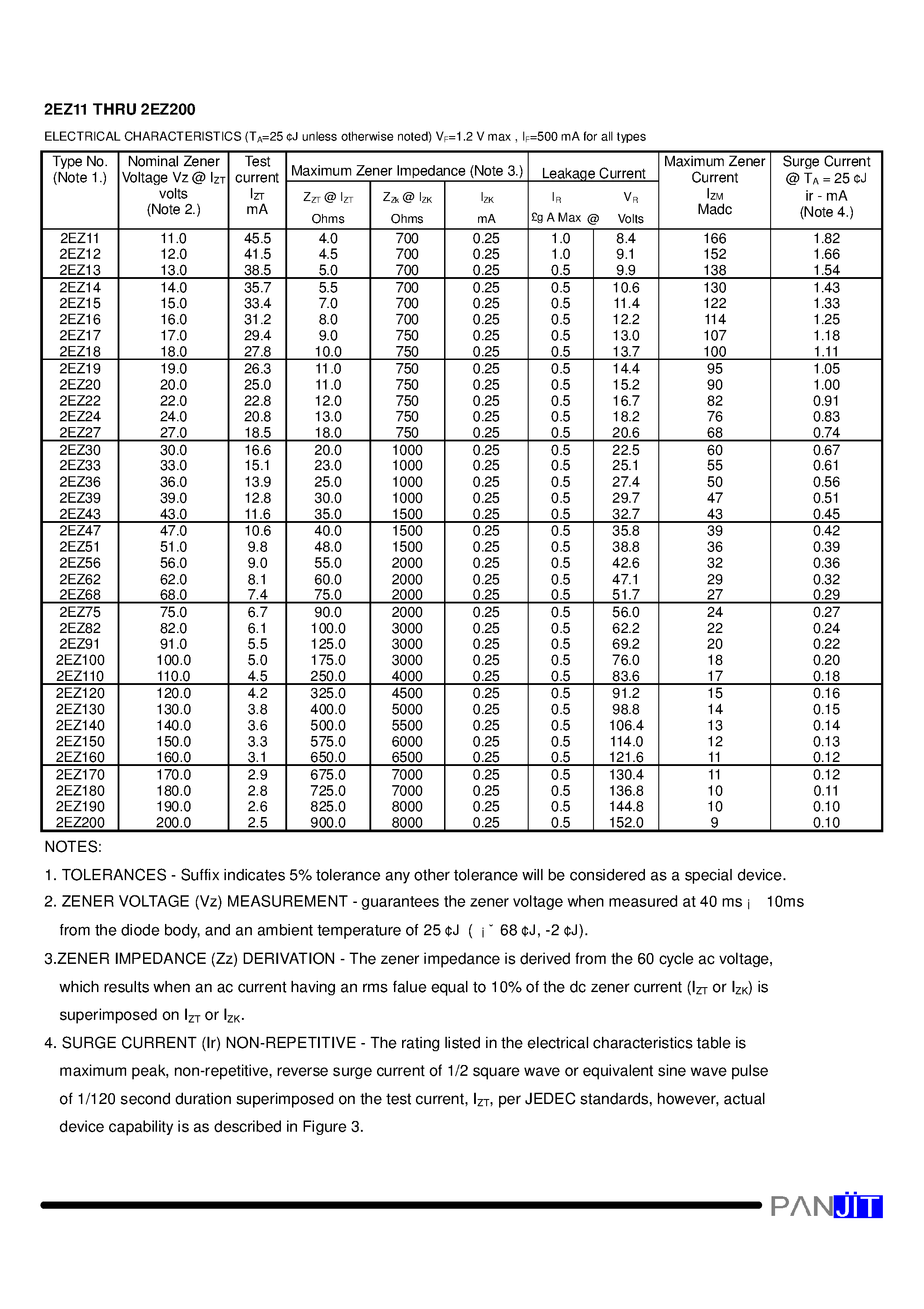

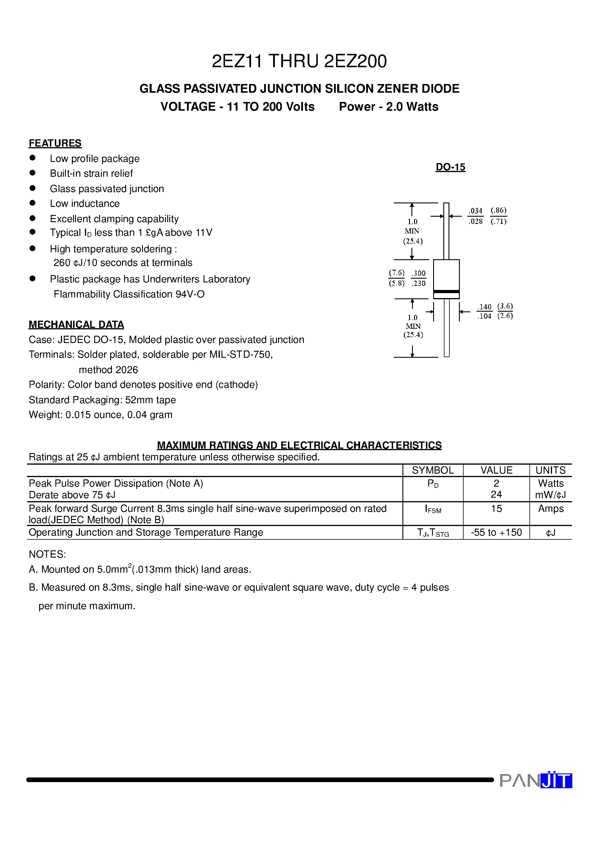

2EZ100-GLASS PASSIVATED JUNCTION SILICON ZENER DIODE(VOLTAGE - 11 TO 200 Volts Power - 2.0 Watts)
Producer:Pan Jit International
Description:GLASS PASSIVATED JUNCTION SILICON ZENER DIODE(VOLTAGE - 11 TO 200 Volts Power - 2.0 Watts)
Others with the same file: 2EZ100
Datasheet 2EZ100 - GLASS PASSIVATED JUNCTION SILICON ZENER DIODE(VOLTAGE - 11 TO 200 Volts Power - 2.0 Watts) page 1
Datasheet 2EZ100 - GLASS PASSIVATED JUNCTION SILICON ZENER DIODE(VOLTAGE - 11 TO 200 Volts Power - 2.0 Watts) page 2
