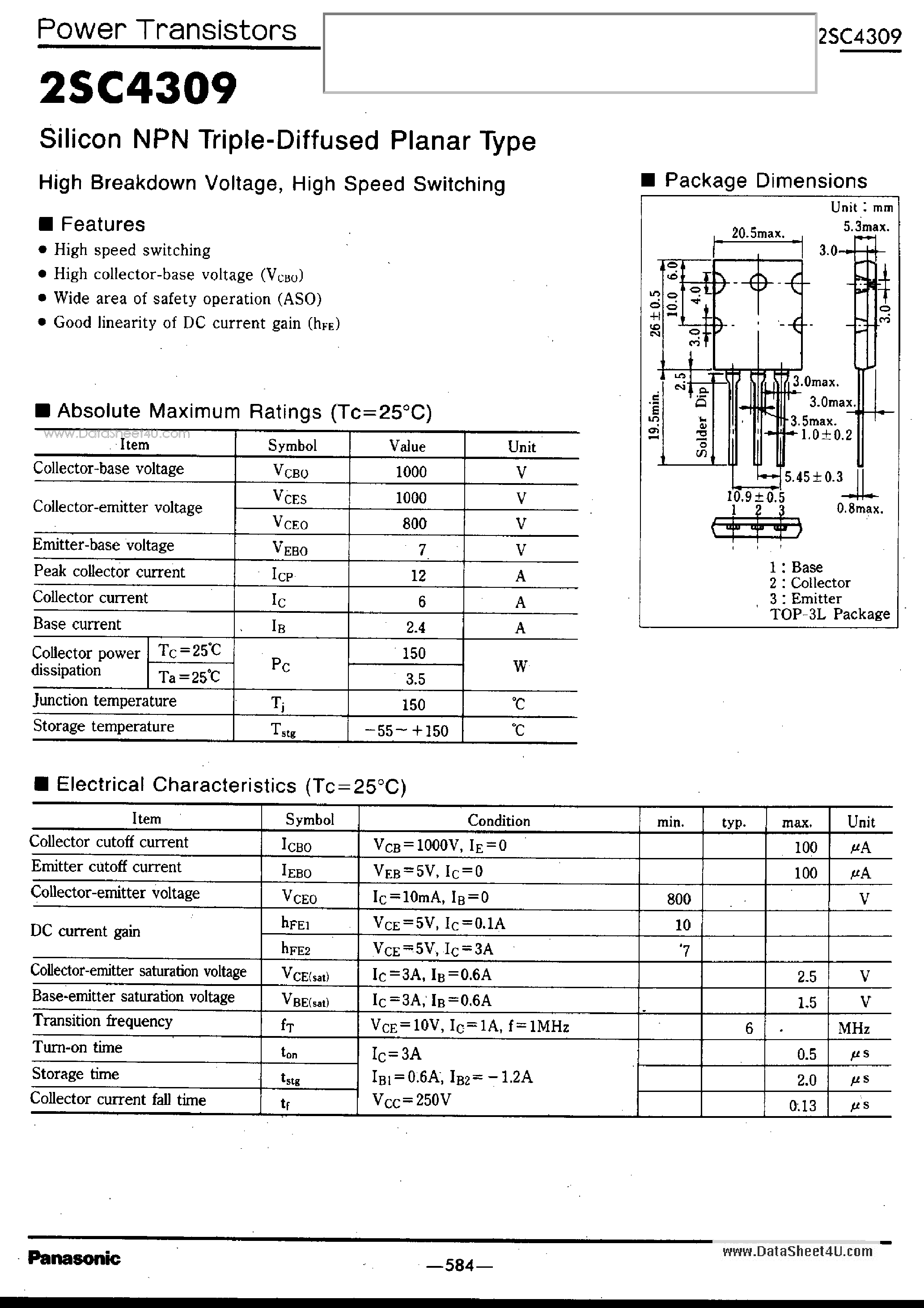

2SC4309-Silicon NPN Triple Diffused Planar Type Power Transistors
Producer:Panasonic
Description:Silicon NPN Triple Diffused Planar Type Power Transistors
Others with the same file: 2SC4309
Datasheet 2SC4309 - Silicon NPN Triple Diffused Planar Type Power Transistors page 1

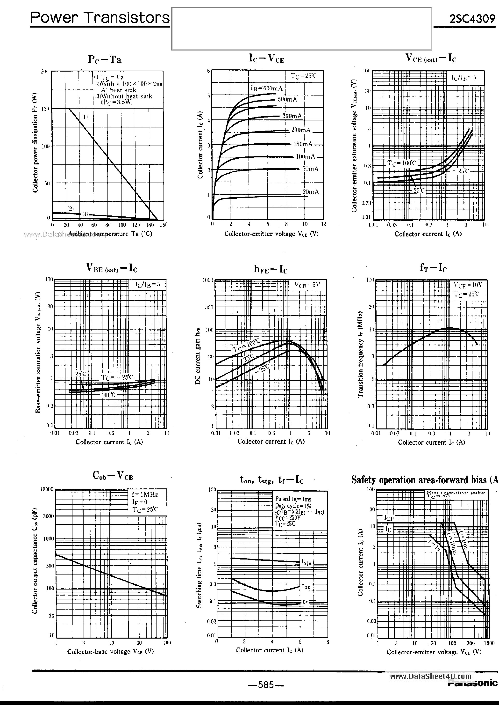

Datasheet 2SC4309 - Silicon NPN Triple Diffused Planar Type Power Transistors page 2
