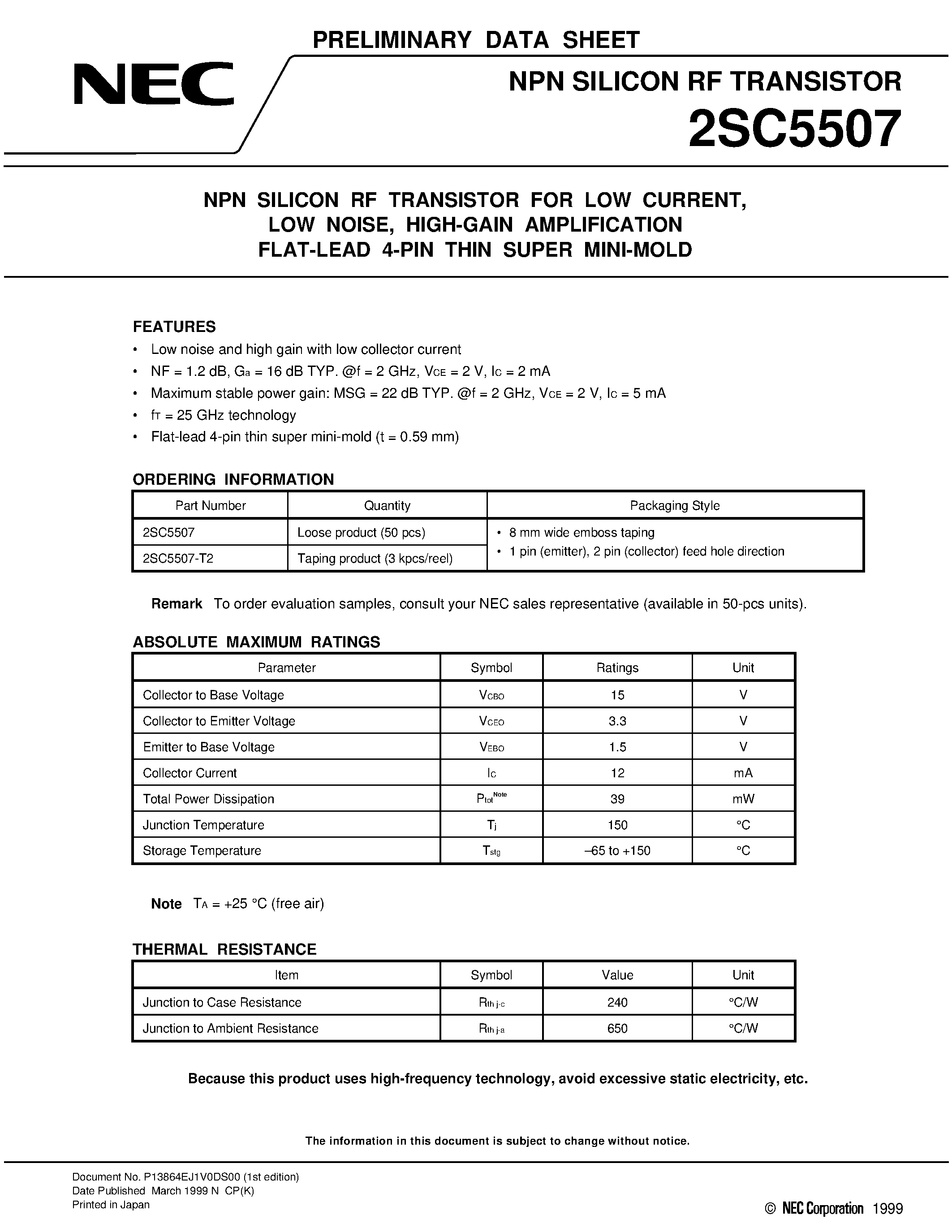

2SC5507-T2-NPN SILICON RF TRANSISTOR FOR LOW CURRENT/ LOW NOISE/ HIGH-GAIN AMPLIFICATION FLAT-LEAD 4-PIN THIN SUPER MINI-MOLD
Producer:NEC
Description:NPN SILICON RF TRANSISTOR FOR LOW CURRENT/ LOW NOISE/ HIGH-GAIN AMPLIFICATION FLAT-LEAD 4-PIN THIN SUPER MINI-MOLD
Others with the same file: 2SC5507-T2
Datasheet 2SC5507-T2 - NPN SILICON RF TRANSISTOR FOR LOW CURRENT/ LOW NOISE/ HIGH-GAIN AMPLIFICATION FLAT-LEAD 4-PIN THIN SUPER MINI-MOLD page 1

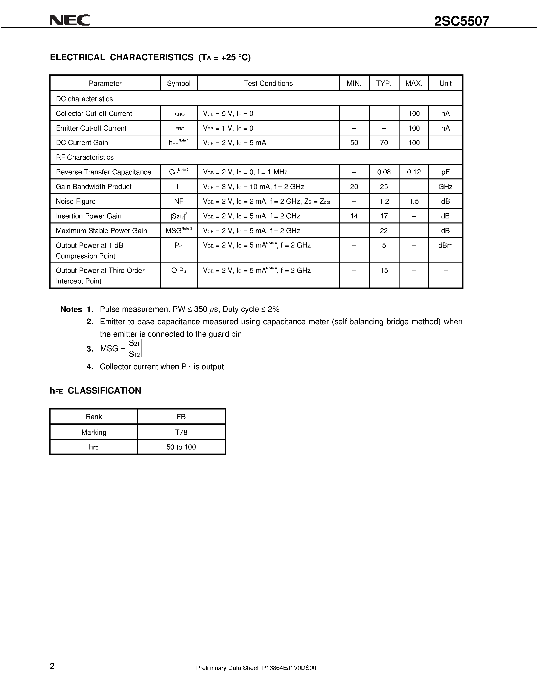

Datasheet 2SC5507-T2 - NPN SILICON RF TRANSISTOR FOR LOW CURRENT/ LOW NOISE/ HIGH-GAIN AMPLIFICATION FLAT-LEAD 4-PIN THIN SUPER MINI-MOLD page 2
