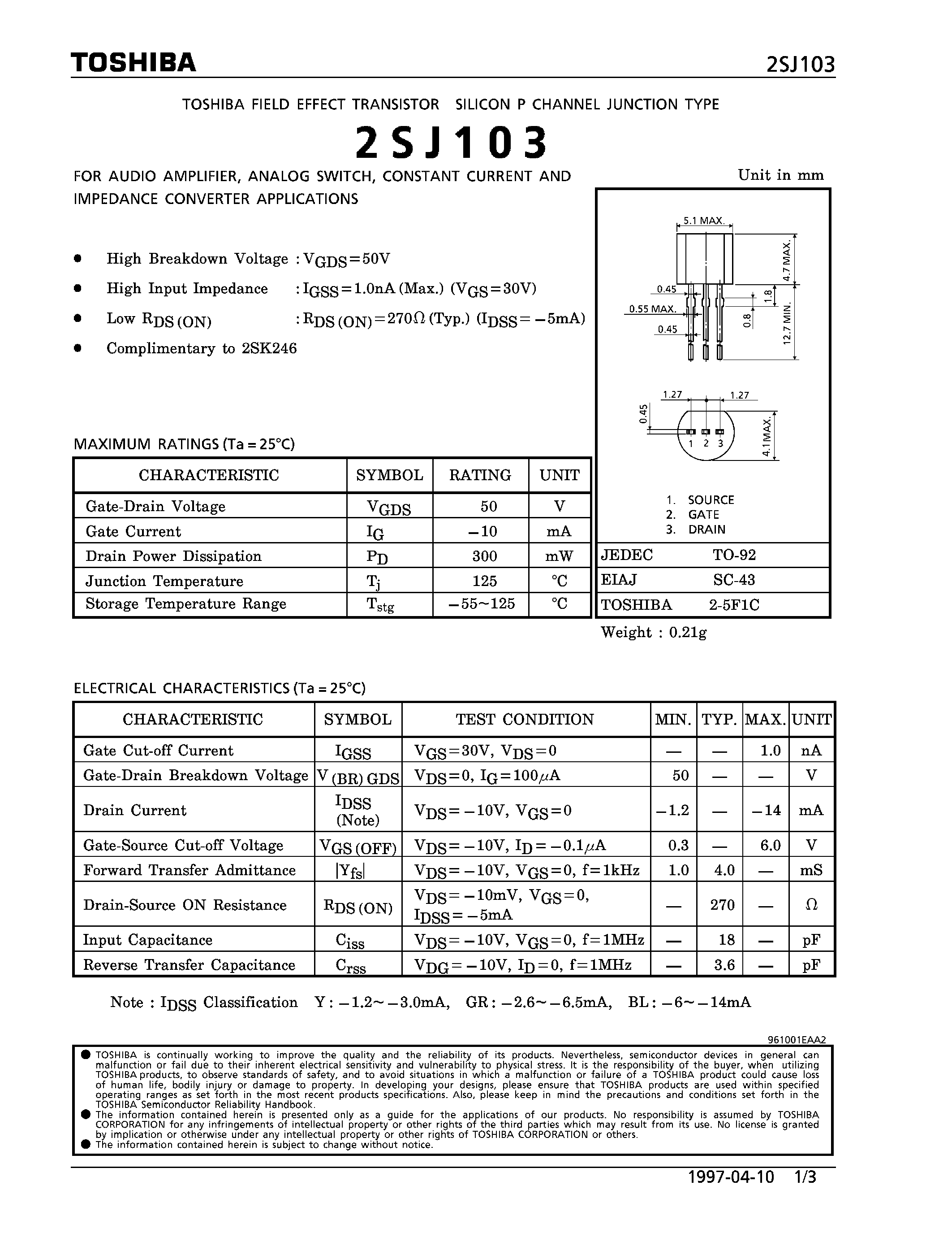

2SJ103-P CHANNEL JUNCTION TYPE (FOR AUDIO AMPLIFIER / ANALOG SWITCH/ CONSTANT CURRENT AND IMPEDANCE CONVERTER APPLICATIONS)
Description:P CHANNEL JUNCTION TYPE (FOR AUDIO AMPLIFIER / ANALOG SWITCH/ CONSTANT CURRENT AND IMPEDANCE CONVERTER APPLICATIONS)
Others with the same file: 2SJ103
Datasheet 2SJ103 - P CHANNEL JUNCTION TYPE (FOR AUDIO AMPLIFIER / ANALOG SWITCH/ CONSTANT CURRENT AND IMPEDANCE CONVERTER APPLICATIONS) page 1
