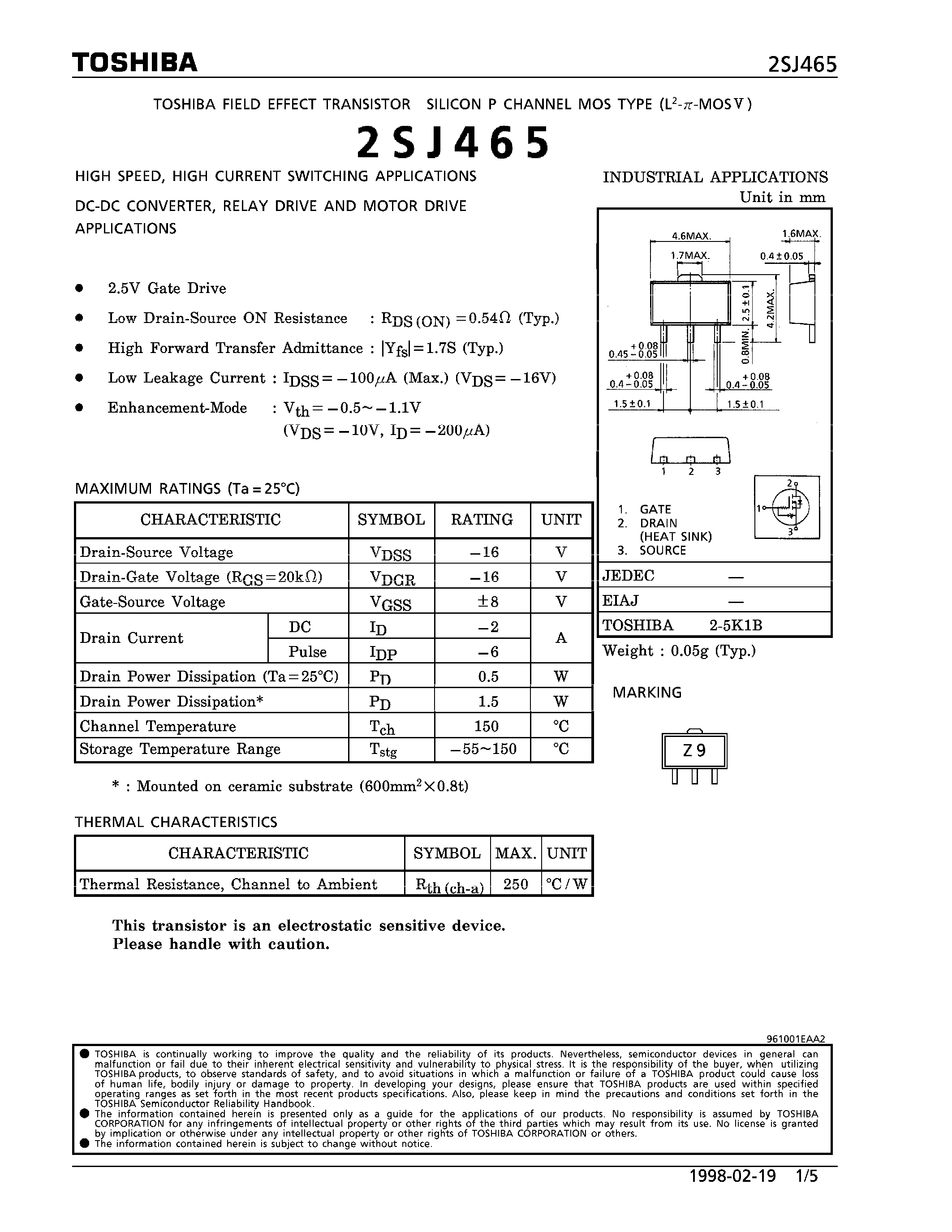

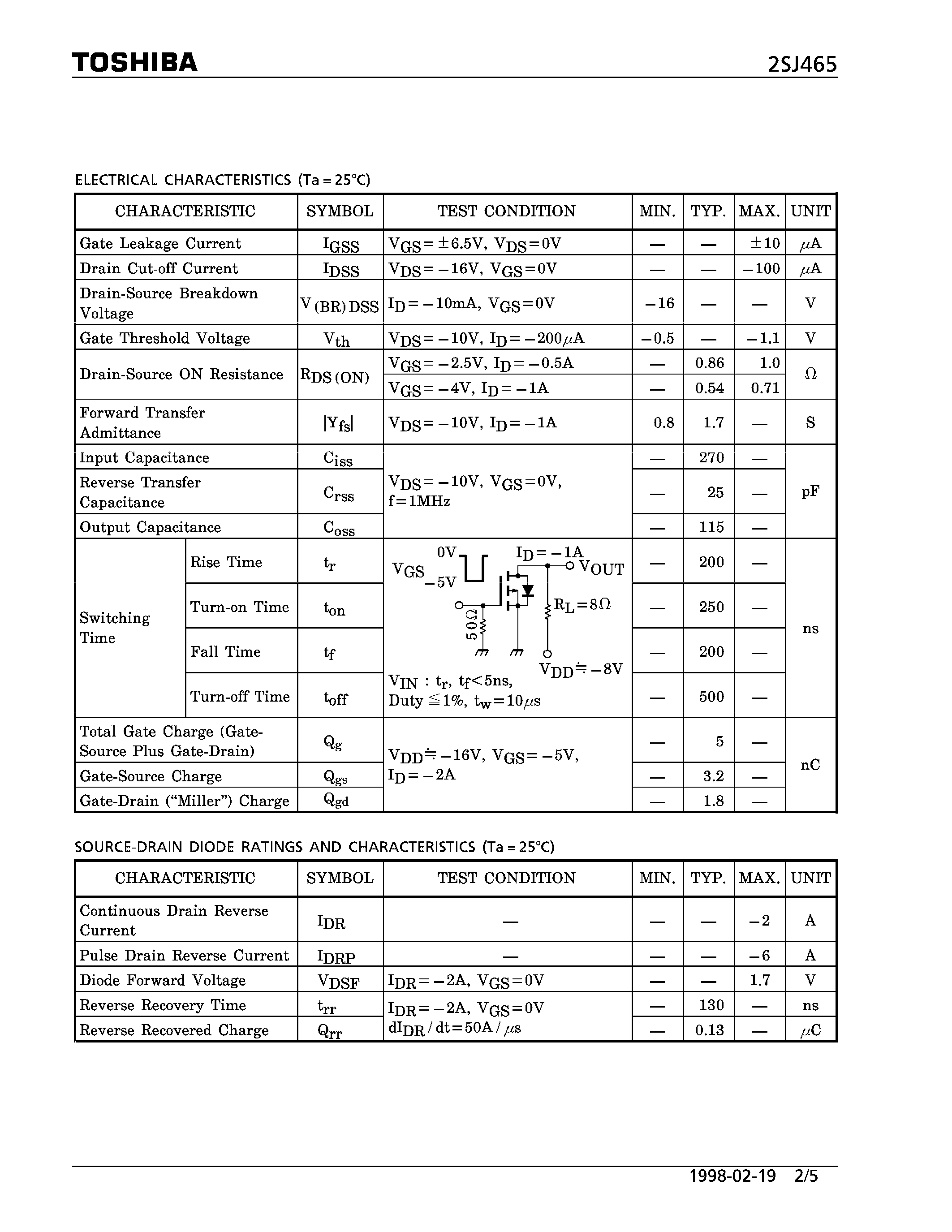

2SJ465-P CHANNEL MOS TYPE (HIGH SPEED/ HIGH CURRENT SWITCHING/ DC-DC CONVERTER/ RELAY DRIVE AND MOTOR DRIVE APPLICATIOS)
Description:P CHANNEL MOS TYPE (HIGH SPEED/ HIGH CURRENT SWITCHING/ DC-DC CONVERTER/ RELAY DRIVE AND MOTOR DRIVE APPLICATIOS)
