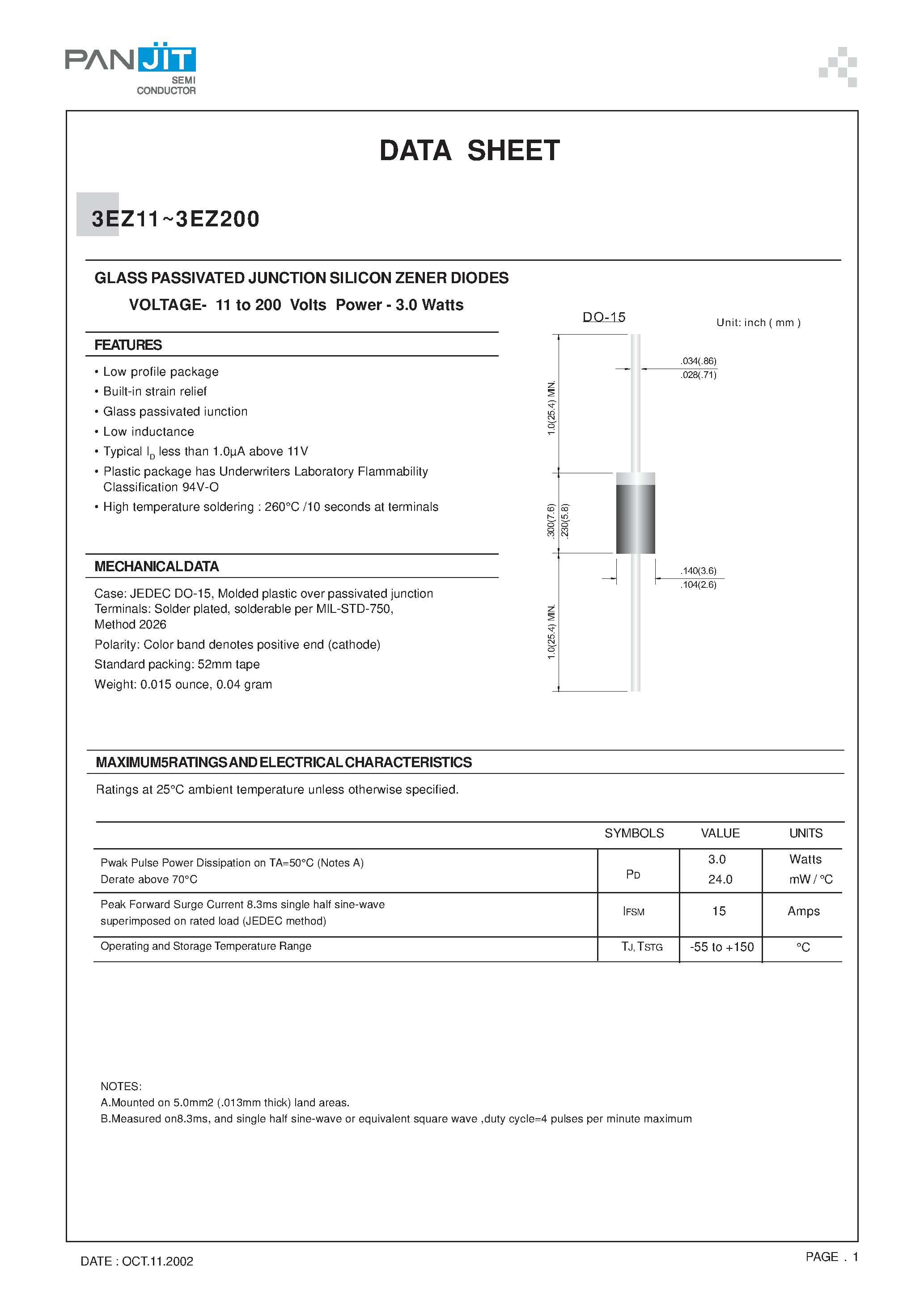

3EZ100-GLASS PASSIVATED JUNCTION SILICON ZENER DIODES(VOLTAGE- 11 to 200 Volts Power - 3.0 Watts)
Producer:Pan Jit International Inc.
Description:GLASS PASSIVATED JUNCTION SILICON ZENER DIODES(VOLTAGE- 11 to 200 Volts Power - 3.0 Watts)
Others with the same file: 3EZ100
Datasheet 3EZ100 - GLASS PASSIVATED JUNCTION SILICON ZENER DIODES(VOLTAGE- 11 to 200 Volts Power - 3.0 Watts) page 1

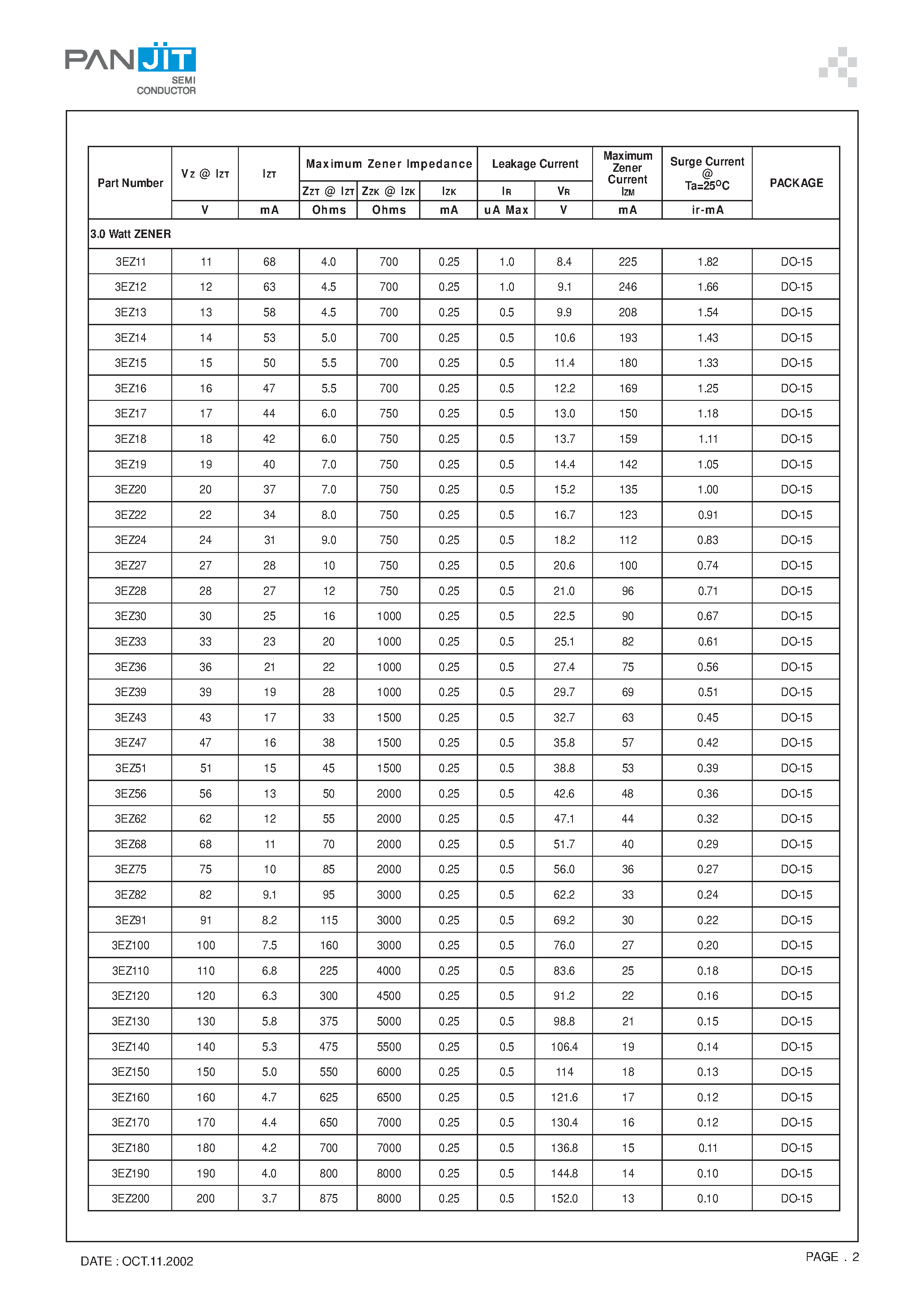

Datasheet 3EZ100 - GLASS PASSIVATED JUNCTION SILICON ZENER DIODES(VOLTAGE- 11 to 200 Volts Power - 3.0 Watts) page 2
