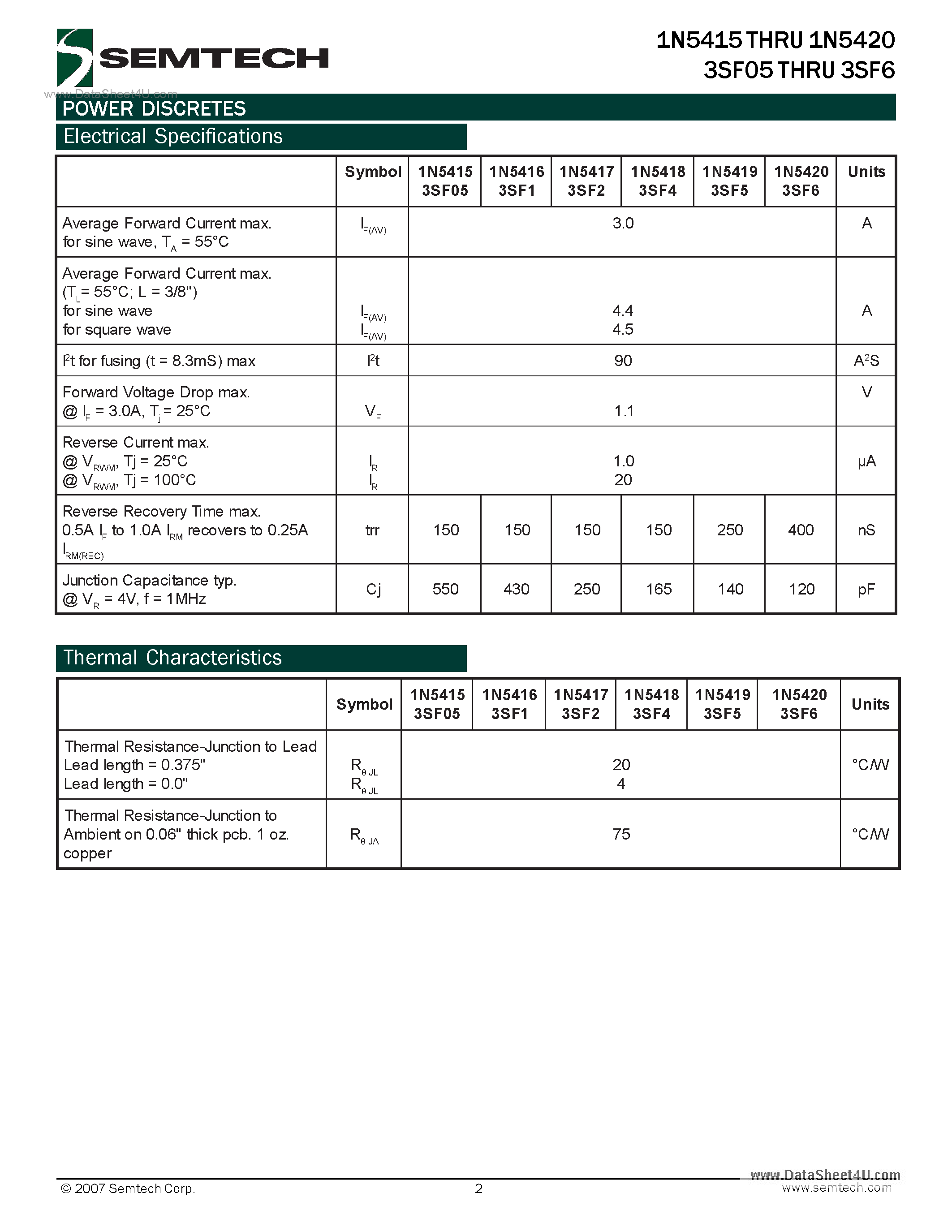

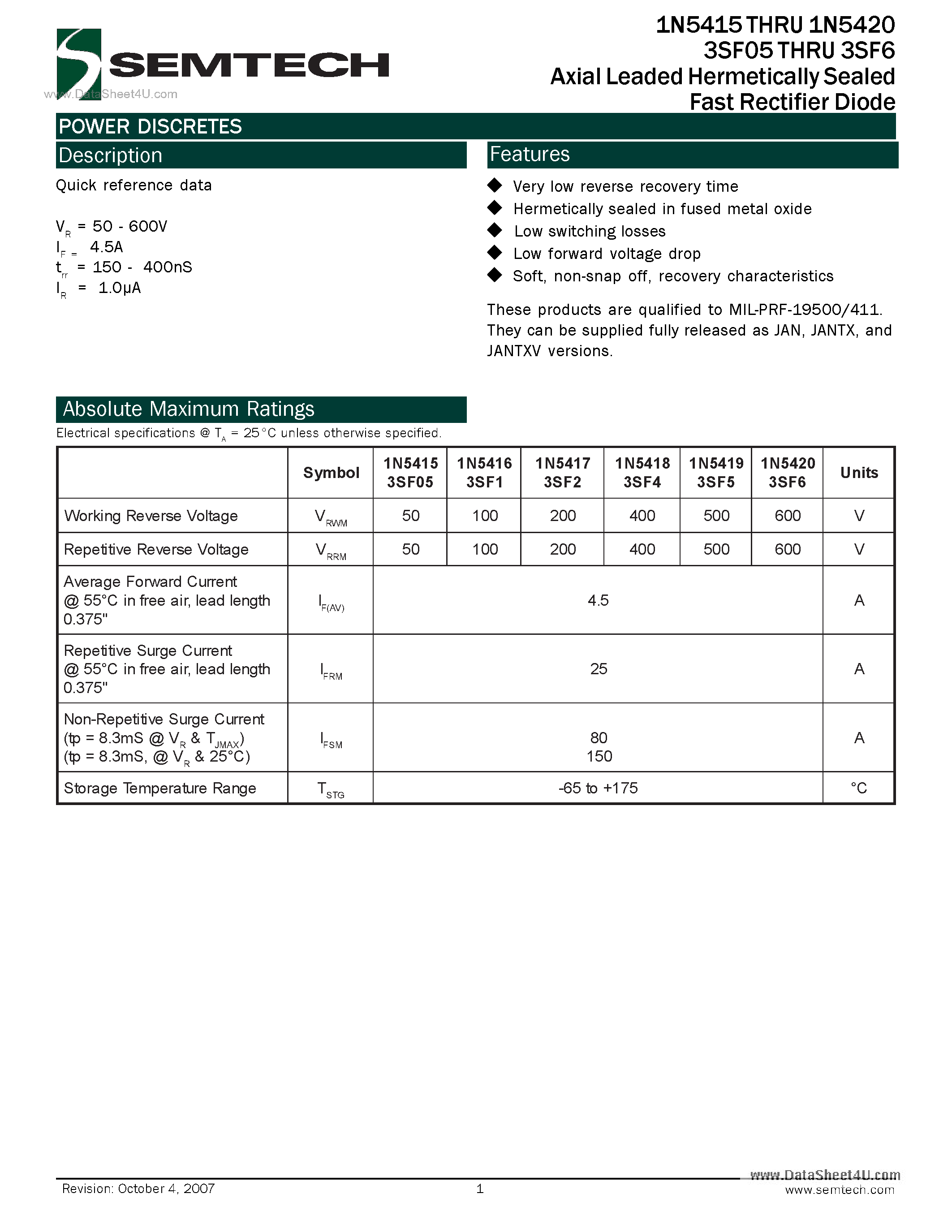

3SF05-(3SF05 - 3SF6) Axial Leaded Hermetically Sealed Fast Rectifier Diode
Producer:Semtech Corporation
Description:(3SF05 - 3SF6) Axial Leaded Hermetically Sealed Fast Rectifier Diode
