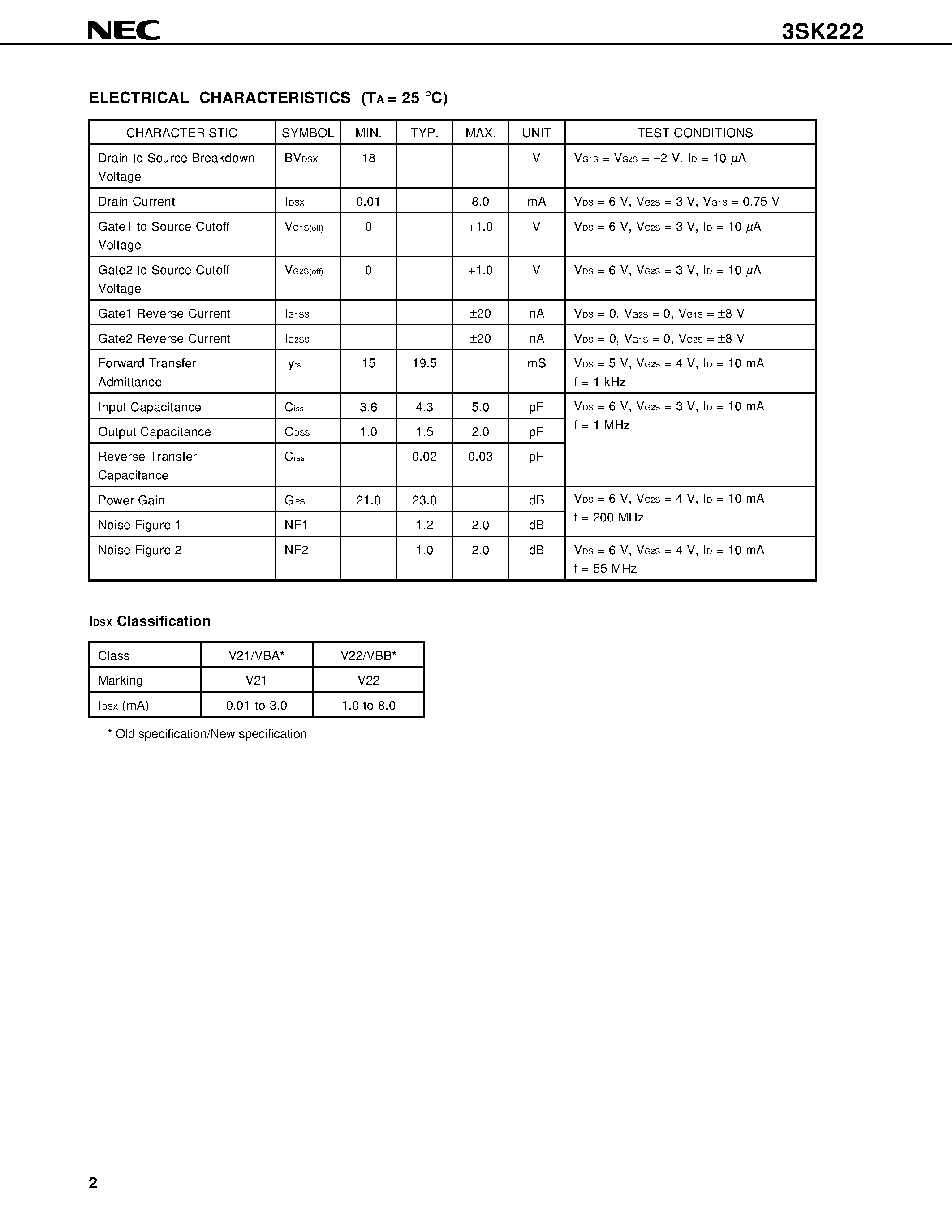

Datasheet 3SK222 - RF AMPLIFIER FOR FM TUNER AND VHF TV TUNER N-CHANNEL Si DUAL GATE MOS FIELD-EFFECT TRANSISTOR 4 PINS MINI MOLD page 2
