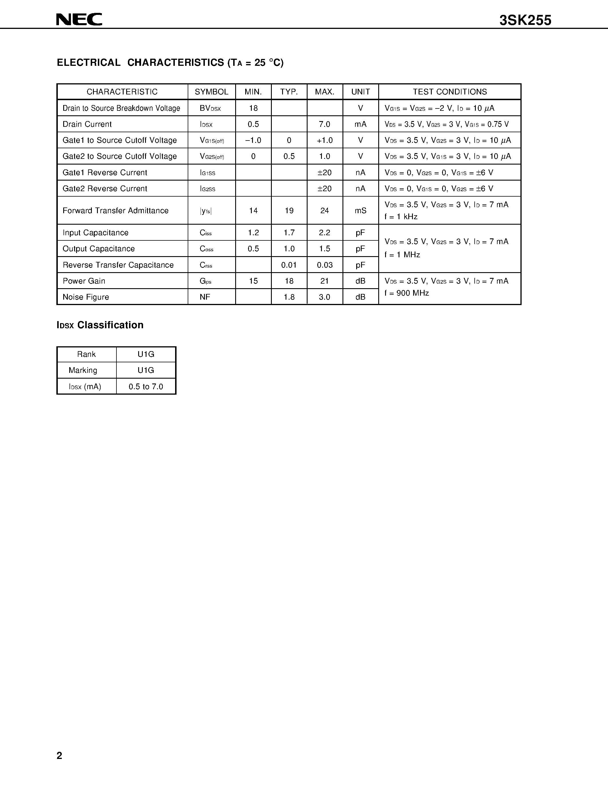

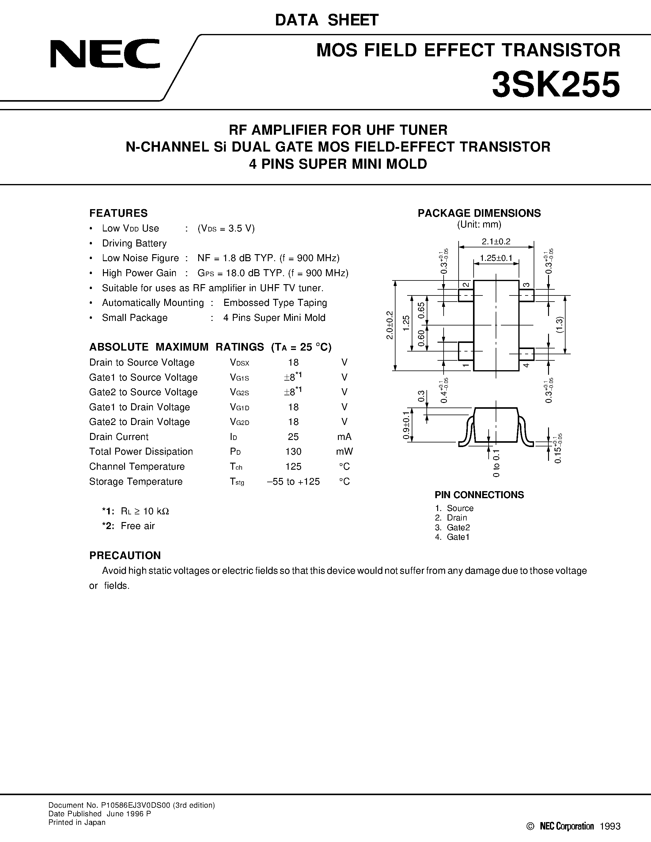

3SK255-RF AMPLIFIER FOR UHF TUNER N-CHANNEL Si DUAL GATE MOS FIELD-EFFECT TRANSISTOR 4 PINS SUPER MINI MOLD
Producer:NEC
Description:RF AMPLIFIER FOR UHF TUNER N-CHANNEL Si DUAL GATE MOS FIELD-EFFECT TRANSISTOR 4 PINS SUPER MINI MOLD
Others with the same file: 3SK255
Datasheet 3SK255 - RF AMPLIFIER FOR UHF TUNER N-CHANNEL Si DUAL GATE MOS FIELD-EFFECT TRANSISTOR 4 PINS SUPER MINI MOLD page 1
Datasheet 3SK255 - RF AMPLIFIER FOR UHF TUNER N-CHANNEL Si DUAL GATE MOS FIELD-EFFECT TRANSISTOR 4 PINS SUPER MINI MOLD page 2
