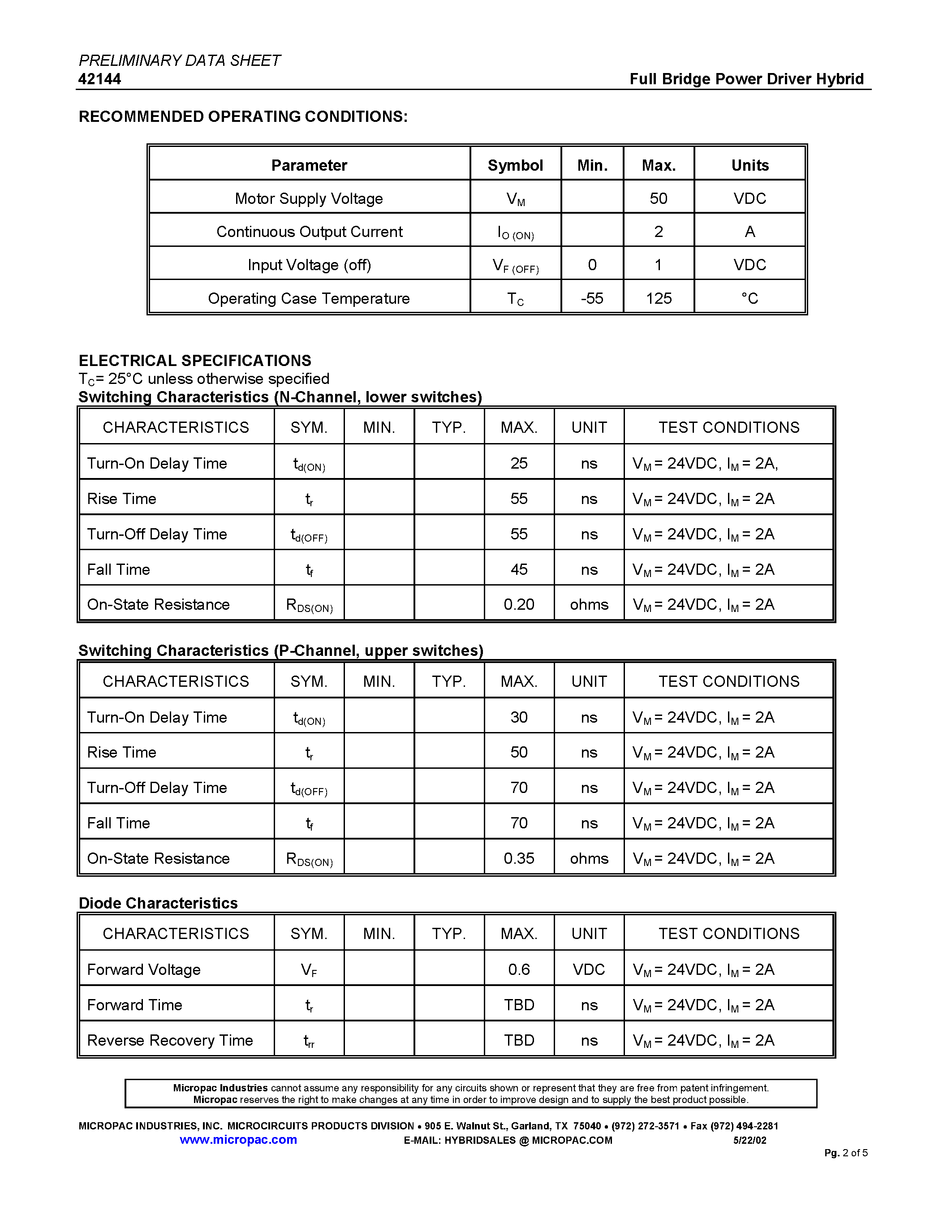

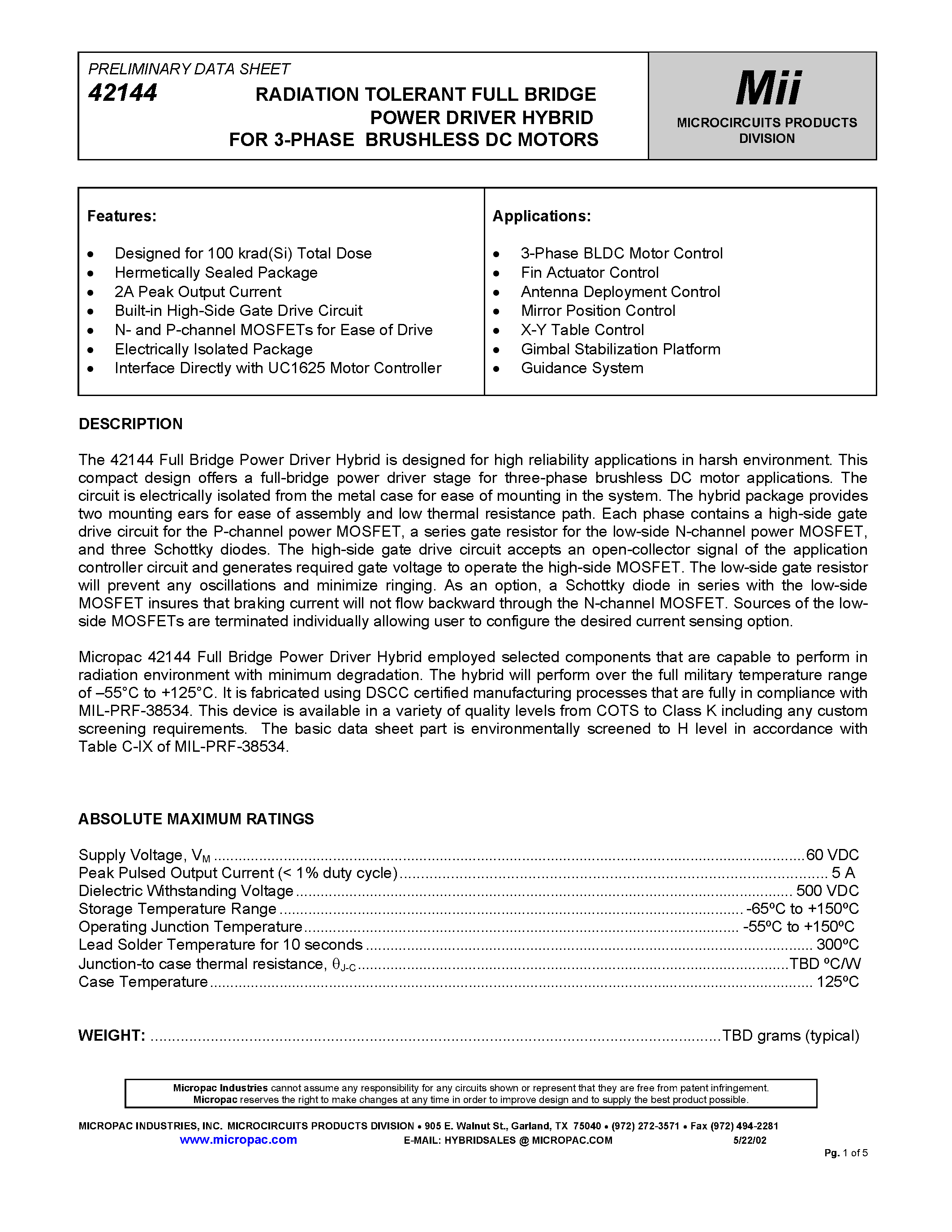

42144-RADIATION TOLERANT FULL BRIDGE POWER DRIVER HYBRID FOR 3-PHASE BRUSHLESS DC MOTORS
Producer:Micropac Industries
Description:RADIATION TOLERANT FULL BRIDGE POWER DRIVER HYBRID FOR 3-PHASE BRUSHLESS DC MOTORS
Others with the same file: 42144
Datasheet 42144 - RADIATION TOLERANT FULL BRIDGE POWER DRIVER HYBRID FOR 3-PHASE BRUSHLESS DC MOTORS page 1
Datasheet 42144 - RADIATION TOLERANT FULL BRIDGE POWER DRIVER HYBRID FOR 3-PHASE BRUSHLESS DC MOTORS page 2
