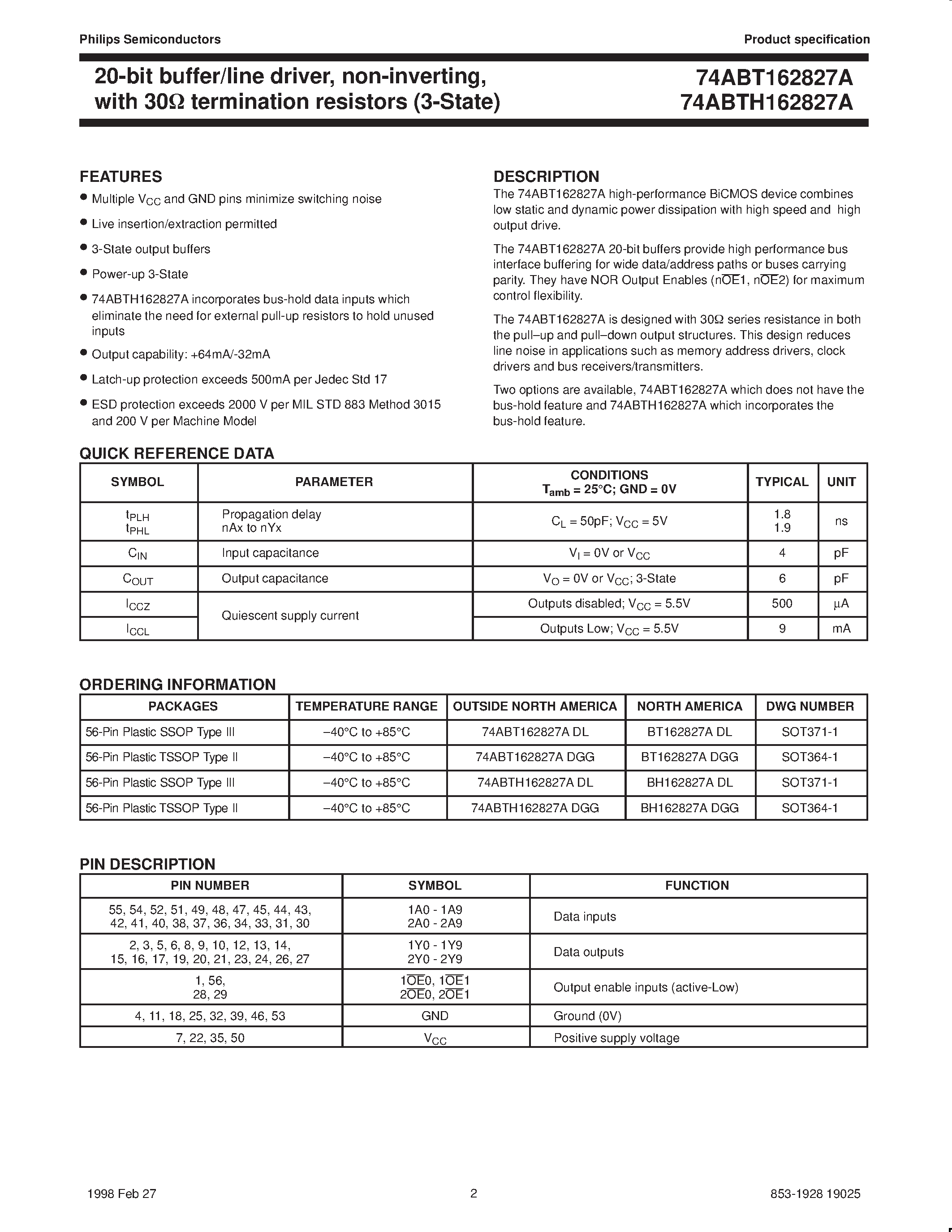

74ABT162827ADGG-20-bit buffer/line driver/ non-inverting/with 30ohm termination resistors (3-State)
Description:20-bit buffer/line driver/ non-inverting/with 30ohm termination resistors (3-State)
Others with the same file: 74ABT162827ADGG
Datasheet 74ABT162827ADGG - 20-bit buffer/line driver/ non-inverting/with 30ohm termination resistors (3-State) page 1
Datasheet 74ABT162827ADGG - 20-bit buffer/line driver/ non-inverting/with 30ohm termination resistors (3-State) page 2
