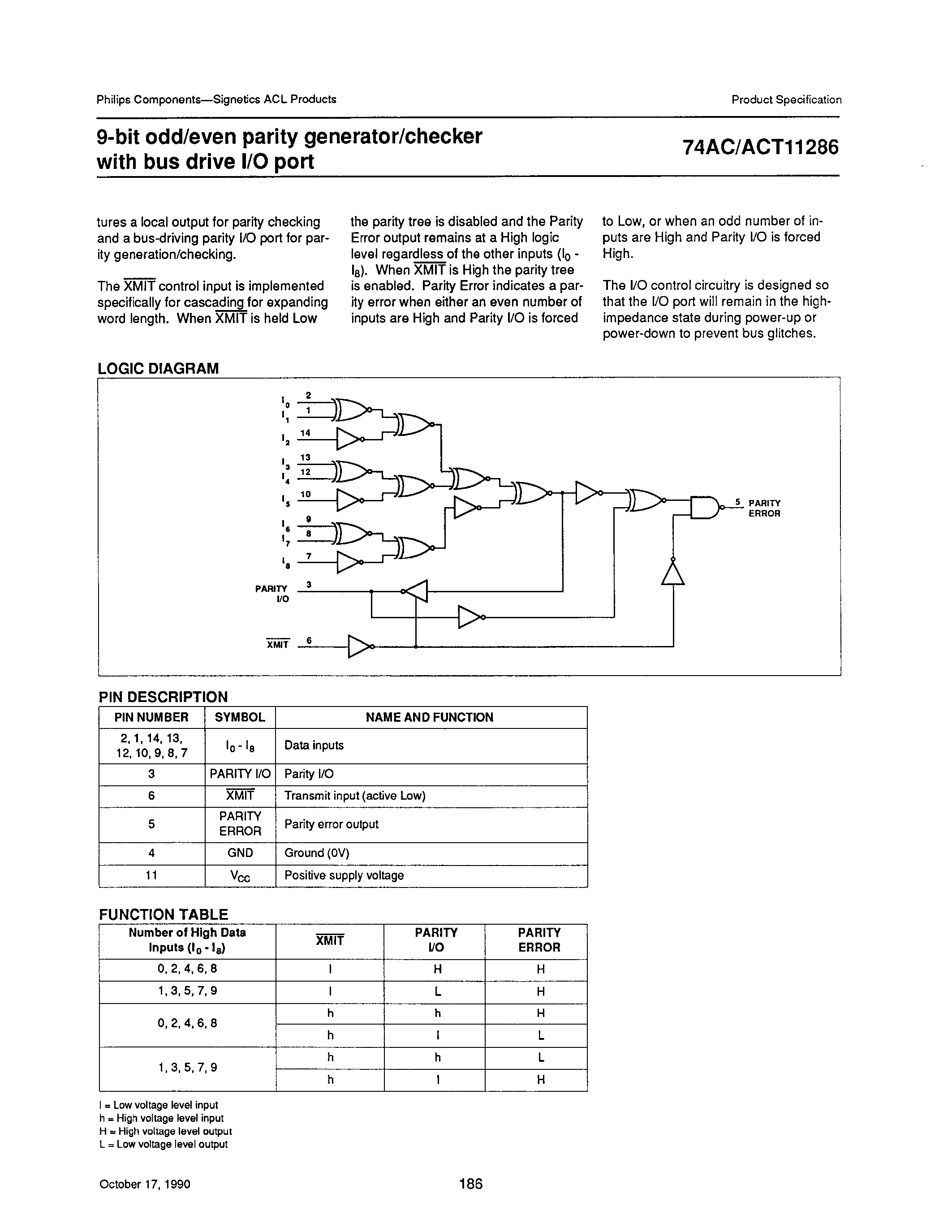

74AC11286-9-bit odd/even parity generator/checker with bus drive l/O port
Description:9-bit odd/even parity generator/checker with bus drive l/O port
Others with the same file: 74AC11286
Datasheet 74AC11286 - 9-bit odd/even parity generator/checker with bus drive l/O port page 1
Datasheet 74AC11286 - 9-bit odd/even parity generator/checker with bus drive l/O port page 2
