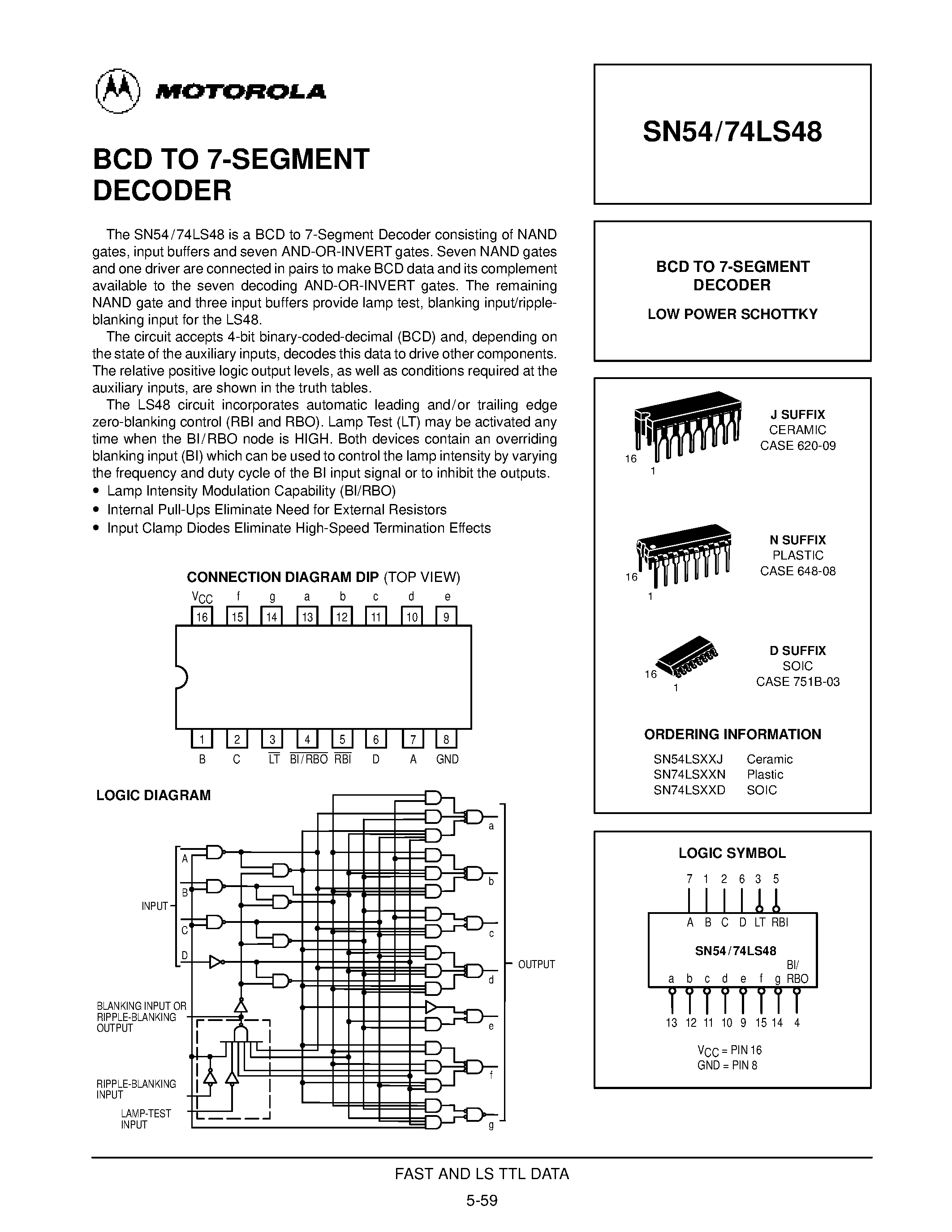

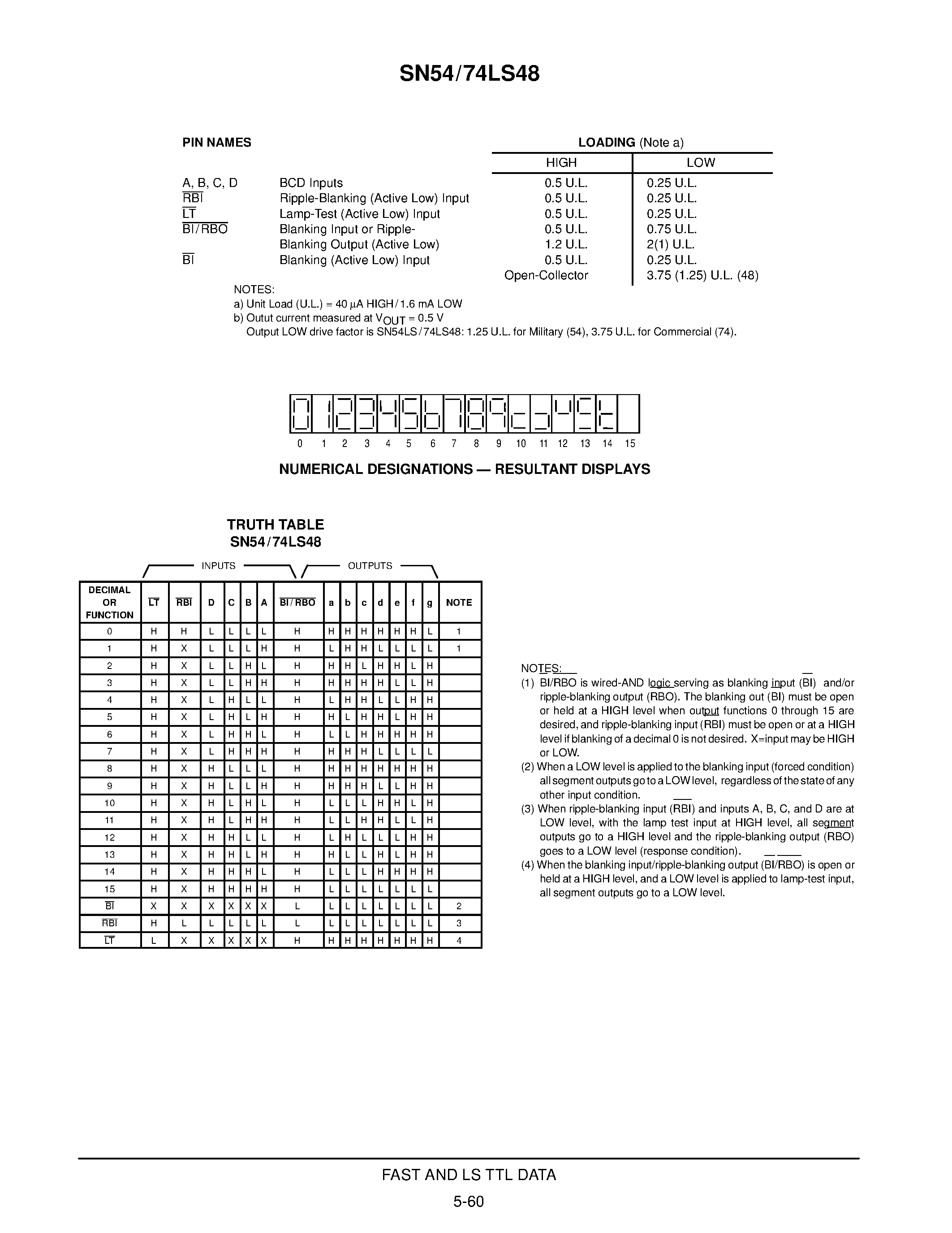

74LS48-BCD TO 7-SEGMENT DECODER
Producer:Motorola
Description:BCD TO 7-SEGMENT DECODER
Others with the same file: 74LS48
Datasheet 74LS48 - BCD TO 7-SEGMENT DECODER page 1
Datasheet 74LS48 - BCD TO 7-SEGMENT DECODER page 2
