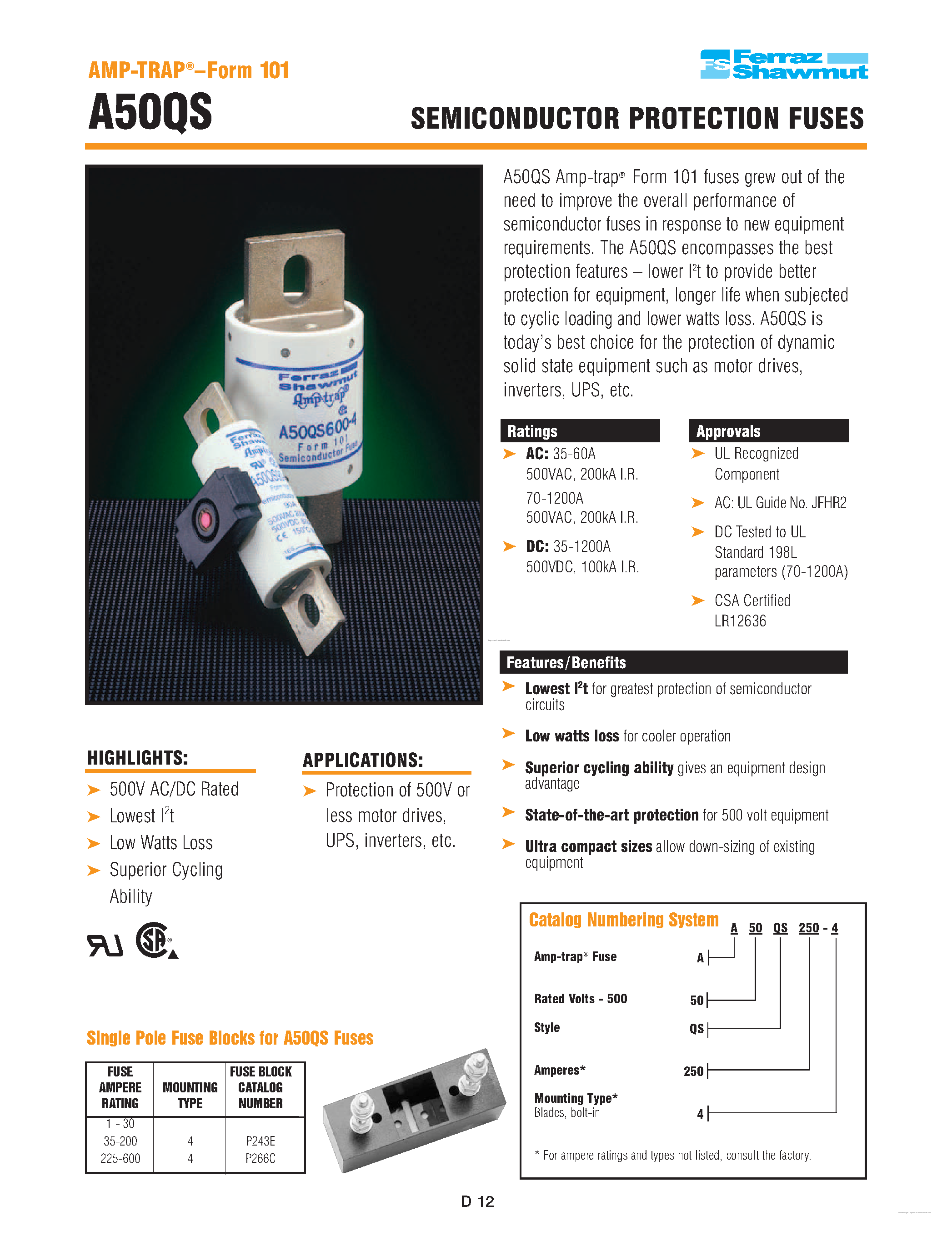

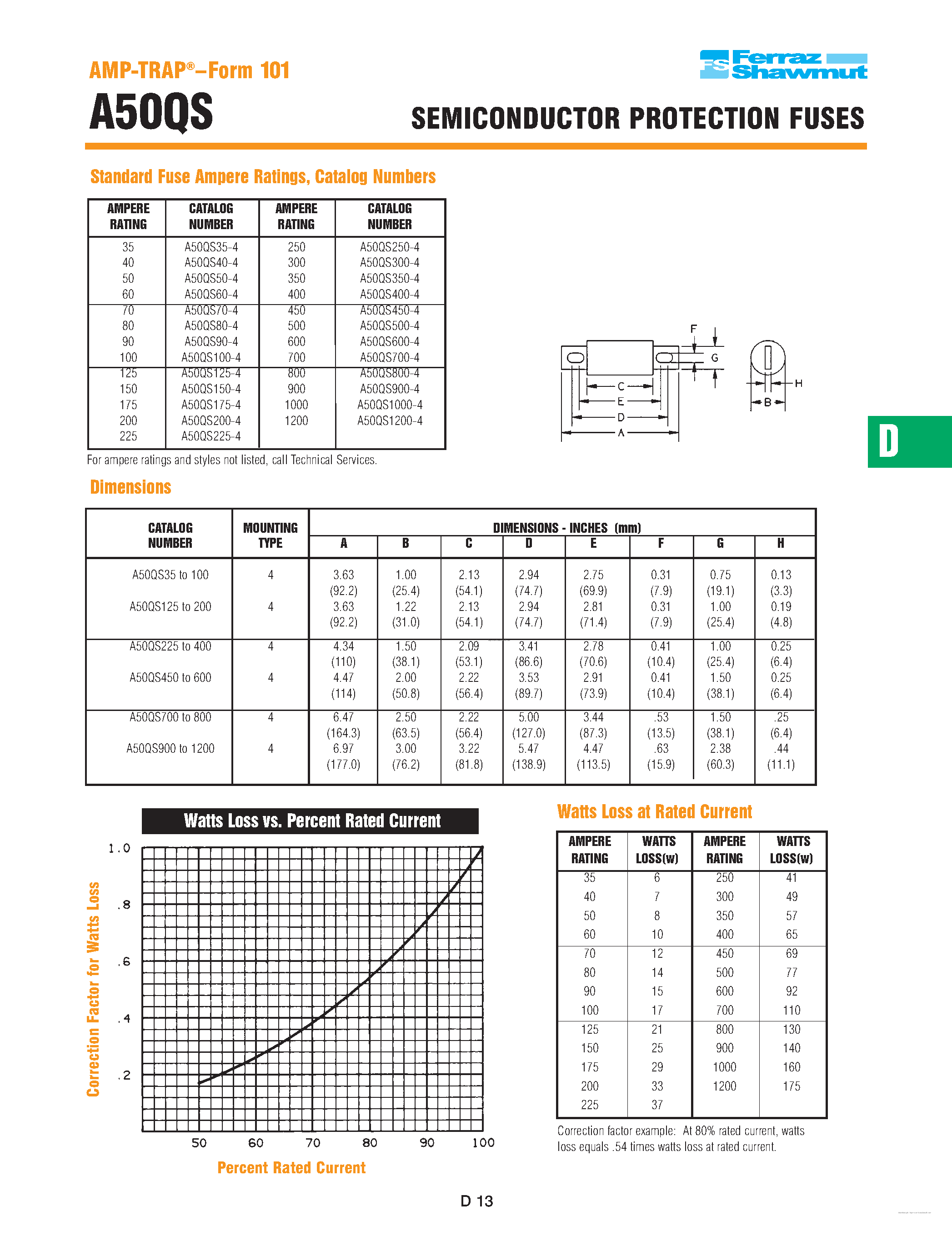

A50QS-
Producer:Ferraz Shawmut
Description:
Others with the same file: A50QS | A50QS100-4
A50QS1000-4 | A50QS1200-4
A50QS125-4 | A50QS150-4
A50QS175-4 | A50QS200-4
A50QS225-4 | A50QS250-4
A50QS300-4 | A50QS35-4
A50QS350-4 | A50QS40-4
A50QS400-4 | A50QS450-4
A50QS50-4 | A50QS500-4
A50QS60-4 | A50QS600-4
A50QS70-4 | A50QS700-4
A50QS80-4 | A50QS800-4
A50QS90-4 | A50QS900-4
Datasheet A50QS - page 1
Datasheet A50QS - page 2
