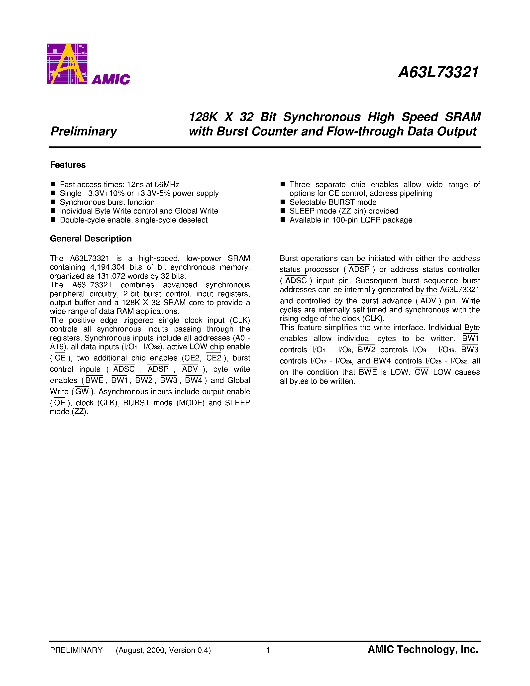

Description:128K X 32 Bit Synchronous High Speed SRAM with Burst Counter and Flow-through Data Output
