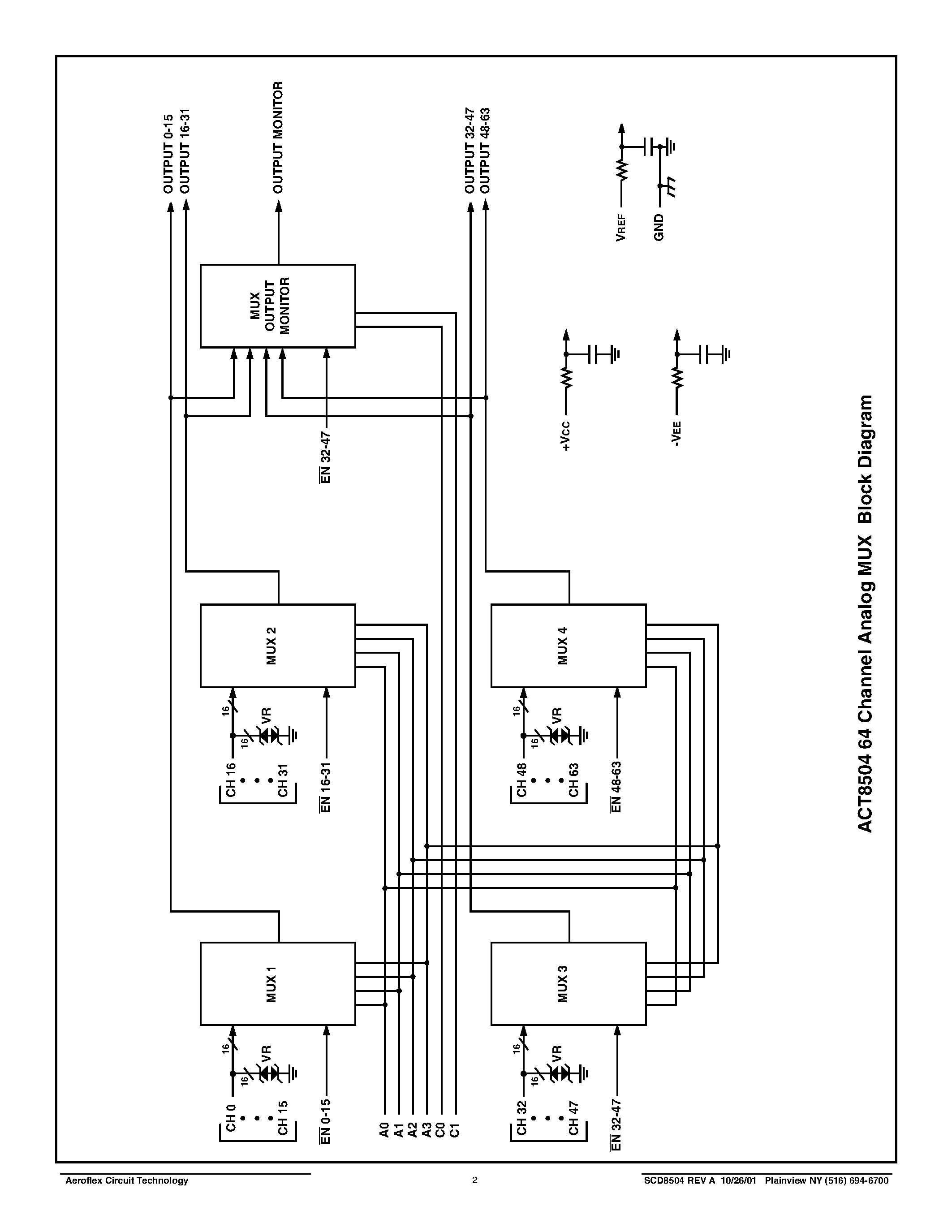

ACT8504-C-ACT8504 Radiation Hardened & ESD Protected 64-Channel Analog Multiplexer Module With MUX Output Monitor Function
Producer:Aeroflex Circuit Technology
Description:ACT8504 Radiation Hardened & ESD Protected 64-Channel Analog Multiplexer Module With MUX Output Monitor Function
