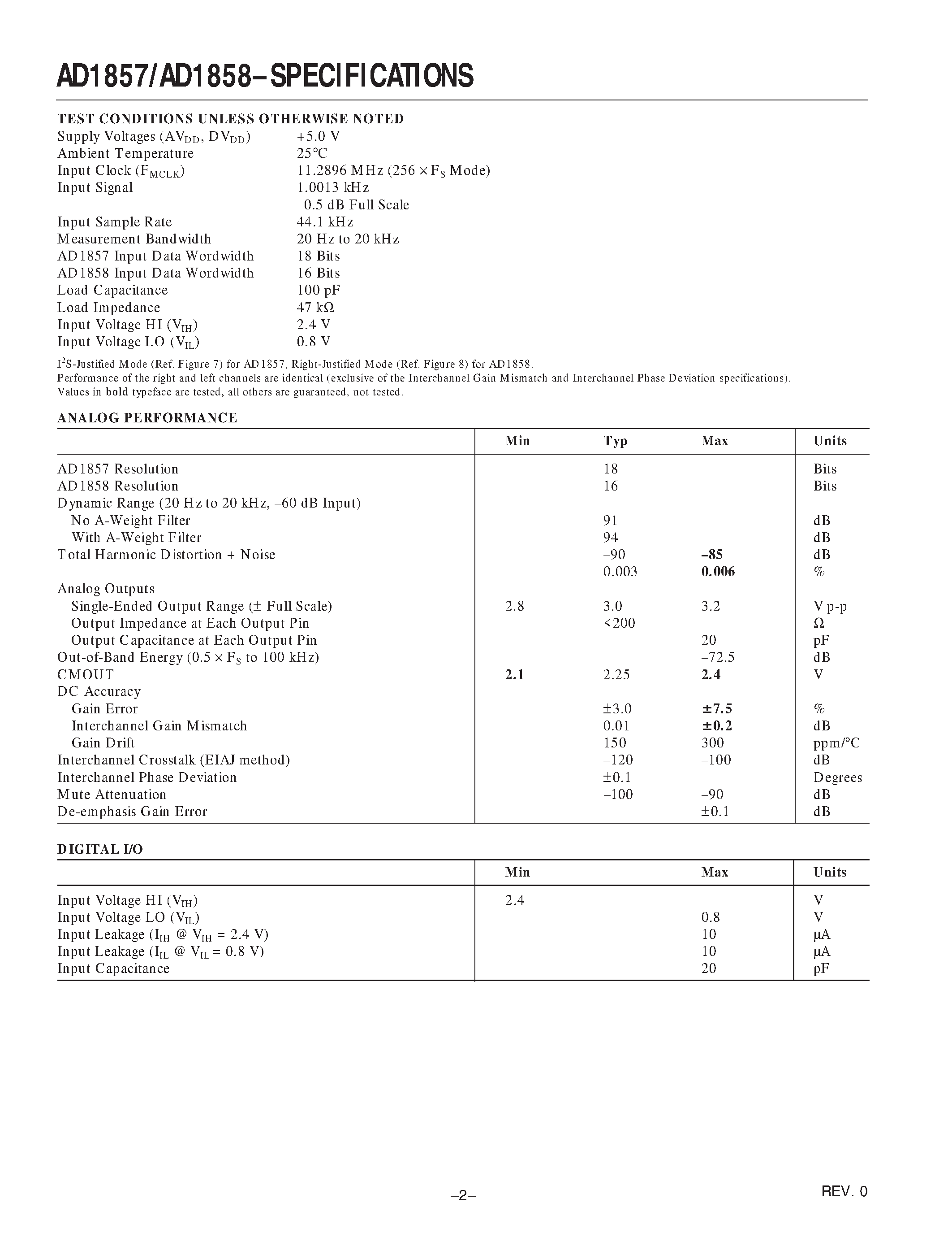

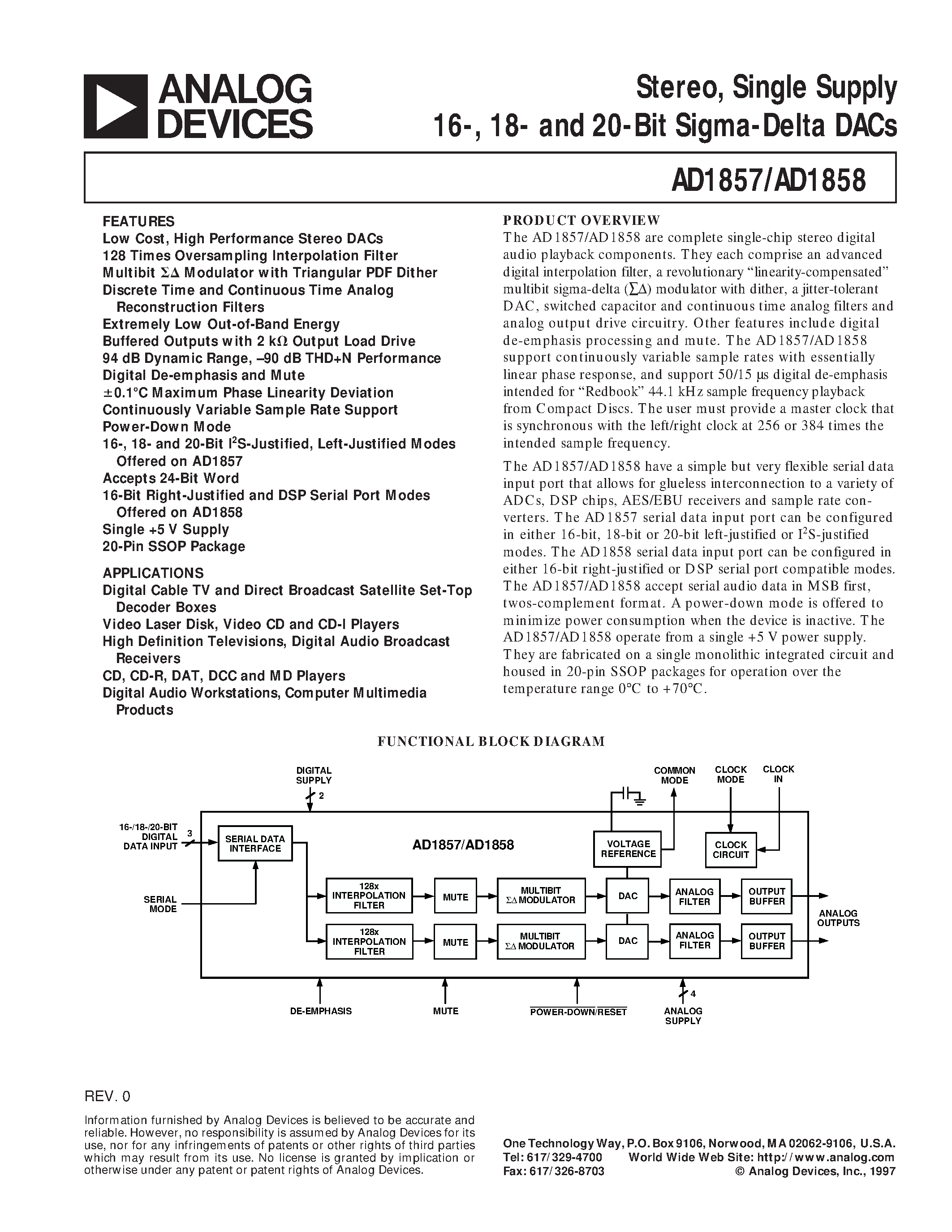

AD1857JRSRL-Stereo/ Single Supply 16-/ 18- and 20-Bit Sigma-Delta DACs
Producer:Analog Devices
Description:Stereo/ Single Supply 16-/ 18- and 20-Bit Sigma-Delta DACs
