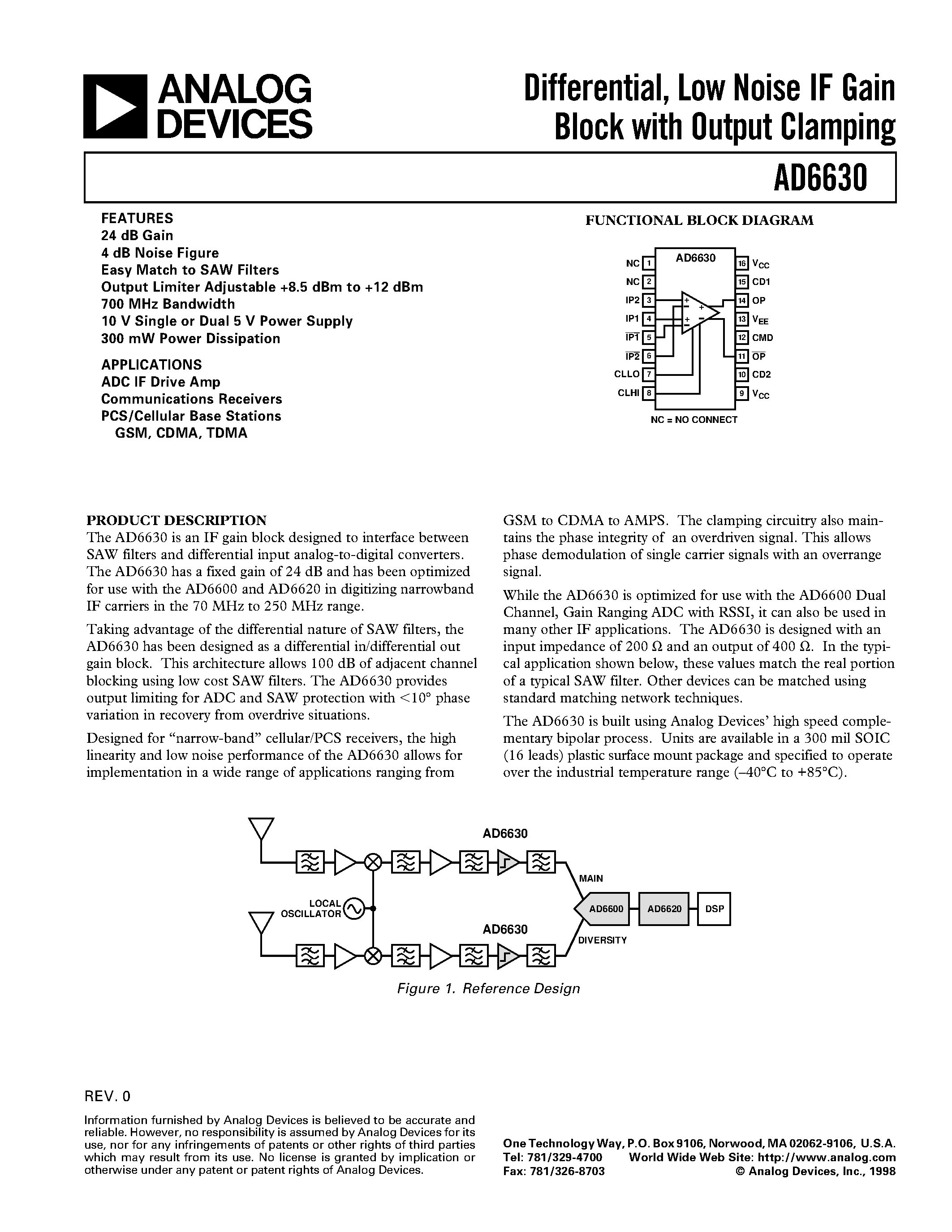

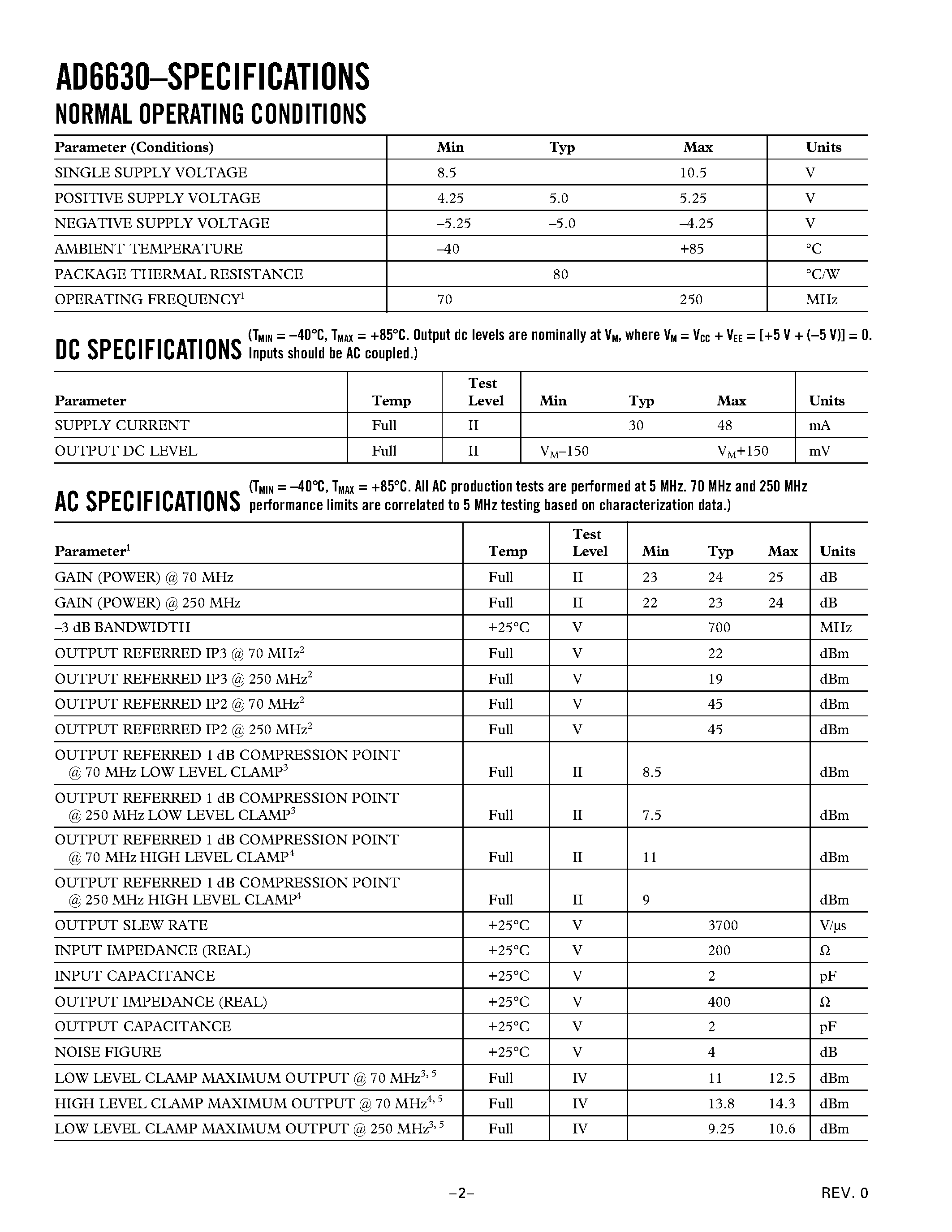

AD6630-Differential/ Low Noise IF Gain Block with Output Clamping
Producer:Analog Devices
Description:Differential/ Low Noise IF Gain Block with Output Clamping
Others with the same file: AD6630
Datasheet AD6630 - Differential/ Low Noise IF Gain Block with Output Clamping page 1
Datasheet AD6630 - Differential/ Low Noise IF Gain Block with Output Clamping page 2
