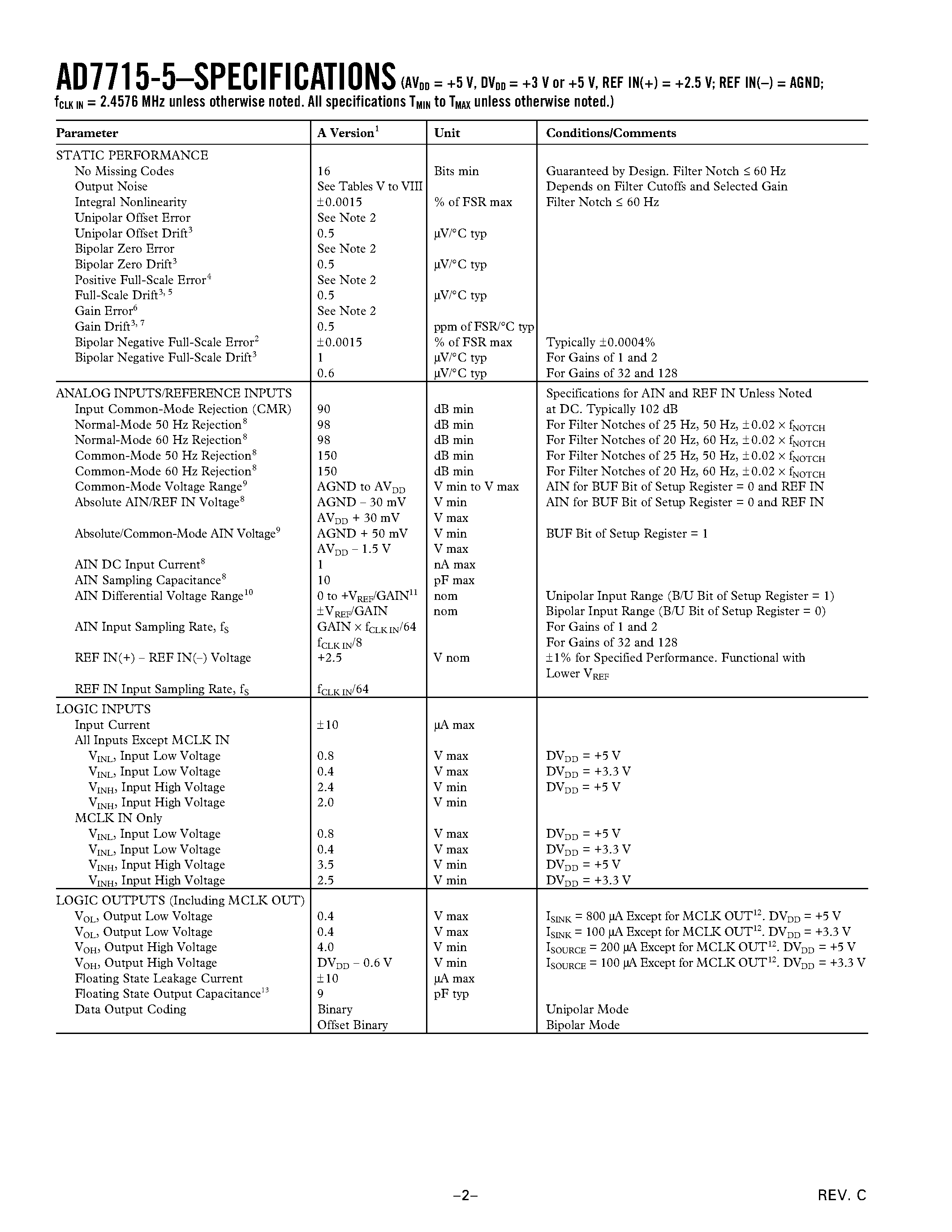

Datasheet AD7715 - 3 V/5 V/ 450 uA 16-Bit/ Sigma-Delta ADC page 2
