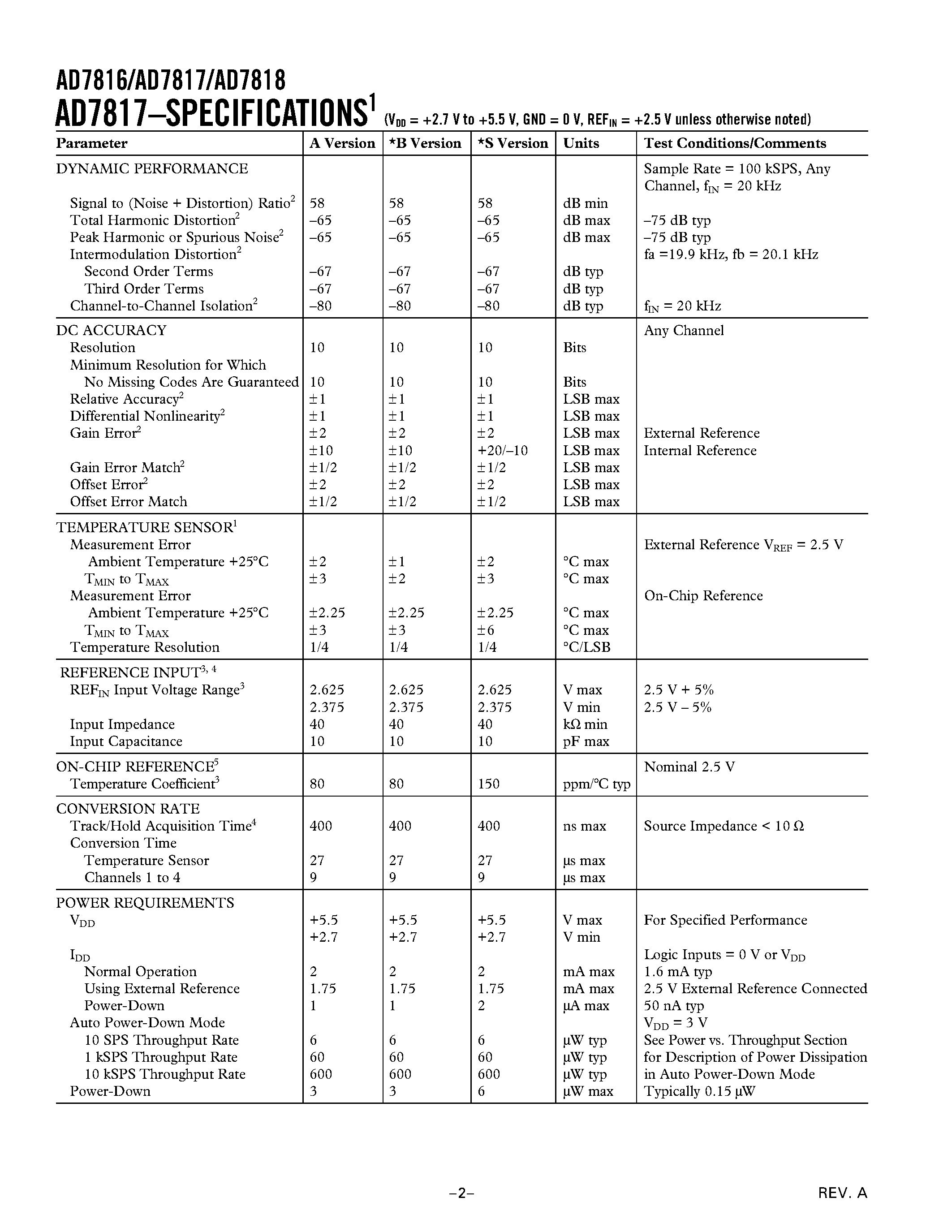

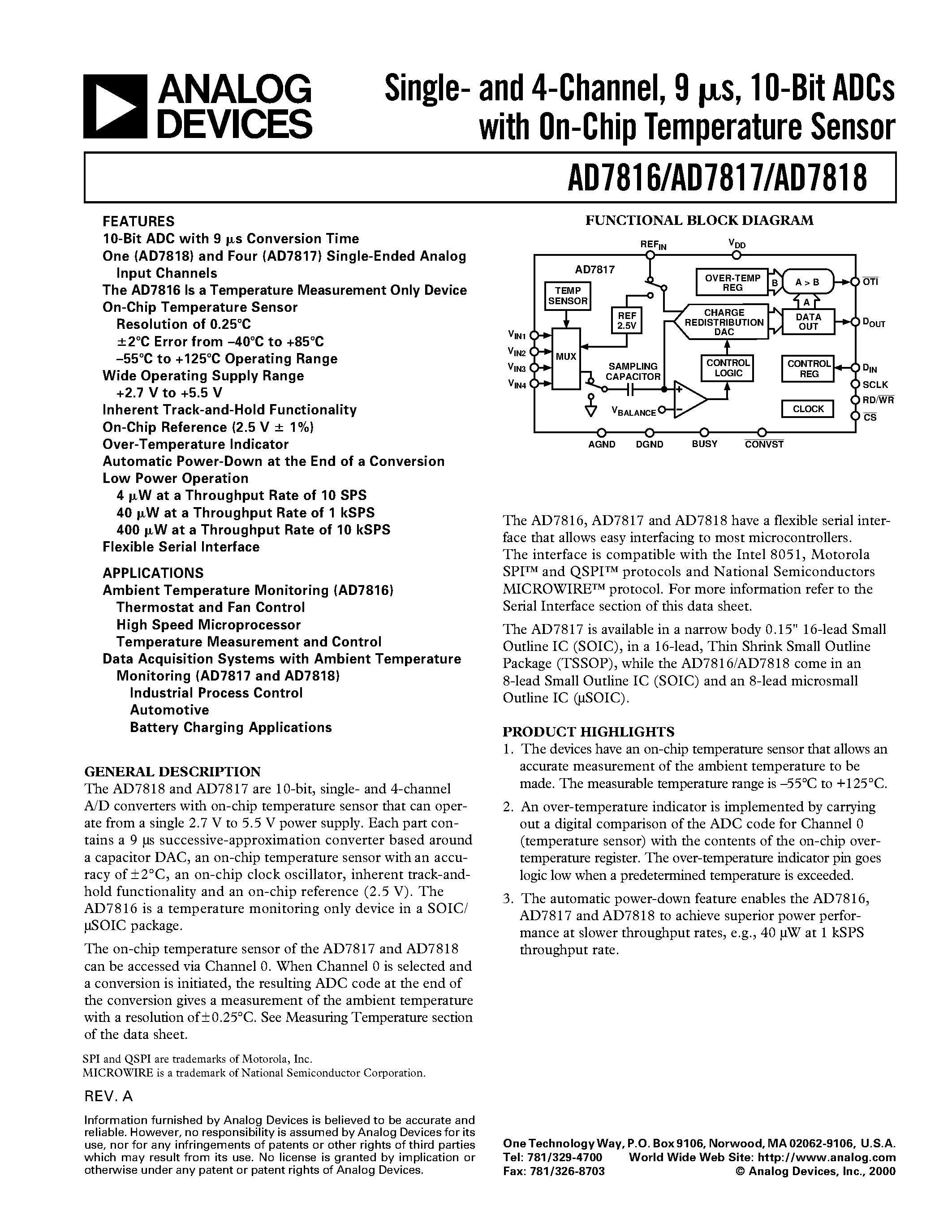

AD7817-Single- and 4-Channel/ 9 us/ 10-Bit ADCs with On-Chip Temperature Sensor
Producer:Analog Devices
Description:Single- and 4-Channel/ 9 us/ 10-Bit ADCs with On-Chip Temperature Sensor
