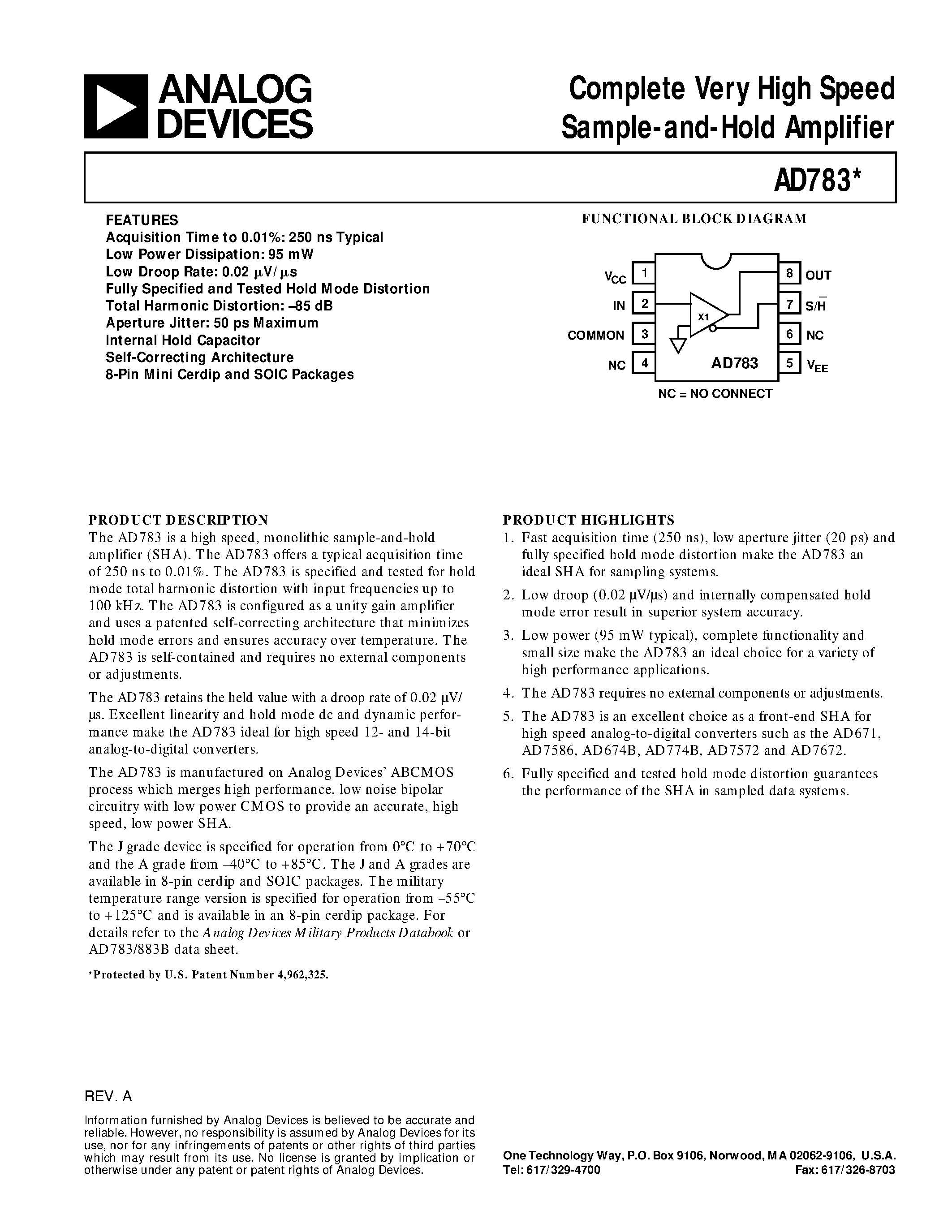

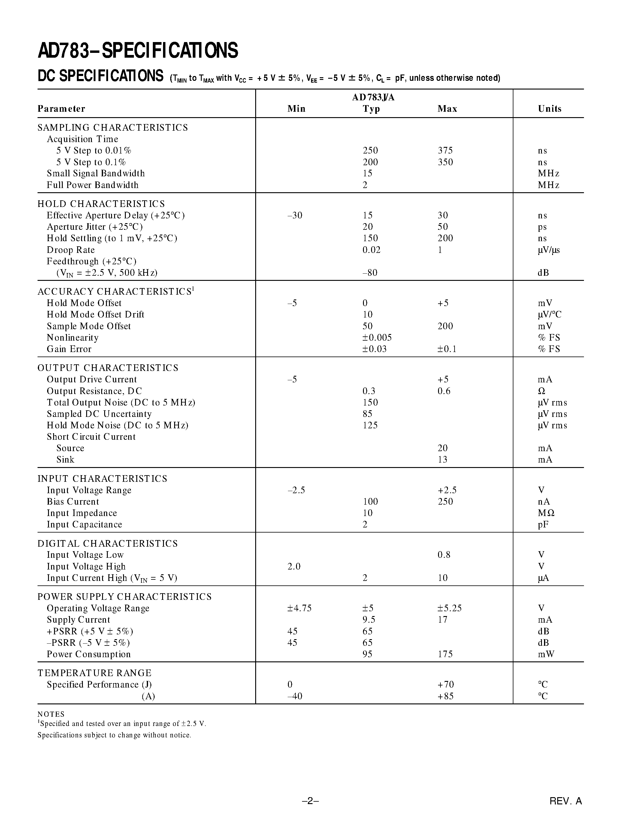

AD783-Complete Very High Speed Sample-and-Hold Amplifier
Producer:Analog Devices
Description:Complete Very High Speed Sample-and-Hold Amplifier
Others with the same file: AD783
Datasheet AD783 - Complete Very High Speed Sample-and-Hold Amplifier page 1
Datasheet AD783 - Complete Very High Speed Sample-and-Hold Amplifier page 2
