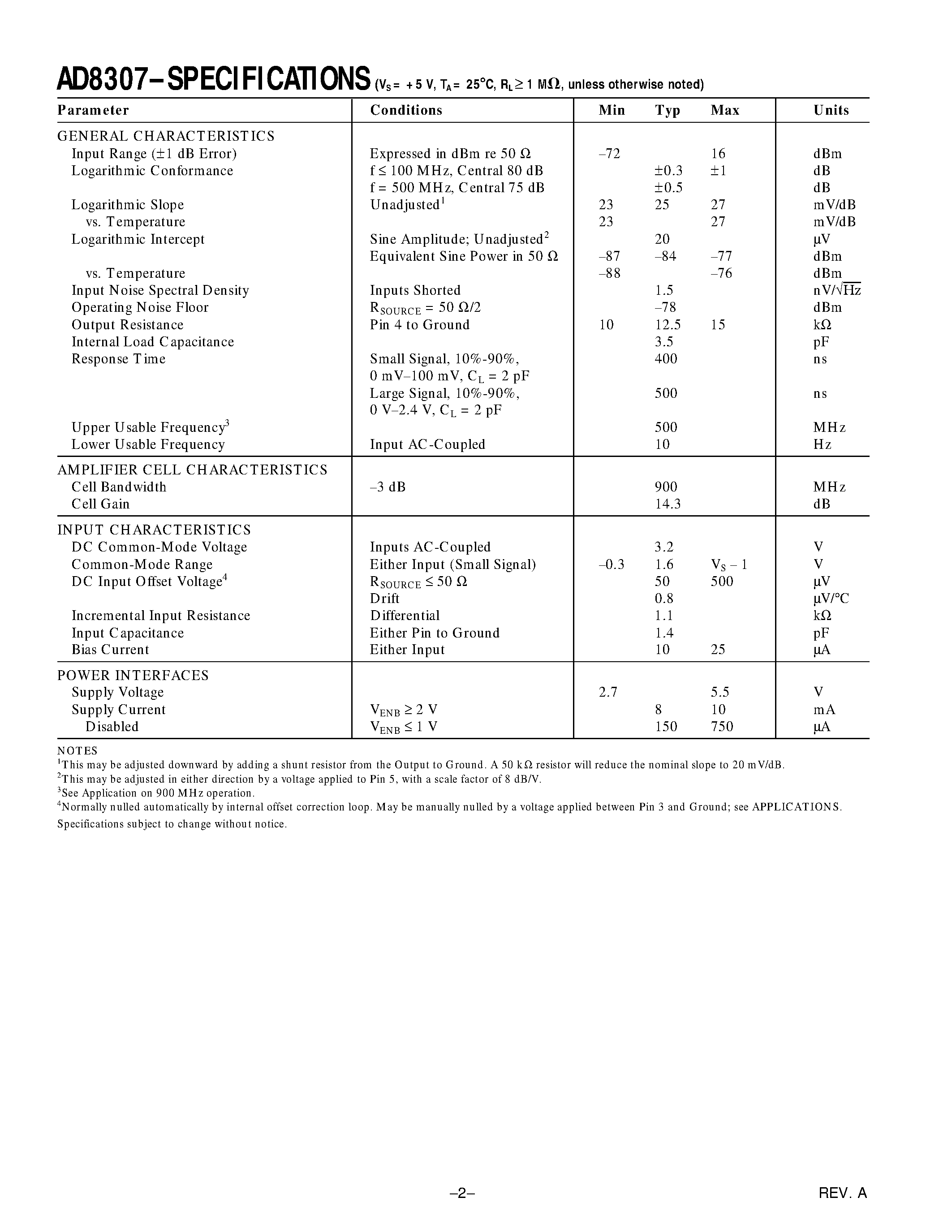

AD8307AN-Low Cost DC-500 MHz/ 92 dB Logarithmic Amplifier
Producer:Analog Devices
Description:Low Cost DC-500 MHz/ 92 dB Logarithmic Amplifier
Others with the same file: AD8307AN
Datasheet AD8307AN - Low Cost DC-500 MHz/ 92 dB Logarithmic Amplifier page 1
Datasheet AD8307AN - Low Cost DC-500 MHz/ 92 dB Logarithmic Amplifier page 2
