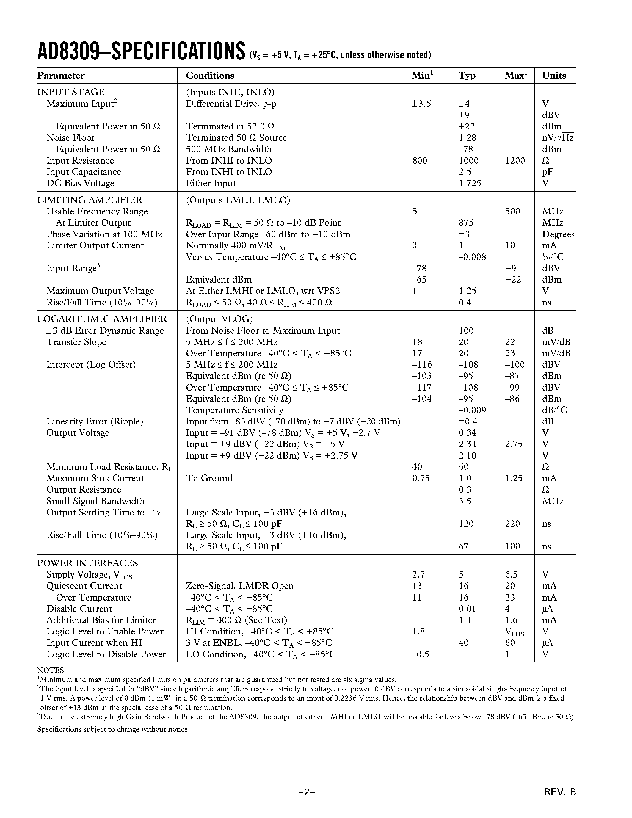

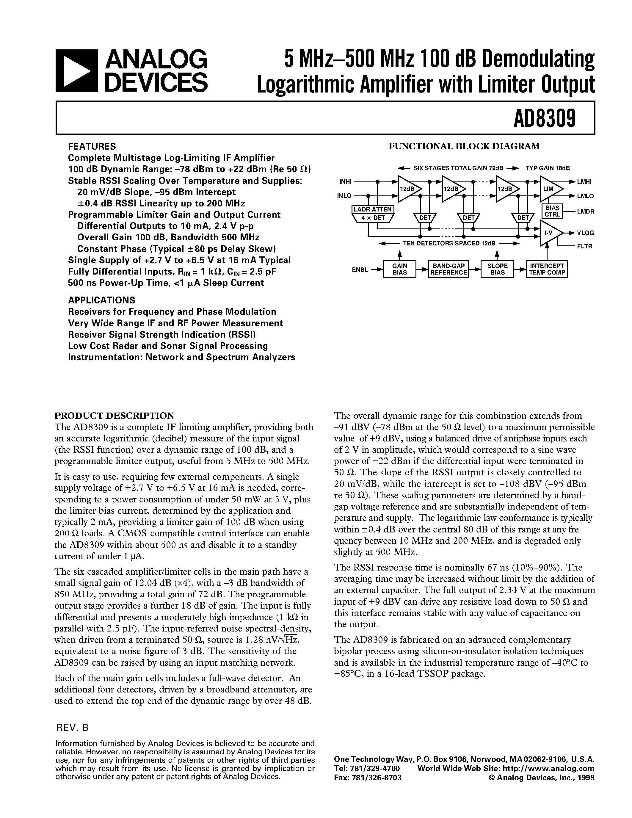

AD8309-EVAL-5 MHz.500 MHz 100 dB Demodulating Logarithmic Amplifier with Limiter Output
Producer:Analog Devices
Description:5 MHz.500 MHz 100 dB Demodulating Logarithmic Amplifier with Limiter Output
Others with the same file: AD8309-EVAL
Datasheet AD8309-EVAL - 5 MHz.500 MHz 100 dB Demodulating Logarithmic Amplifier with Limiter Output page 1
Datasheet AD8309-EVAL - 5 MHz.500 MHz 100 dB Demodulating Logarithmic Amplifier with Limiter Output page 2
