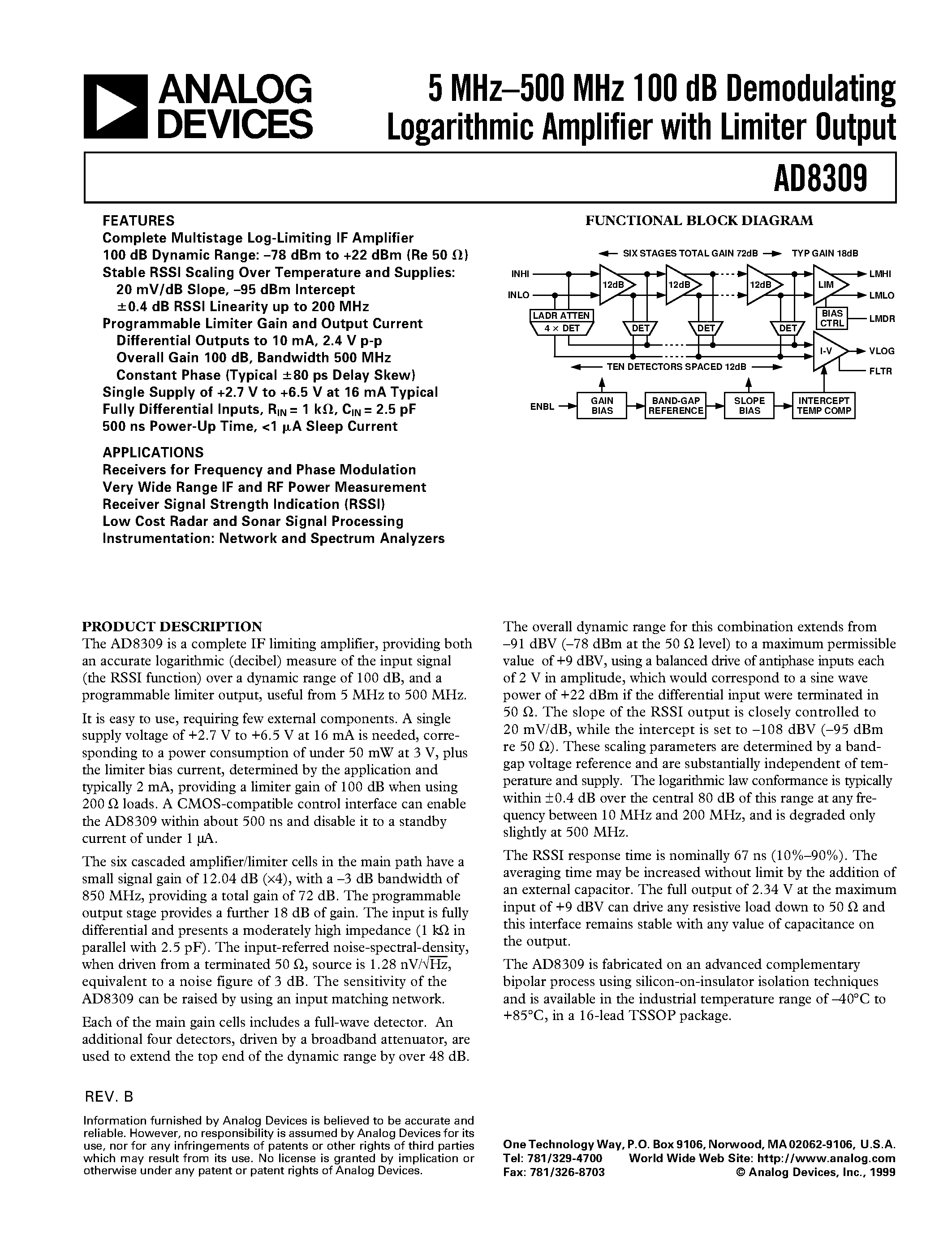

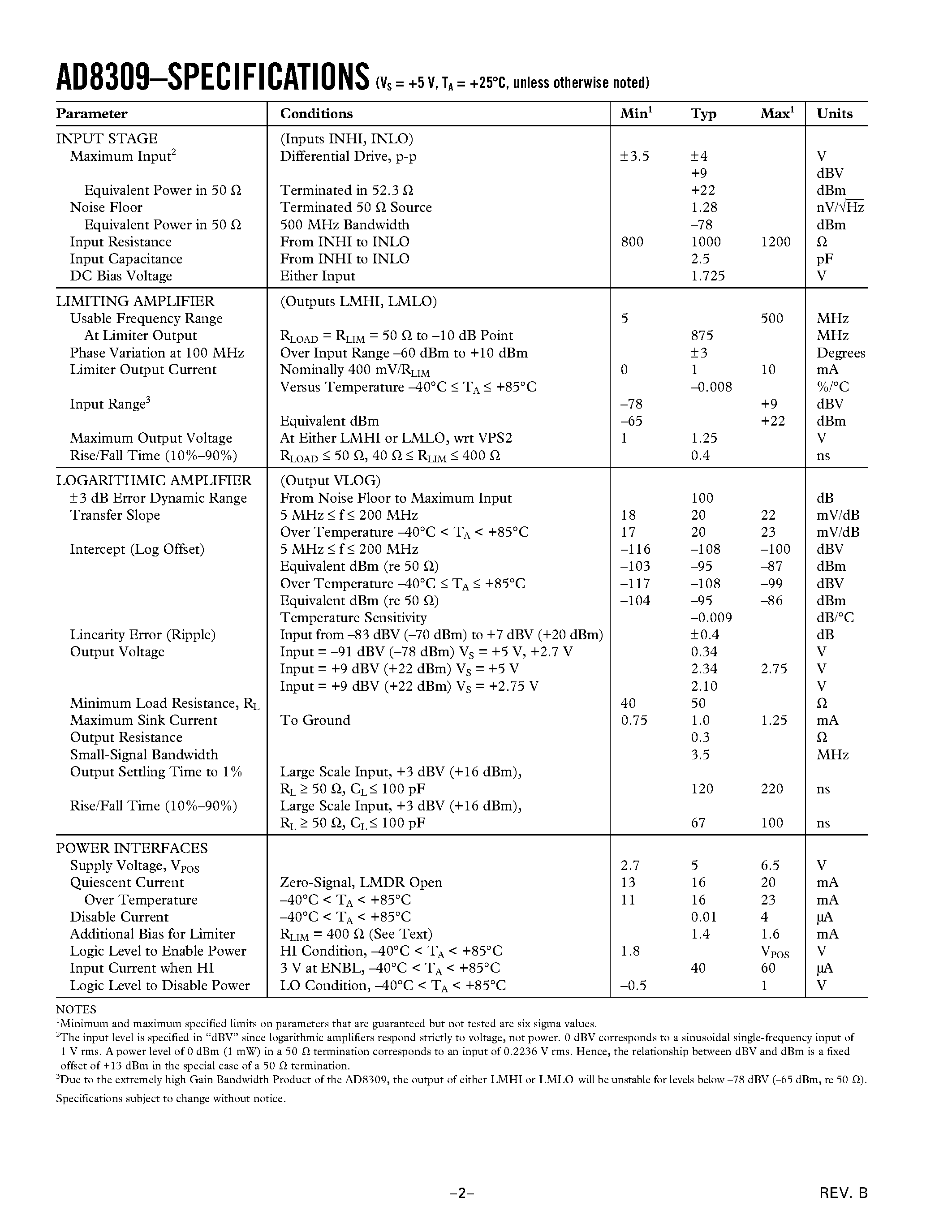

AD8309ARU-5 MHz.500 MHz 100 dB Demodulating Logarithmic Amplifier with Limiter Output
Producer:Analog Devices
Description:5 MHz.500 MHz 100 dB Demodulating Logarithmic Amplifier with Limiter Output
