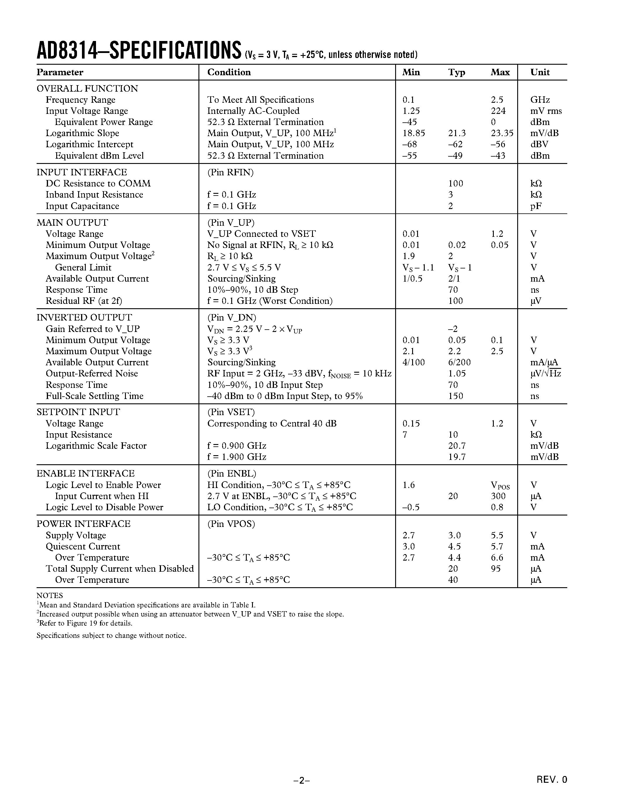

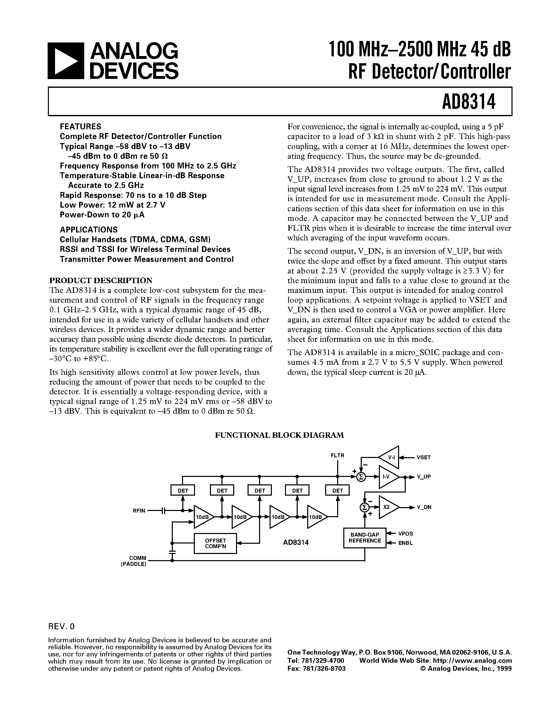

AD8314-100 MHz-2500 MHz 45 dB RF Detector/Controller
Producer:Analog Devices
Description:100 MHz-2500 MHz 45 dB RF Detector/Controller
Others with the same file: AD8314
Datasheet AD8314 - 100 MHz-2500 MHz 45 dB RF Detector/Controller page 1
Datasheet AD8314 - 100 MHz-2500 MHz 45 dB RF Detector/Controller page 2
