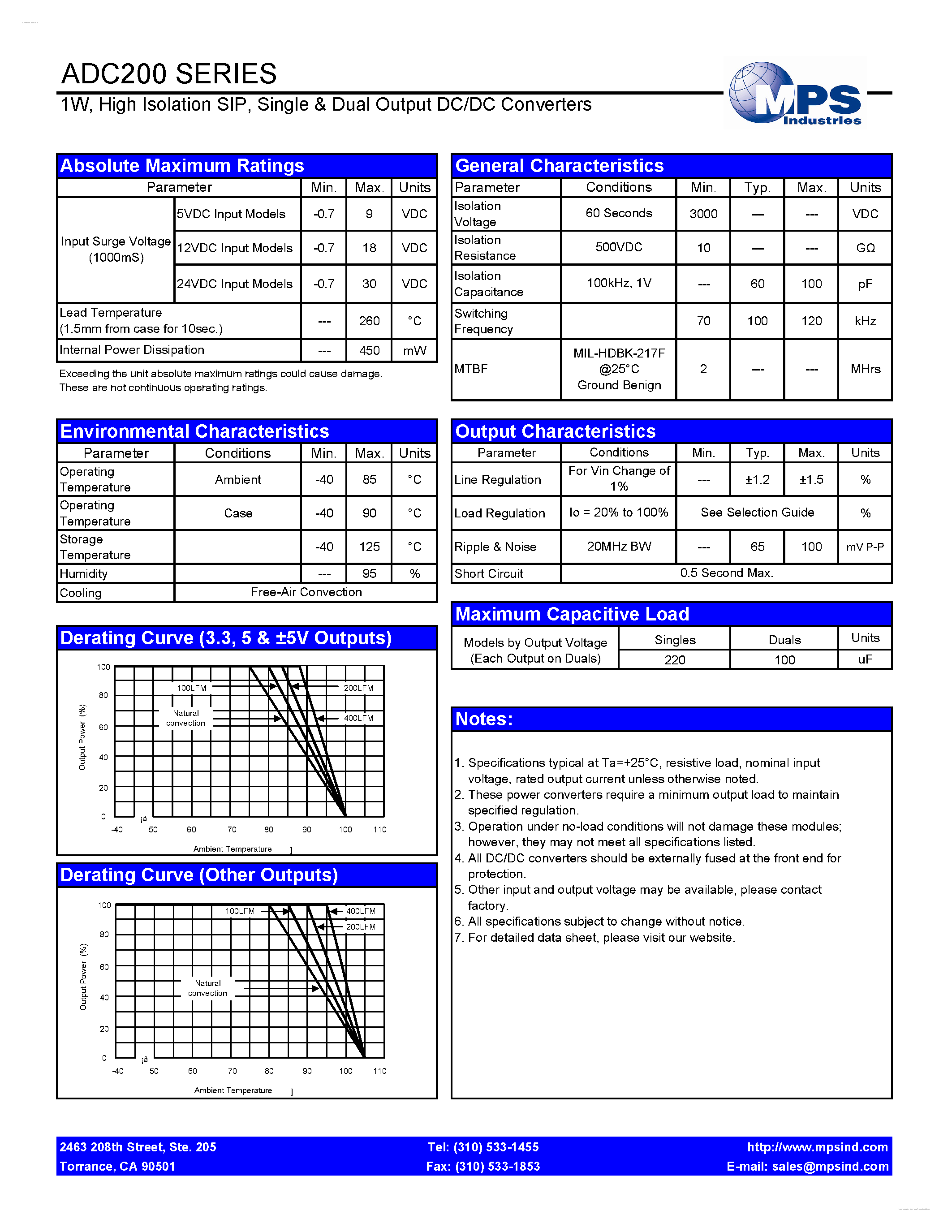

ADC200-Single & Dual Output DC/DC Converters
Producer:MPS Industries
Description:Single & Dual Output DC/DC Converters

Datasheet ADC200 - Single & Dual Output DC/DC Converters page 1

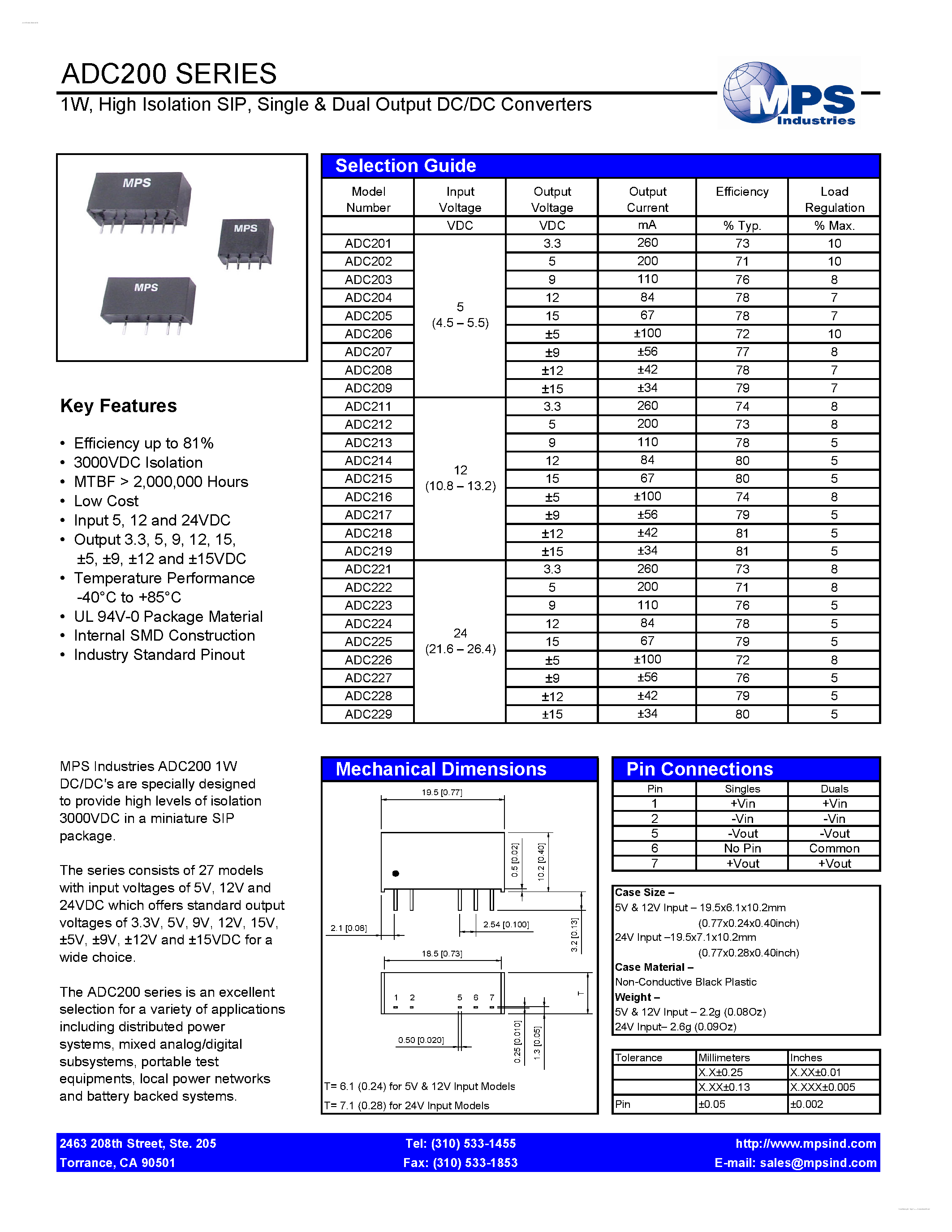

Datasheet ADC200 - Single & Dual Output DC/DC Converters page 2
