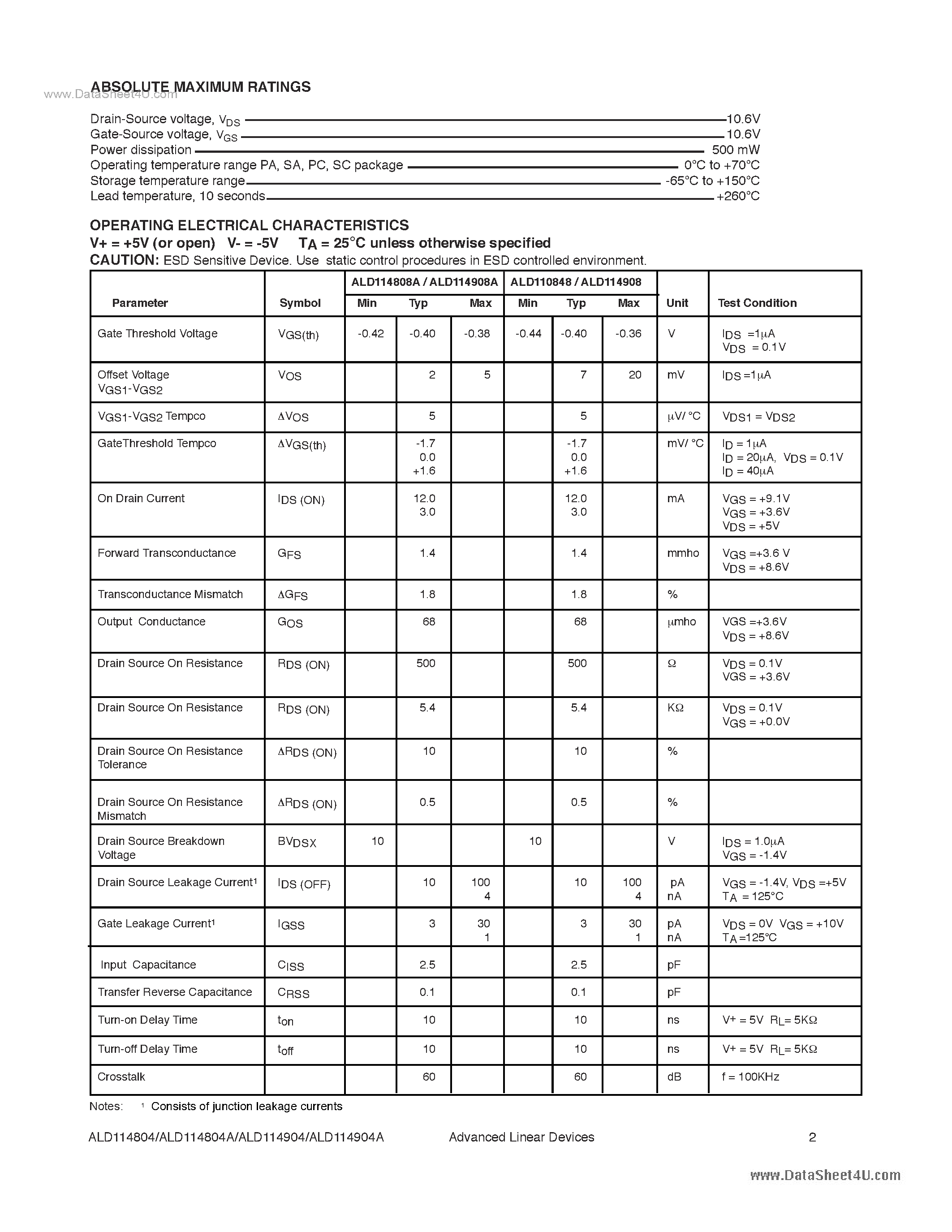

ALD114804-(ALD114804 / ALD114904) QUAD/DUAL N-CHANNEL DEPLETION MODE EPAD MATCHED PAIR MOSFET ARRAY
Producer:Advanced Linear Devices
Description:(ALD114804 / ALD114904) QUAD/DUAL N-CHANNEL DEPLETION MODE EPAD MATCHED PAIR MOSFET ARRAY
