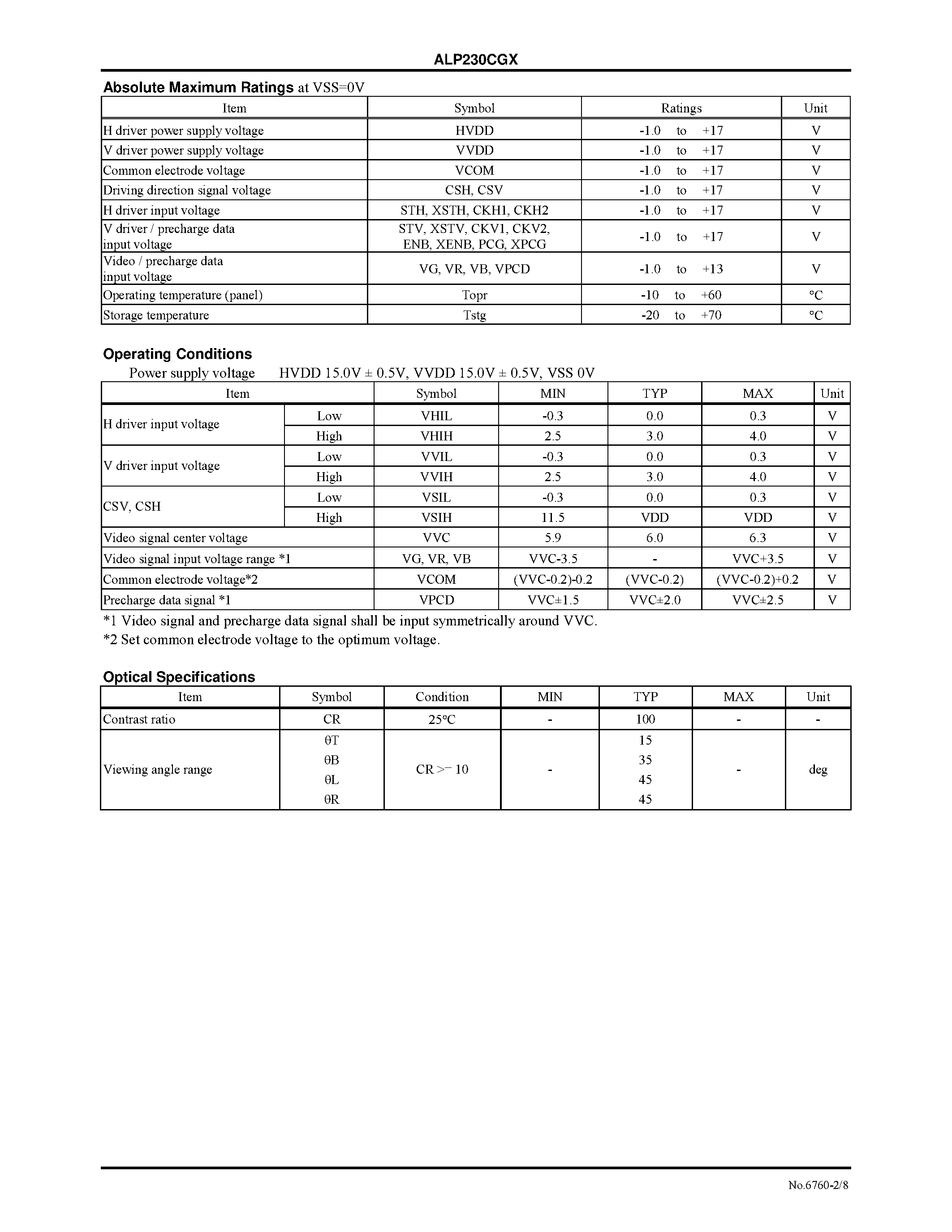

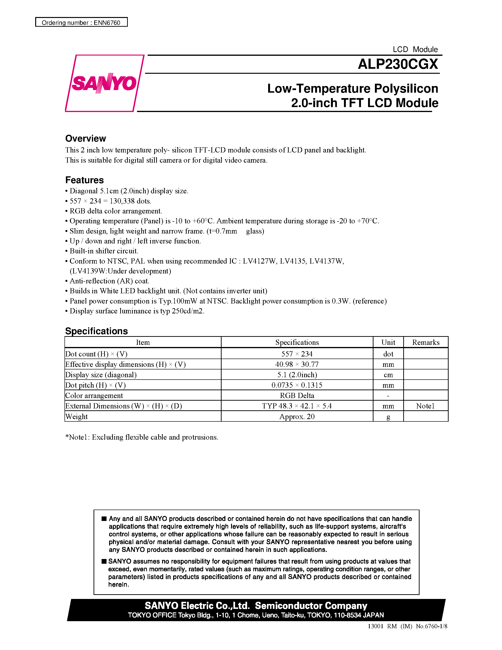

ALP230CGX-Low-Temperature Polysilicon 2.0-inch TFT LCD Module
Producer:Sanyo Semicon Device
Description:Low-Temperature Polysilicon 2.0-inch TFT LCD Module
Others with the same file: ALP230CGX
