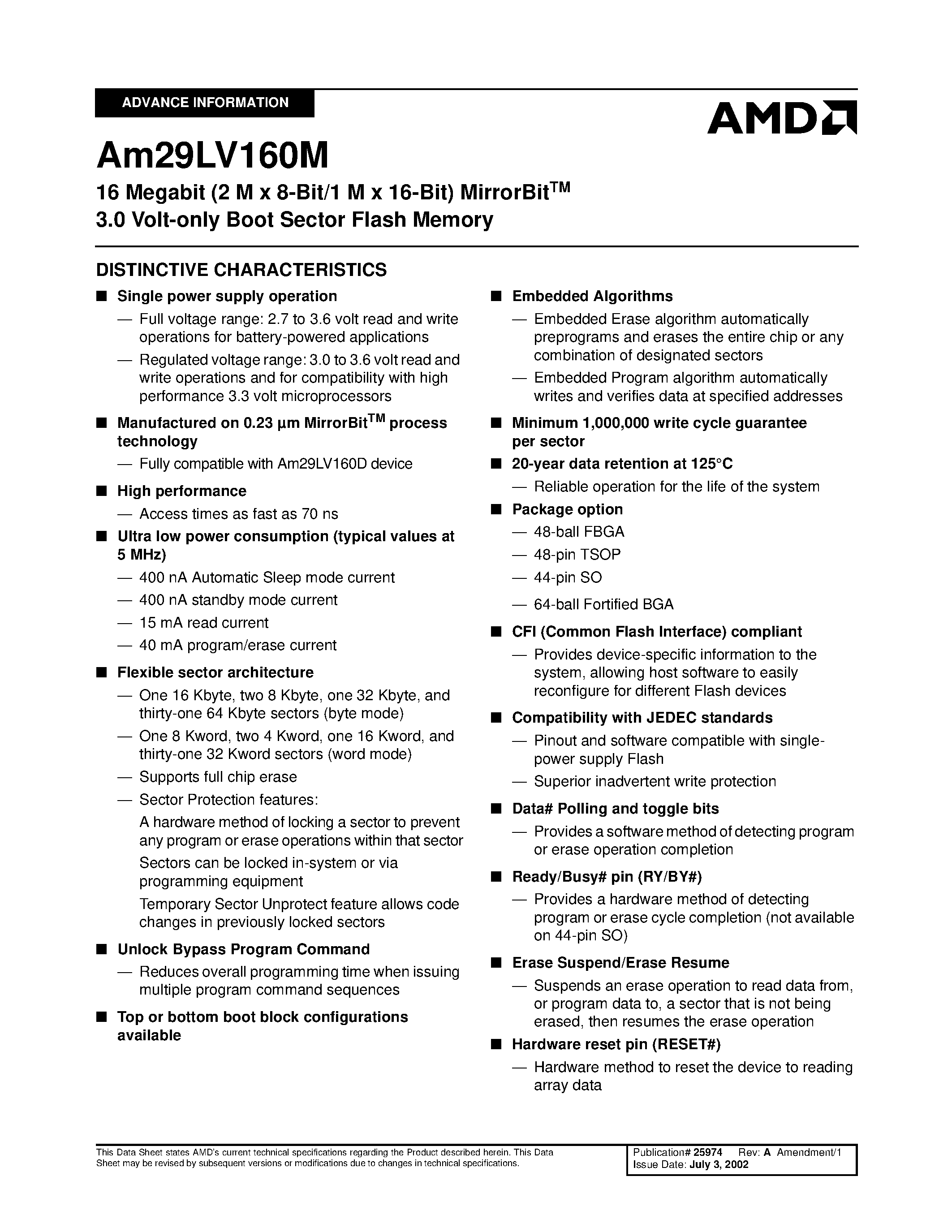

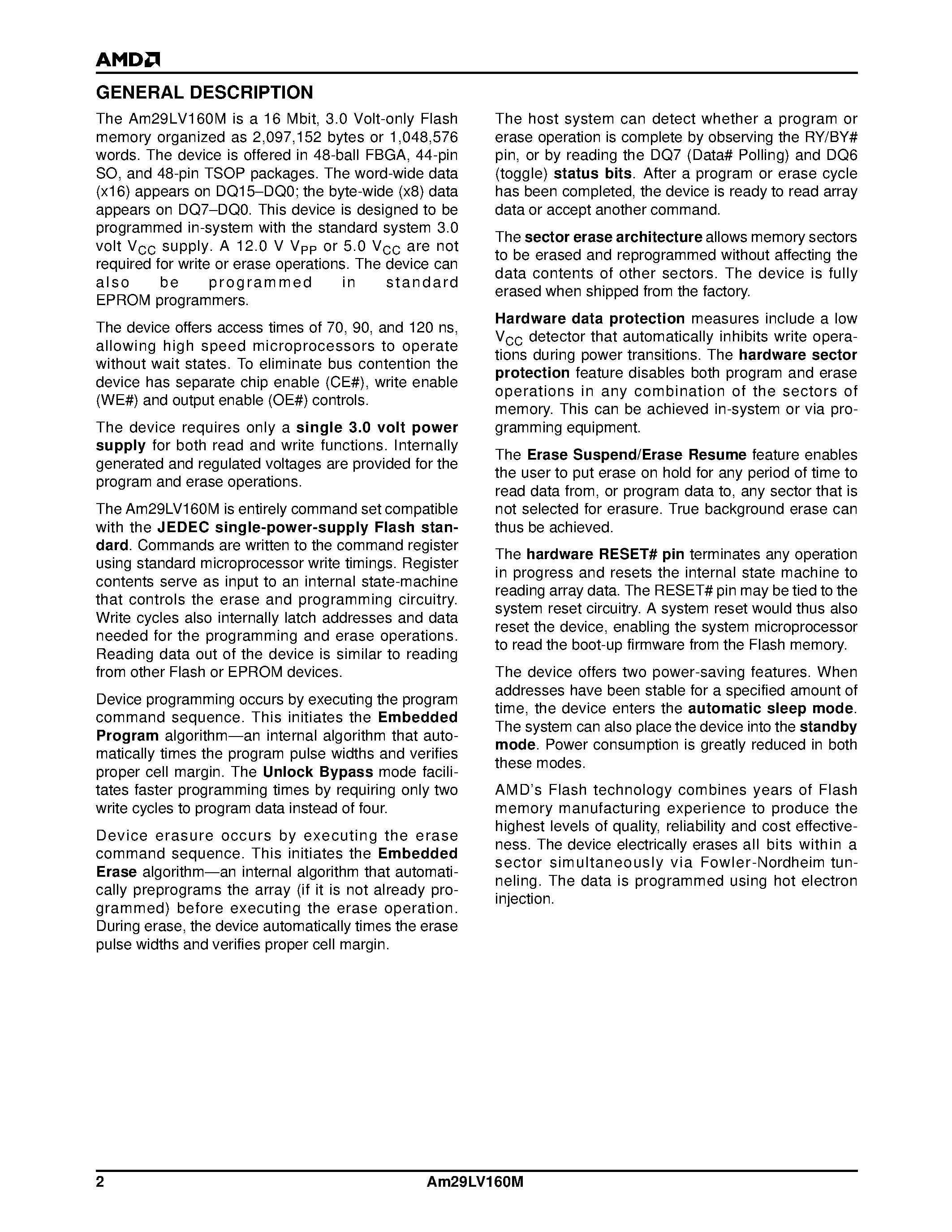

AM29LV160MB100PCI-16 Megabit (2 M x 8-Bit/1 M x 16-Bit) MirrorBit 3.0 Volt-only Boot Sector Flash Memory
Description:16 Megabit (2 M x 8-Bit/1 M x 16-Bit) MirrorBit 3.0 Volt-only Boot Sector Flash Memory
