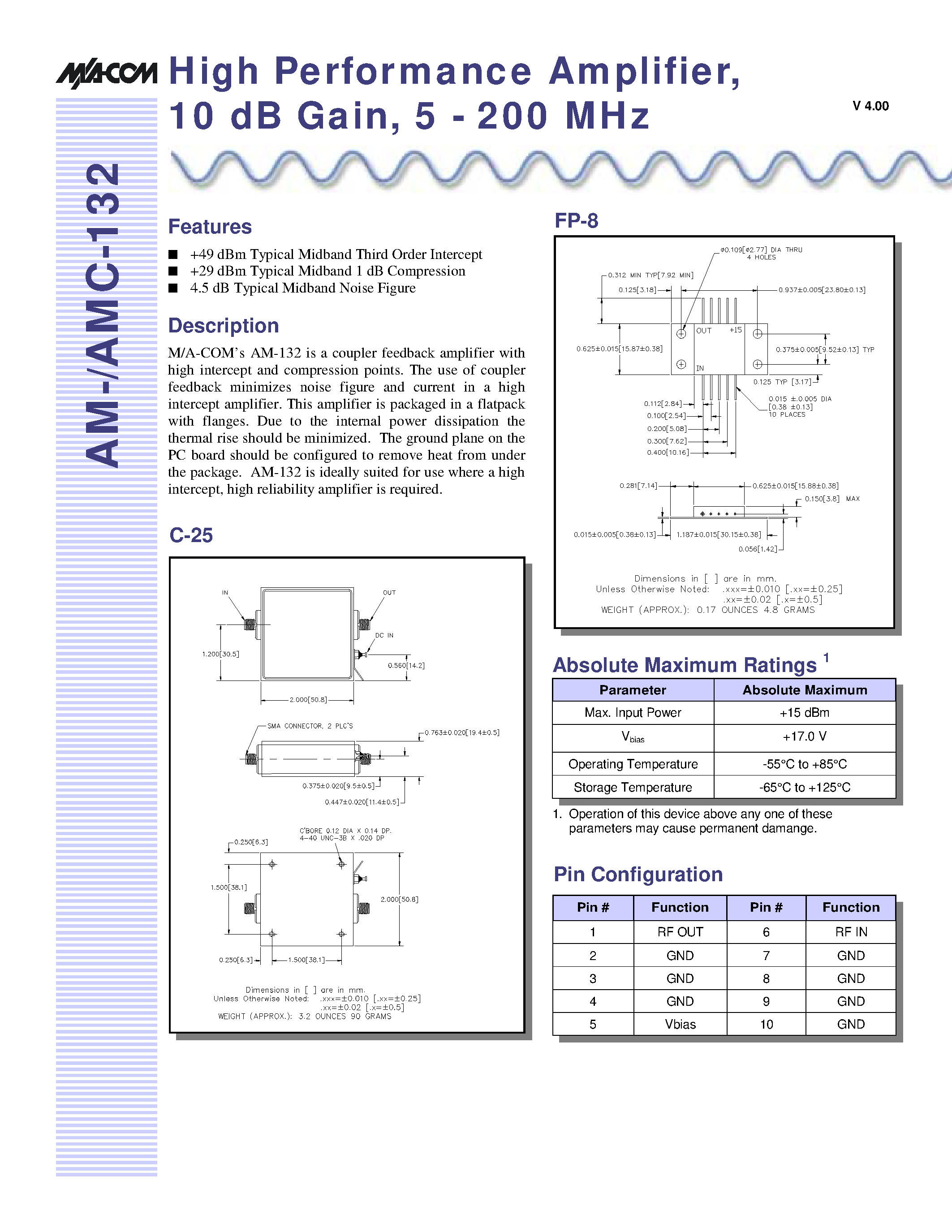

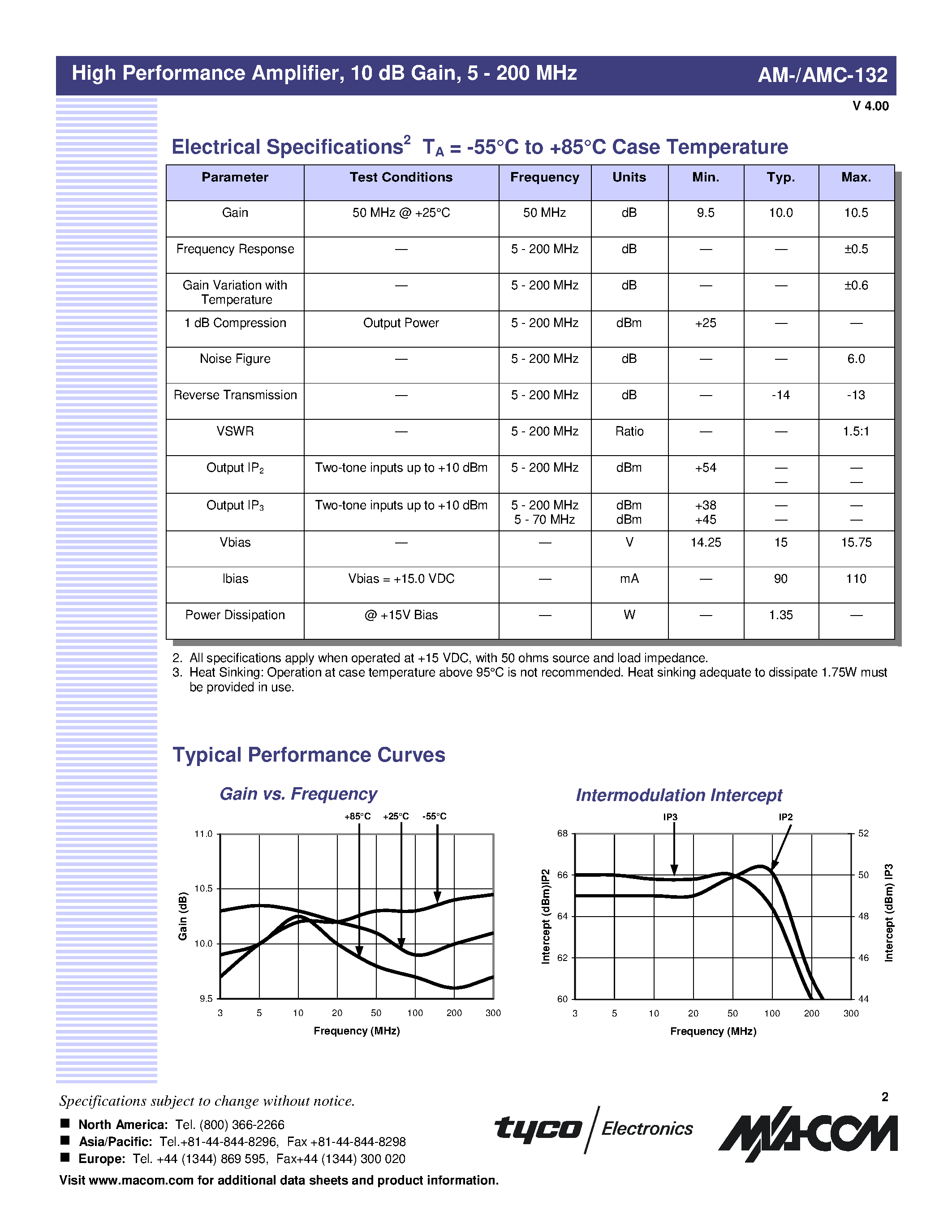

AMC-132SMA-High Performance Amplifier/ 10 dB Gain/ 5 - 200 MHz
Producer:Tyco Electronics
Description:High Performance Amplifier/ 10 dB Gain/ 5 - 200 MHz
