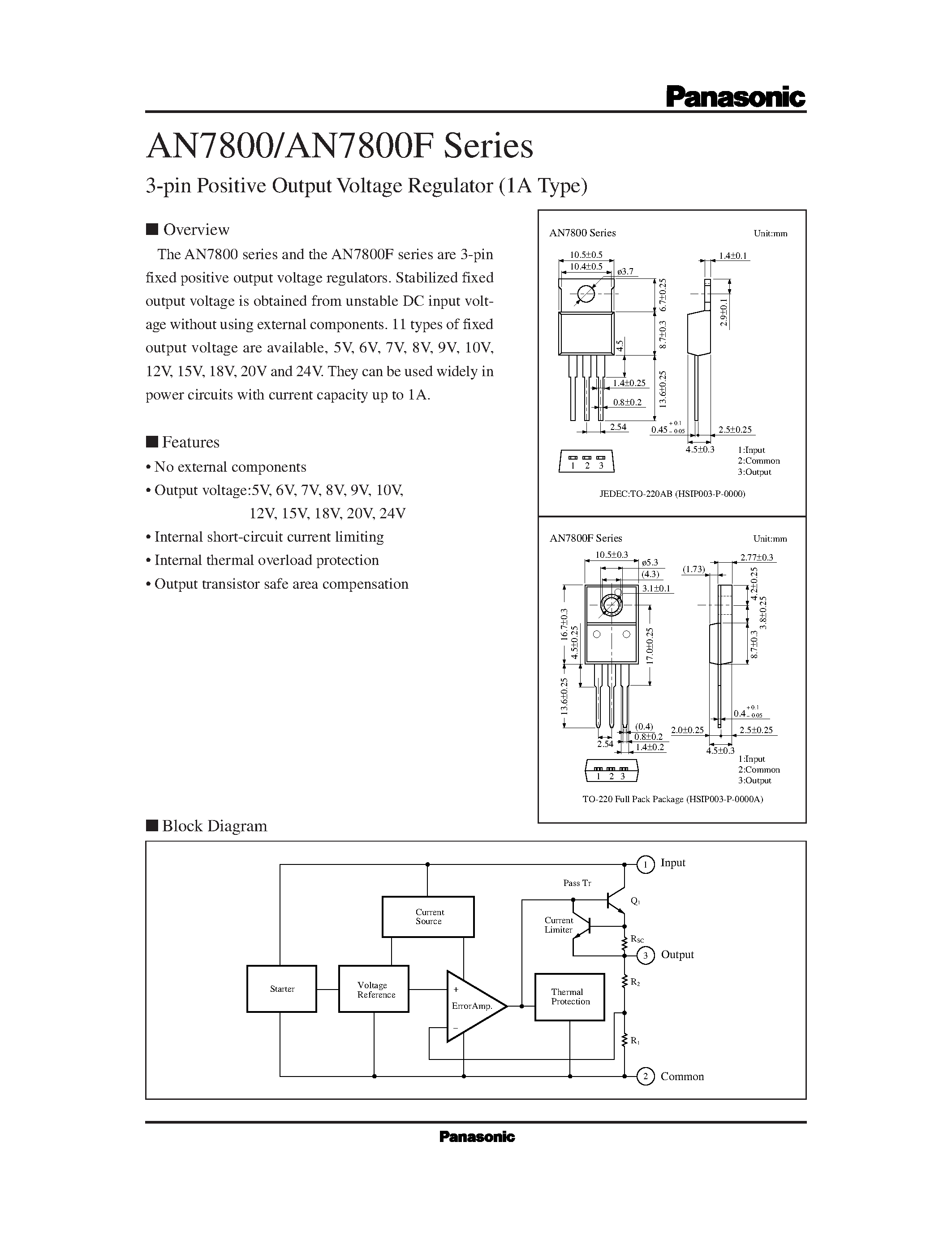

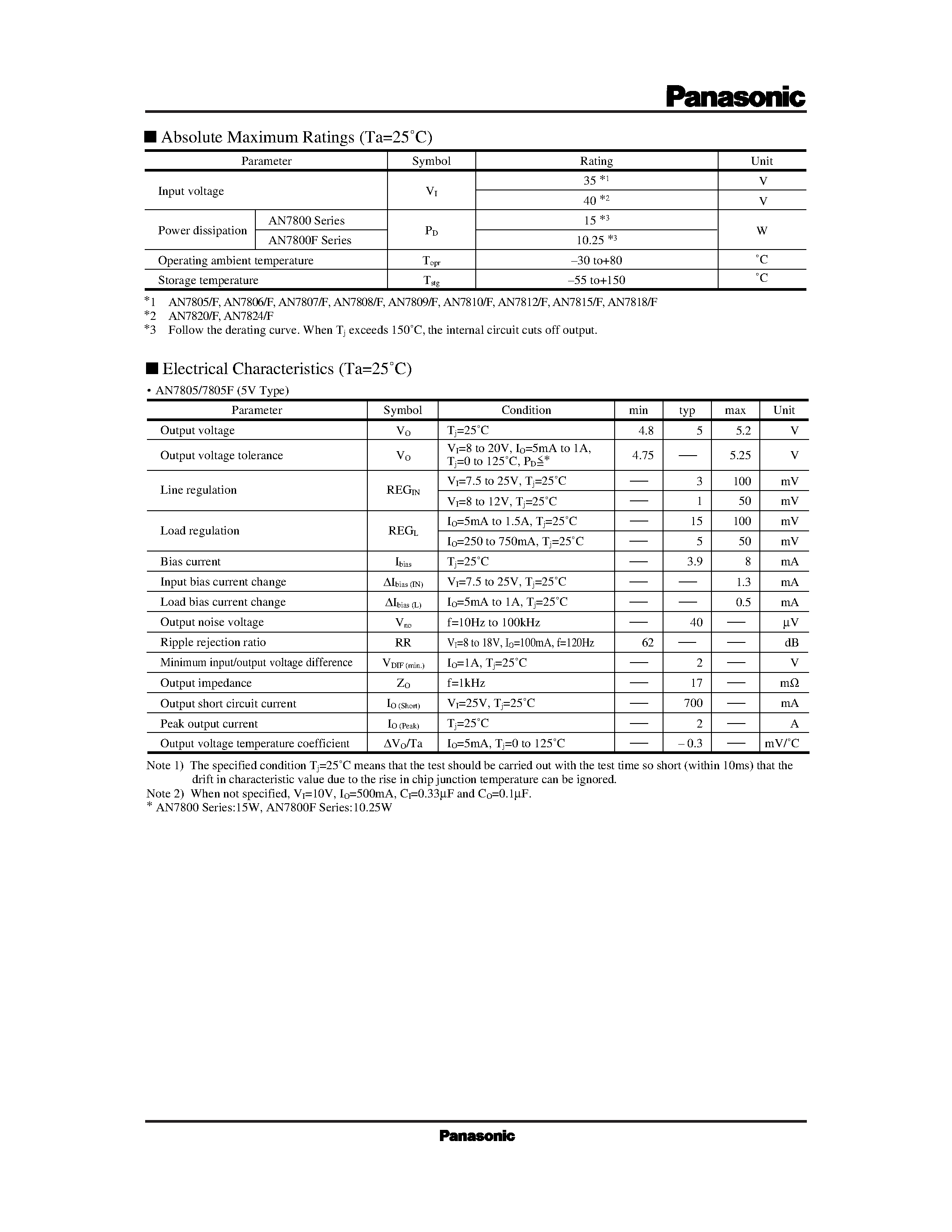

AN7800F-3-pin Positive Output Voltage Regulator 1A Type
Producer:Panasonic Semiconductor
Description:3-pin Positive Output Voltage Regulator 1A Type
